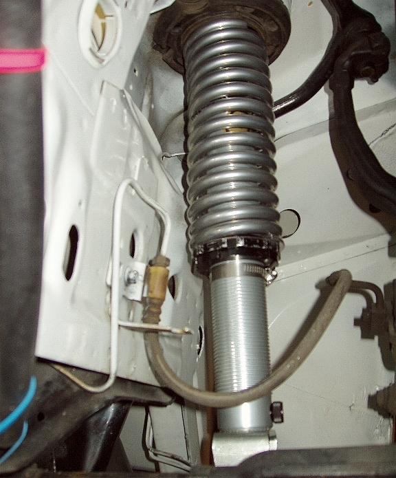

There is your noise problem, if you are using the cheaper kits. I have QA1 on mine, and have never heard a sound from them. The body is threade for the adjuster and spring seat, no sleaves to move.
