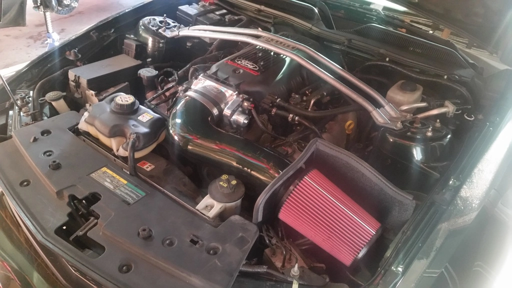

I got my JLT CAI and tune for my 08' Bullitt from Brenspeed as I had also purchased their Detroit Rockers camshafts, Ford Racing Intake and GT 500 T-body and figured that they had done this same build a few hundred times and would have the tune fairly well sorted. I am not disappointed, car fired and idled right off and has excellent throttle response and driveability. Makes real good power. Very happy with the tune and service from them.
