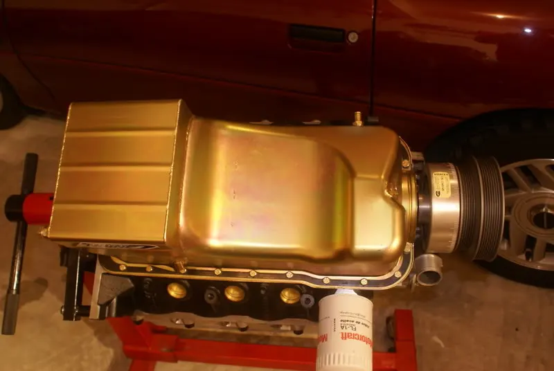

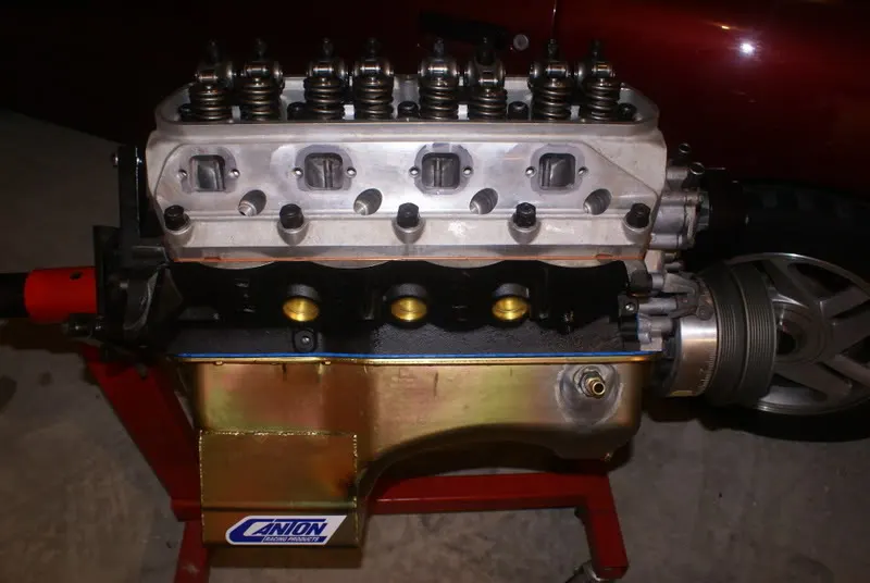

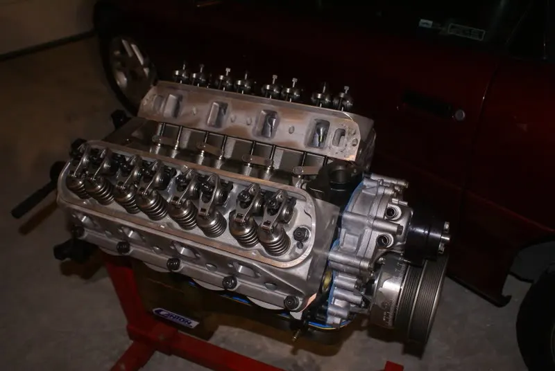

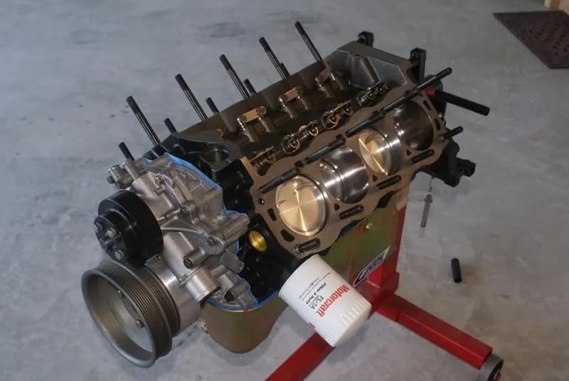

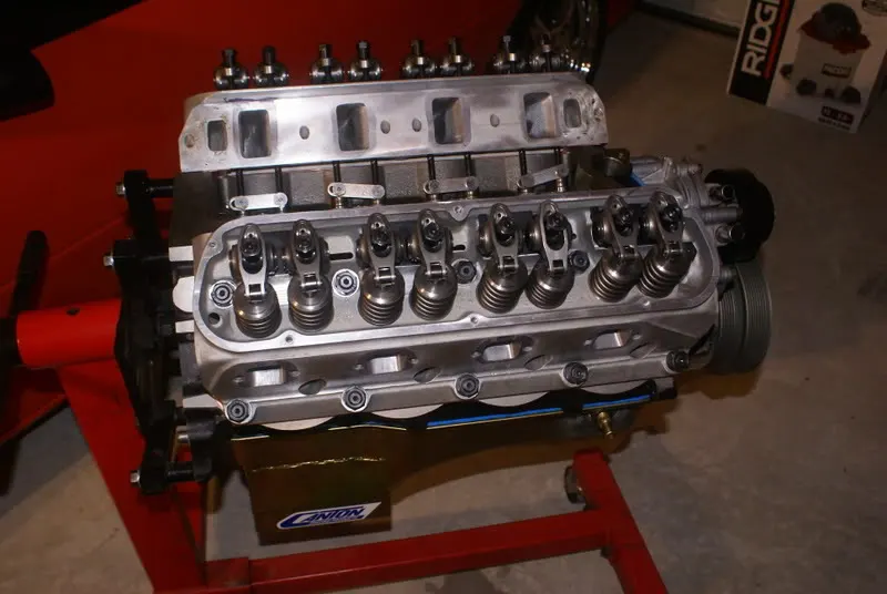

completed long block
took a week to get the valve train 100%
3 days waiting on Smiths Bros pushrods and 2 days for longer ARP rocker studs.
About 6 hrs total doing the valvetrain alone
