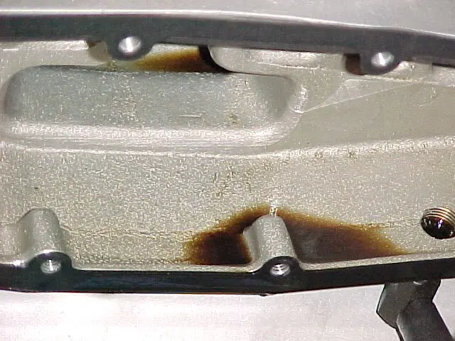

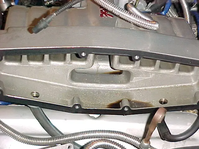

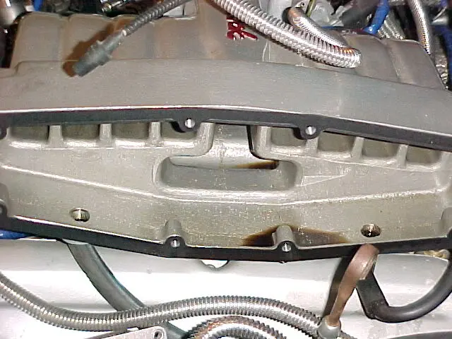

Ok so I did a compression test today because I have oil in the intake manifold and I wanted to rule out piston rings, head gaskets, and valves. Here's a pic of the average amount of oil in the intake...
Does this look like a normal amount for a 331?

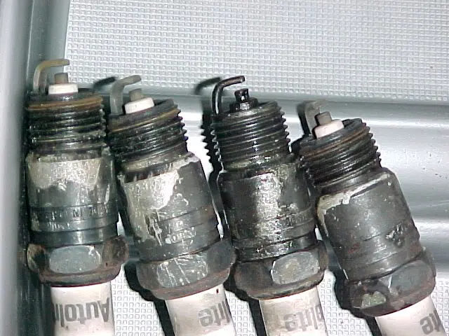

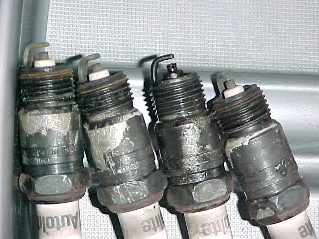

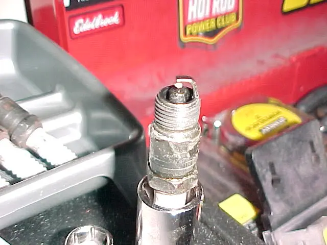

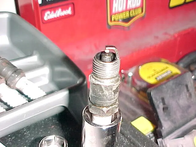

But take a look at my number three spark plug...(left to right: #1,#2,#3,#4)

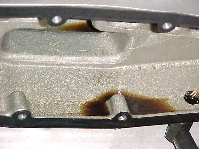

And #3 by itself...
#3 was the only one with oil deposits. What could cause only this plug to get that way.

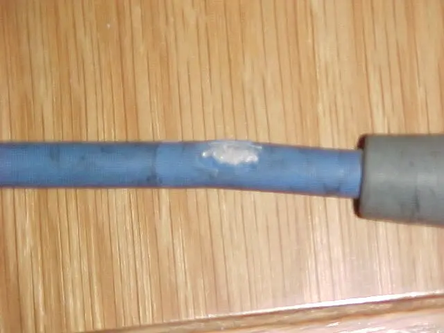

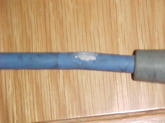

One small thing I should mention even though I doubt it's related, the #3 plug wire must have been resting on the header and a small portion of the outer casing melted. It's not bad at all, it didn't even melt the nylon fibers inside. Here's a pic...

i think our cars can tend to suck oil thru the pvc valve into the intake. how much is normal? :shrug:

Okay good to hear about the oil in the intake, I guess I need to start to piece together an oil seperator or maybe get the turbo coupe pcv, or both.

Did you OHM that wire??? That plug and your compression test dont seem to go together....Plug looks fouled or something....I'd replace it and take a run and see if it comes back?? Its not fuel on the plug??
I pulled my Cobra upper and had that same oil....least your intake has nice places for it puddle... :D I got a Steeda oil separator coming...Im curious to see just how much mines getting...

It is curious that the wire being marred and the plug being fouled are both #3. How about changing the plug and wire? Maybe the wire is arcing to the header and you aren't getting any spark.
Maybe you have some blowby on just that one cylinder? But one would think the compression test would show something ...

I can't say for certain, but it looks like 2-->1/4"npt x 1/4"tube fittings and a generic oil separator that you should be able to find at most hardware stores or the local Tractor Supply Co. And a few extra feet of hose.
I had 150compression on all 8 cylinders on my car with blow by. My issue was like yours oil on some plug, I had oil puddling up on the intake valve, oil in the intake. So I pulled the shortblock apart and come to find out had some worn out rings. Couldn't believe it. Great compression still bad rings.. Answer me that one...

I bought 3' of 3/8 heater hose, 2 3/8 npt fittings and the oil seperator. You can get everything at walmart. I also used the 2.3 turbo pcv valve. You'll want to mount it over like I did to keep it away from the high temps. Any more questions just let me know. I got everything for under $20 and it only took me about 20 mins. or so to hook it all up. Very easy!

i think you may still want to look into your car more. Oil deposits are bad on plugs. You may be getting 150 still because you are doing a wet compression test and dont even know it. the rings may be messed up and the oil is sealing the rest.
