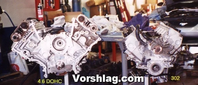

How much do two extra cams, bearings,followers, and associated hardware weigh? 20-30 pounds? The cams, bearings, and mounts could make the difference.
Looked up a few things on www.vorshlag.com ...
A stripped iron 5.0 block weighs 129 lbs.
A stripped aluminum 4.6 block weighs 91 lbs.
A complete DOHC 4.6L head weighs 60 lbs.
A complete iron 5.0L head weighs 49 lbs.
A complete aluminum TFS Streat Heat head weighs 30.5 lbs.
They didn't have weights for the SOHC motors so I used the iron 5.0 for comparison. It looks like the DOHC heads are some some BIG heavy mofos.
I can't find where I stored the info, but I believe that the 4.6 iron block weighs approximately 140 - 145 lb.
