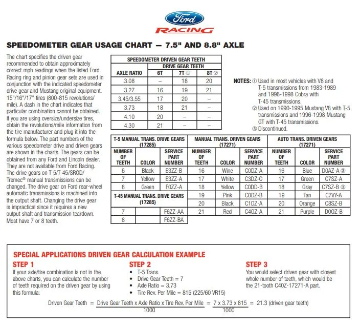

Like stated above you'll need to see what the count is on your drive gear then go from there.
