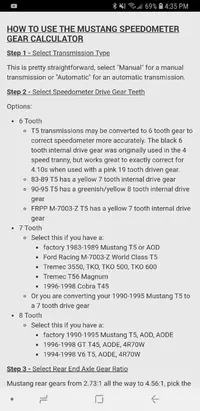

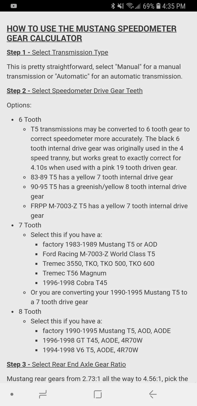

gonna switch to 3.73....what's my tooth size?....all that mumbo jumbo has confused me

Yea, I got a head ache when I tried to figure that out when I went to 355's, I found a conversion chart that took tire height and gear ratio and trans type and gave me a tooth count for speedometer gear, I ended up with a black gear.
tire rack got me the tire measurement,
This may help http://www.tciauto.com/tc/speedometer-gear-calculator/

As for speedo gear, shine a flashlight up the speedo hole in the trans and look for color
Green = 8 tooth
Yellow = 7 tooth
Black = 6 tooth
