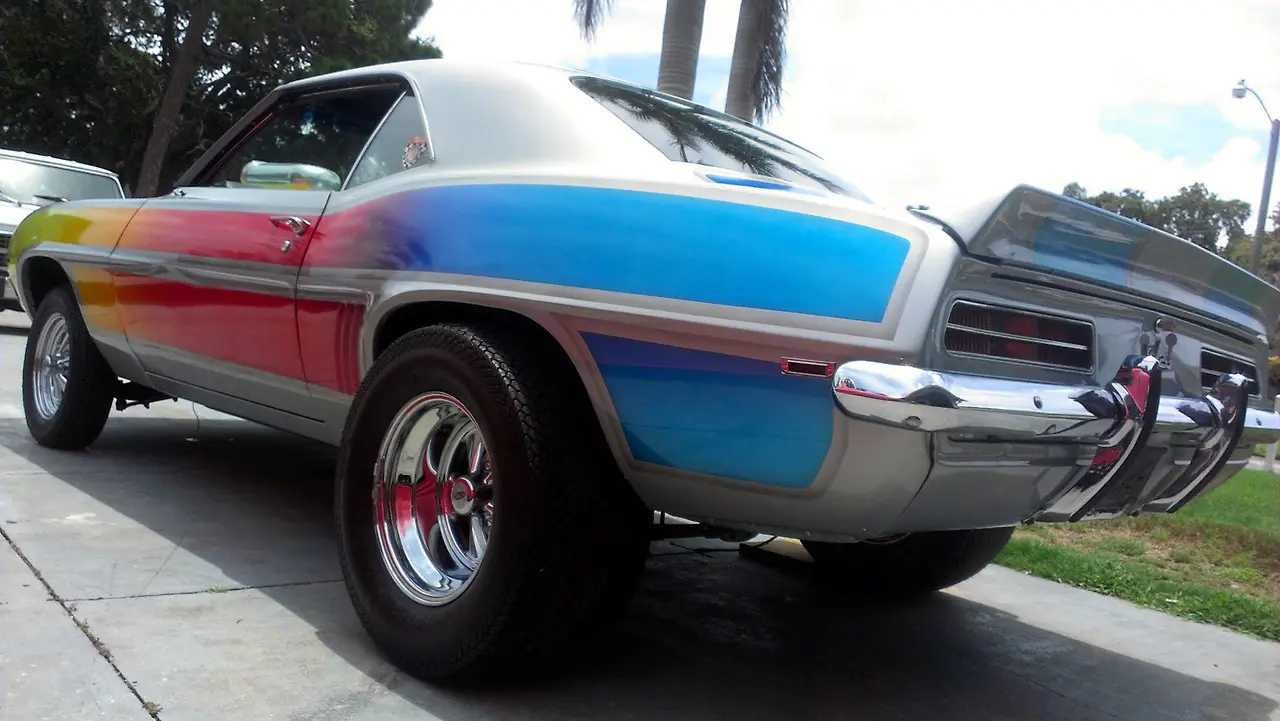

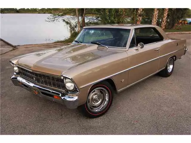

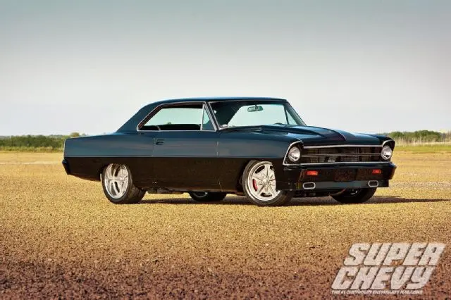

That reminds me of the biggest limitation of my favorite non-fords. I've always loved this GM body.
This little car is so freakin' plain. Boring lines, boring interior, the thing screams econo box. You can't even get a 9" slick on these things w/o moving the leaf spring hangers inboard.
But,....Once you do that...then the car turns into a monster of it's own...
Kinda reminds me of a certain Orange car..... Thinkin' wheels like these are in it's future.
You gotta mini tub most any car when you wanna put a big tire on. I have 315's on the Monster, and everything fits under the car. I'd rather go under a car before I'd cut a fender or add a flare..Flares died in the 70's when there wasn't anybody making axles for the rears, and the only thing that you could do was push the wheels out.
