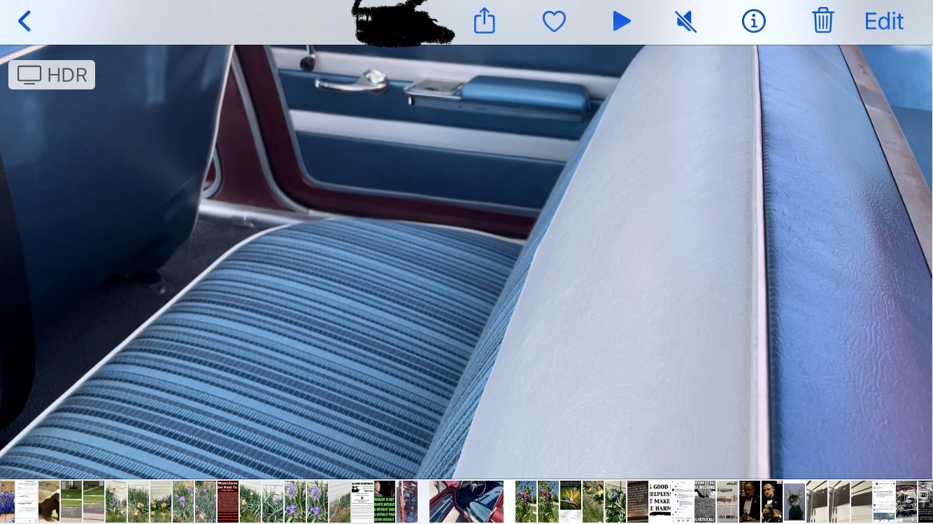

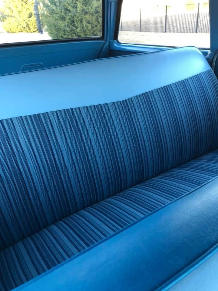

The interior is blue. More blue than I wanted. But no more light gray velour seat inserts!
The gray, silver and blue grays I wanted to use were out and availability undetermined, so I went with a combo that was close to what was available on the blue cars. If it had been ordered when I started, it would have been close to stock. The factory red was way too much, and the green would have been Christmas all year.

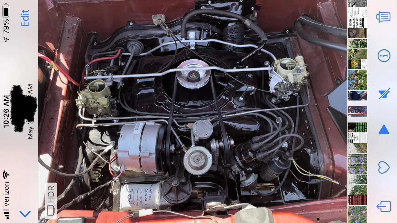

The headliner turned out great and the engine runs great. With oversized, stock style exhaust, cruising will be pleasant. The sound of the engine will have to wait for a vid clip post.

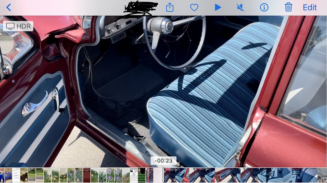

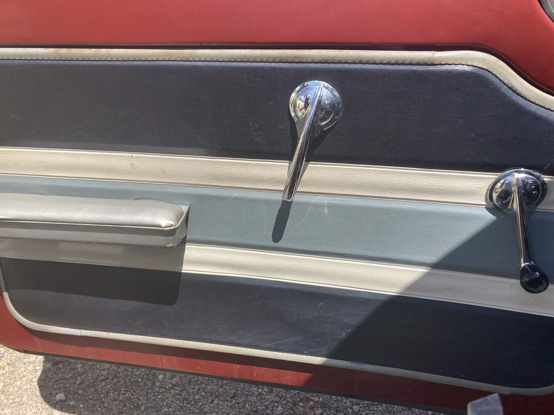

The first pic is of the driver’s door before. The original headliner was a gray weave that was falling apart and I replaced with a white vinyl headliner in the 80’s. The seats were a silver gray like the armrest cover, with the white top band, and the first owner had replaced the cloth pattern seat inserts with velour. The bottom cushion looked fine, but was not supportive after this long.

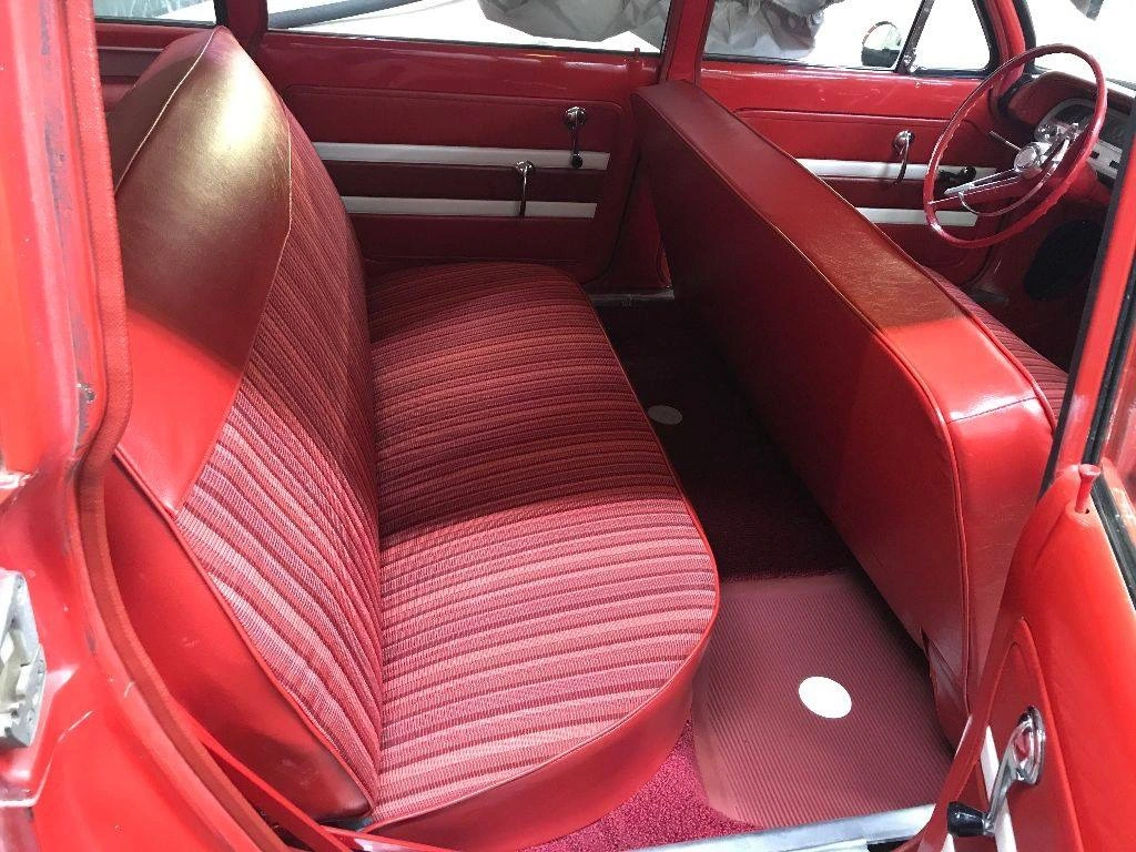

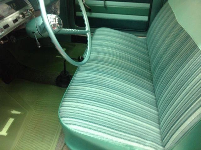

Here are other options since the black rubber carpet and grays were not available.
I could have gone with the Monza level trim and got vinyl on the bench and blander door cards. (Not pictured) with the 700 trim and emblems, I did not like that.

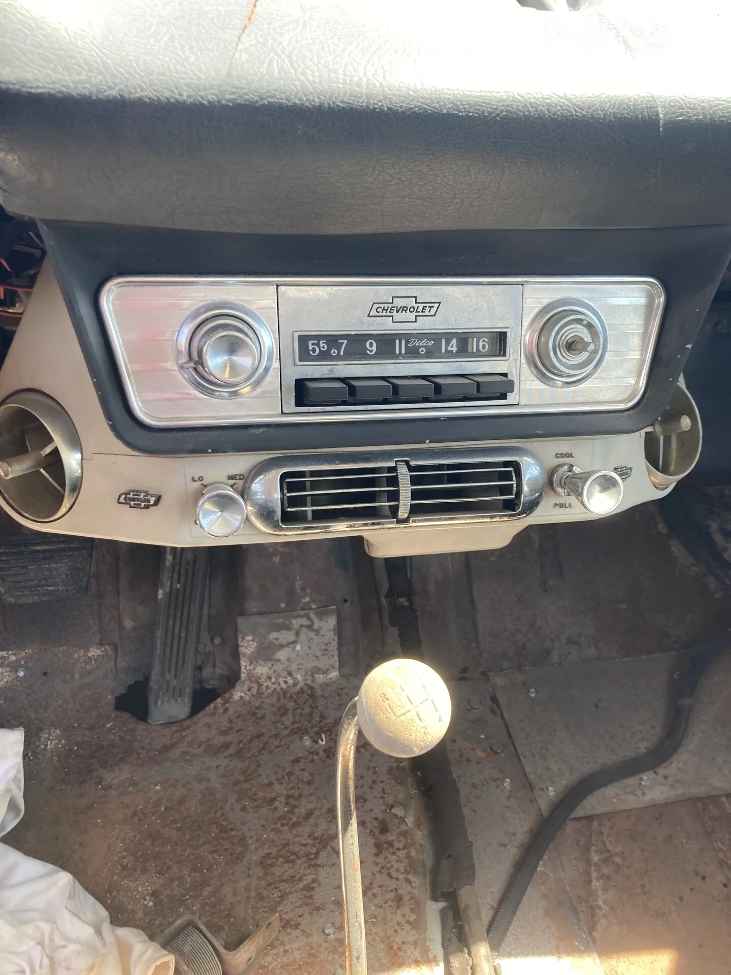

The add on AC works great, but does not have the look I want. The small, center vent below the radio pod needs replaced with a factory AC thing like the white part in this pic of another car in the lot.
Then I can put the gauges under it. (I have a powerglide with a lever on the dash instead of a stick through the floor.)
The big bore, stock style duals sound so much better than cheap turbo mufflers on a flat six.
When I get it back, I will still need to install the Custom Autosound Radio, dual speaker in the dash, and either the 6x9 boxes I have ready, or make a sub and 6x9 box for the deck. But it could be driven home now.
The electronic ignition I wanted to use, (Stinger Ignition), was ordered before I needed AC, and does not fit as is. It’s too tall, and the vac advance is at least very close to the AC belt.
I can either live with points, use a Pertronix conversion in the stock distributor, or spend another $200 on high lift AC brackets that might work with the Stinger HEI. I have pics now and can consult with the ignition system’s designer.

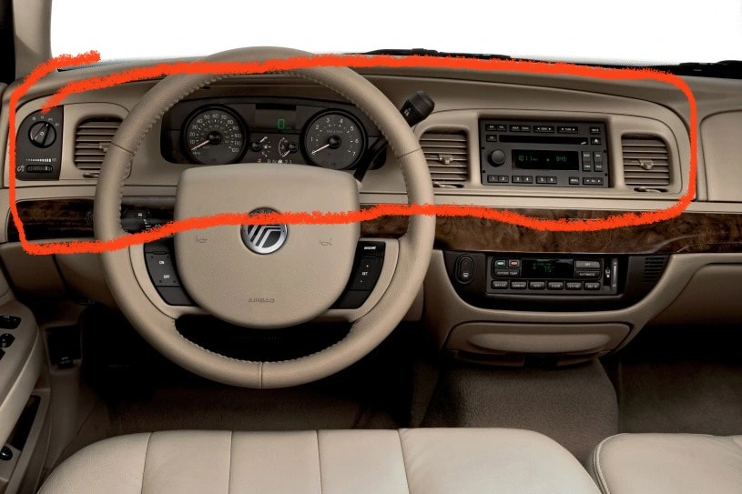

Today, the 2005 Grand Marquis got a new Motorcraft headlight switch. The dimmer (rheostat) and dome light click had not been working quite right for some time. So when Junior told me the dash back lights were not working, we had the part on hand.
We checked fuses, then figured out how to get the dash apart. There was nothing very helpful for the model year on YouTube. The videos showed the dash already pulled apart, or one guy was pulling the switch with letter openers where there was not enough room to do so without damaging the trim. :eek: So I went in blind on how to pull it apart, and went a little too far.
(The pics are Not our car, but the colors are right and it’s a good picture.)
The wood grain trim is held on with metal spring clips. My mini pry bar (for baseboard and window woodwork) with tape on it worked slick to pull the green circled areas
Then bottom screws for the piece that goes from the headlight switch to the AC vent right of the radio are exposed, (circled in Orange in pic 2). There are at least 4, 8mm head screws in the bottom, and two pointing up, above the speedometer.
The plastic and metal pieces under the steering wheel do not need to come off. It made running the microphone for the Bluetooth speakerphone radio a lot easier.

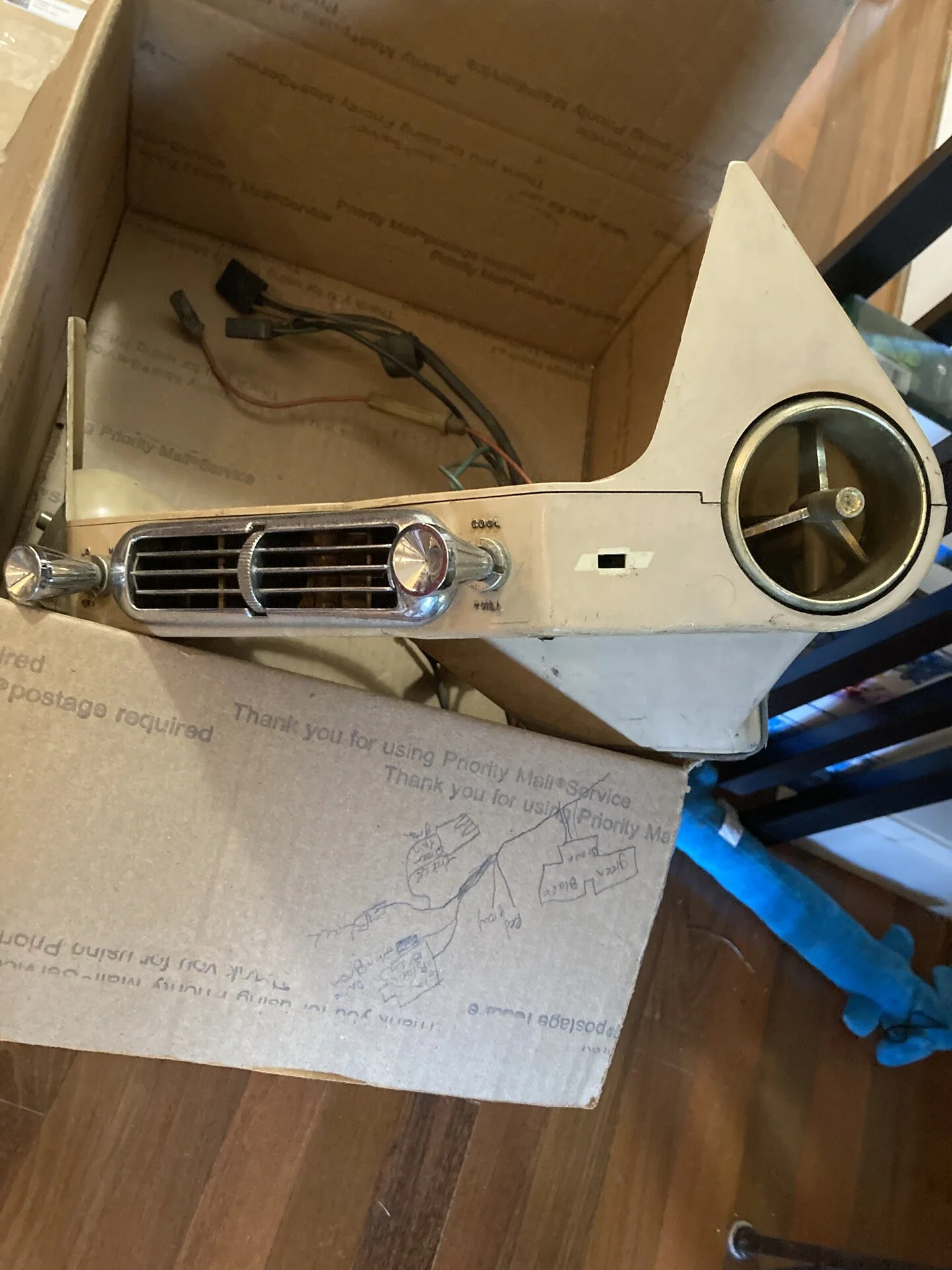

The other news today is I have a vintage AC surround for my Corvair that should clean up well. Out of a group of 16k other Corvair nuts in a FB group, I got ONE response from someone who had a extra for me. I should have looked closer at the pics, as the little Chevy emblems are missing. But otherwise, it is complete and looks great for a 59? year old part. The plastic is now tan, (lighter where the emblems were), so I will spray it a color that will coordinate, or probably a coat of white. (77 Ford Granada silver metallic is what the radio pod was painted. That matches the the rest of the silver on the dash and on my Olds dash.)
White would look like an add on, and might be what this was. I’ll pick the color when I get the car back. But I can clean it a little,, remove the wiring, replace the felt in the ball sockets so it’s ready to adapt to the new AC system.

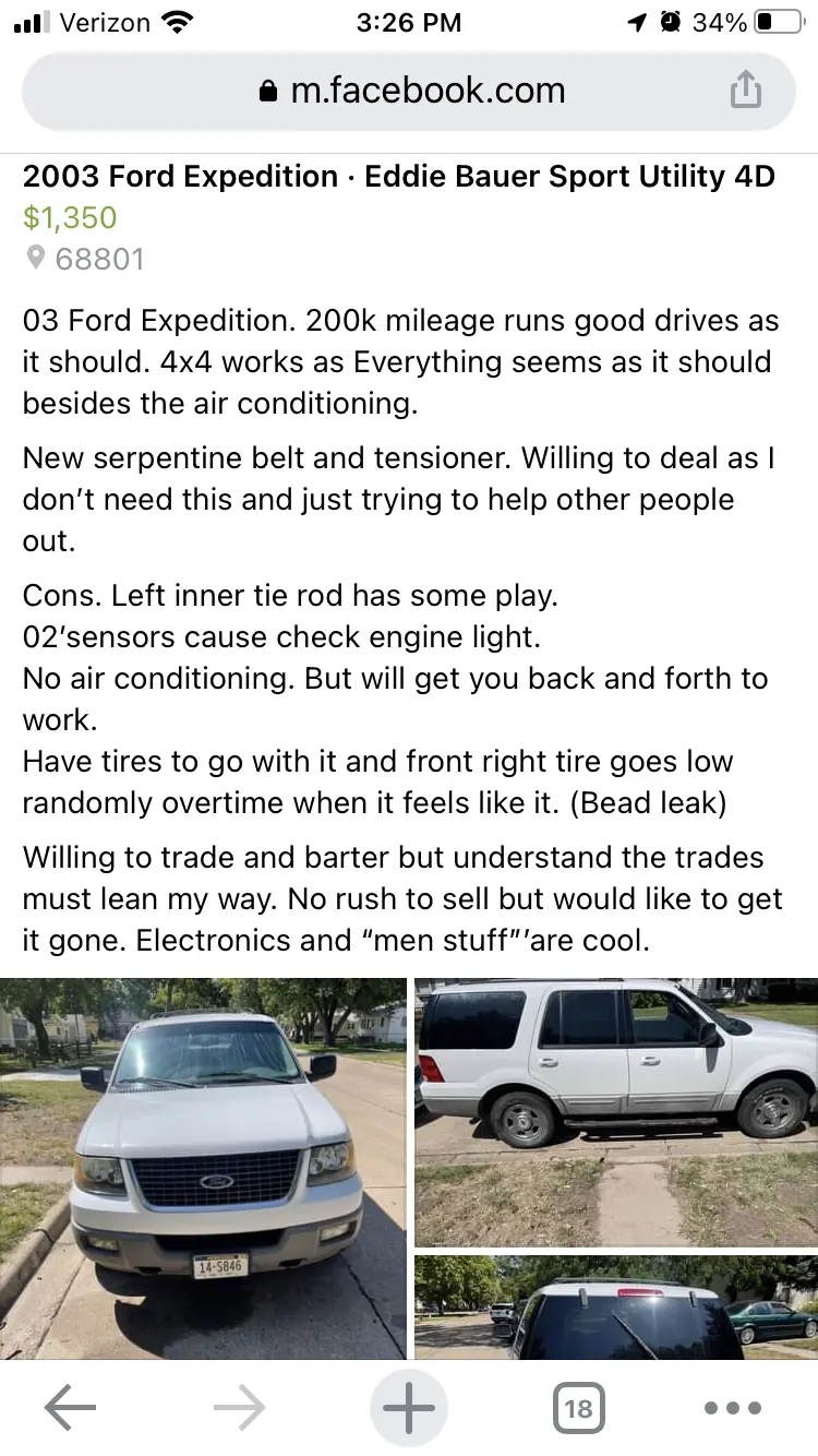

I ran across a vehicle that might be a nightmare or a great deal. The Expedition has a 5.4 with an AC problem, needs an inner tie rod and tires. $1350, and supposedly no rust besides the step bar surface.
What issues are likely with a 5.4? Timing tensioners?
