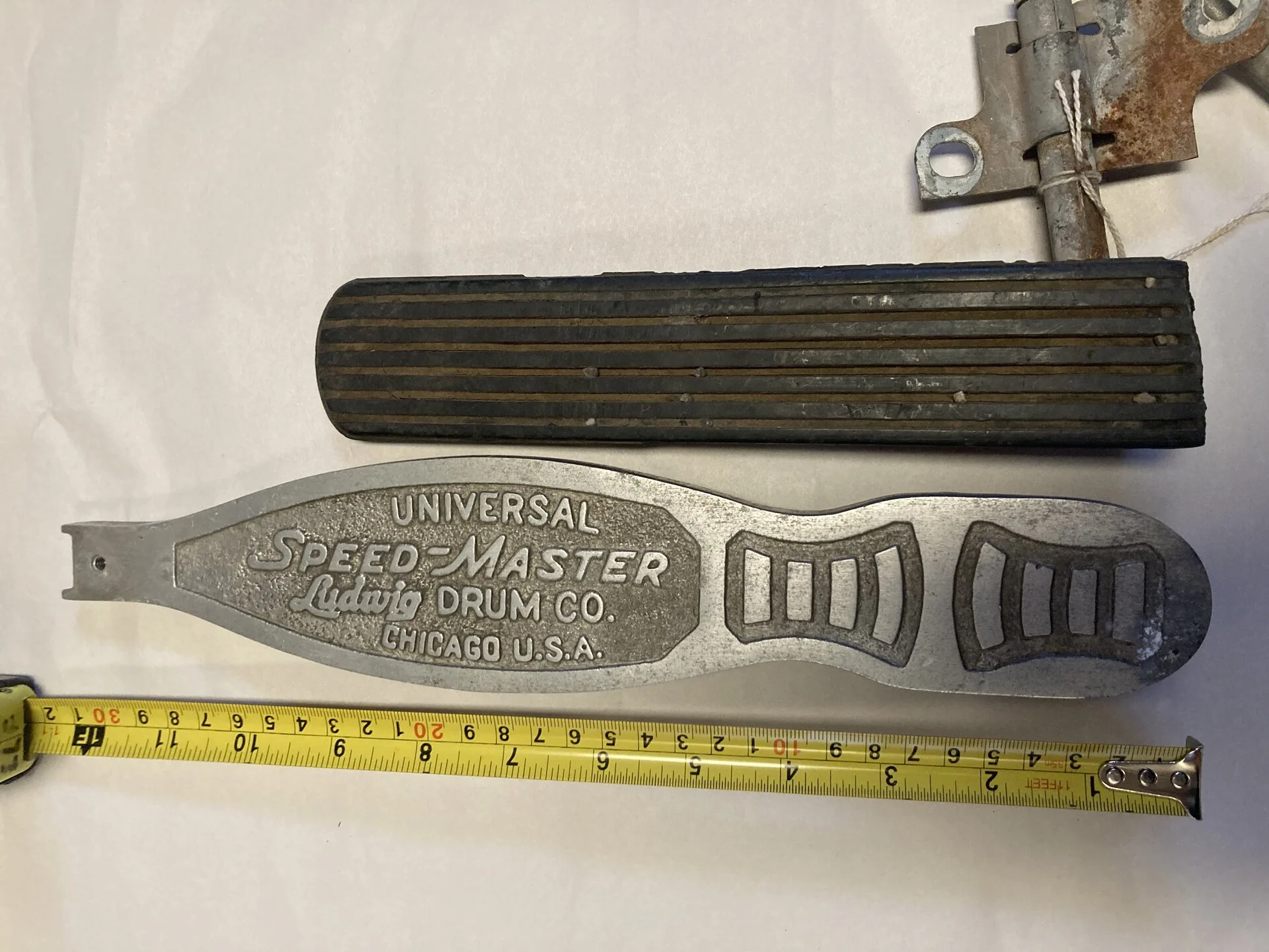

Here is a detail I have wanted to do for years. My gas pedal will be a Speed-Master bass drum pedal. I will trim the top tab into a better shape and take off the pivot from the back side. This is an extra pedal assy I picked up in case I do not like it. But as a pan that forms a tunnel under most of the length of the car had to come off to switch it, I plan on it staying.

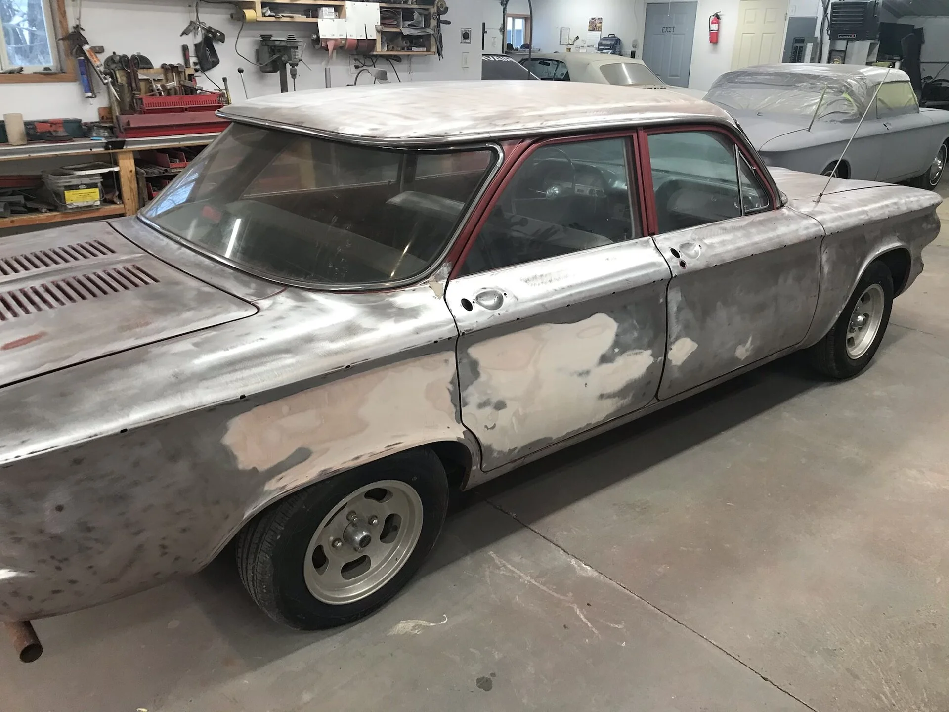

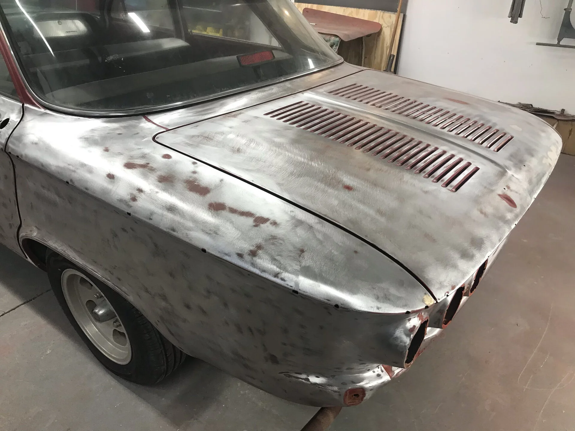

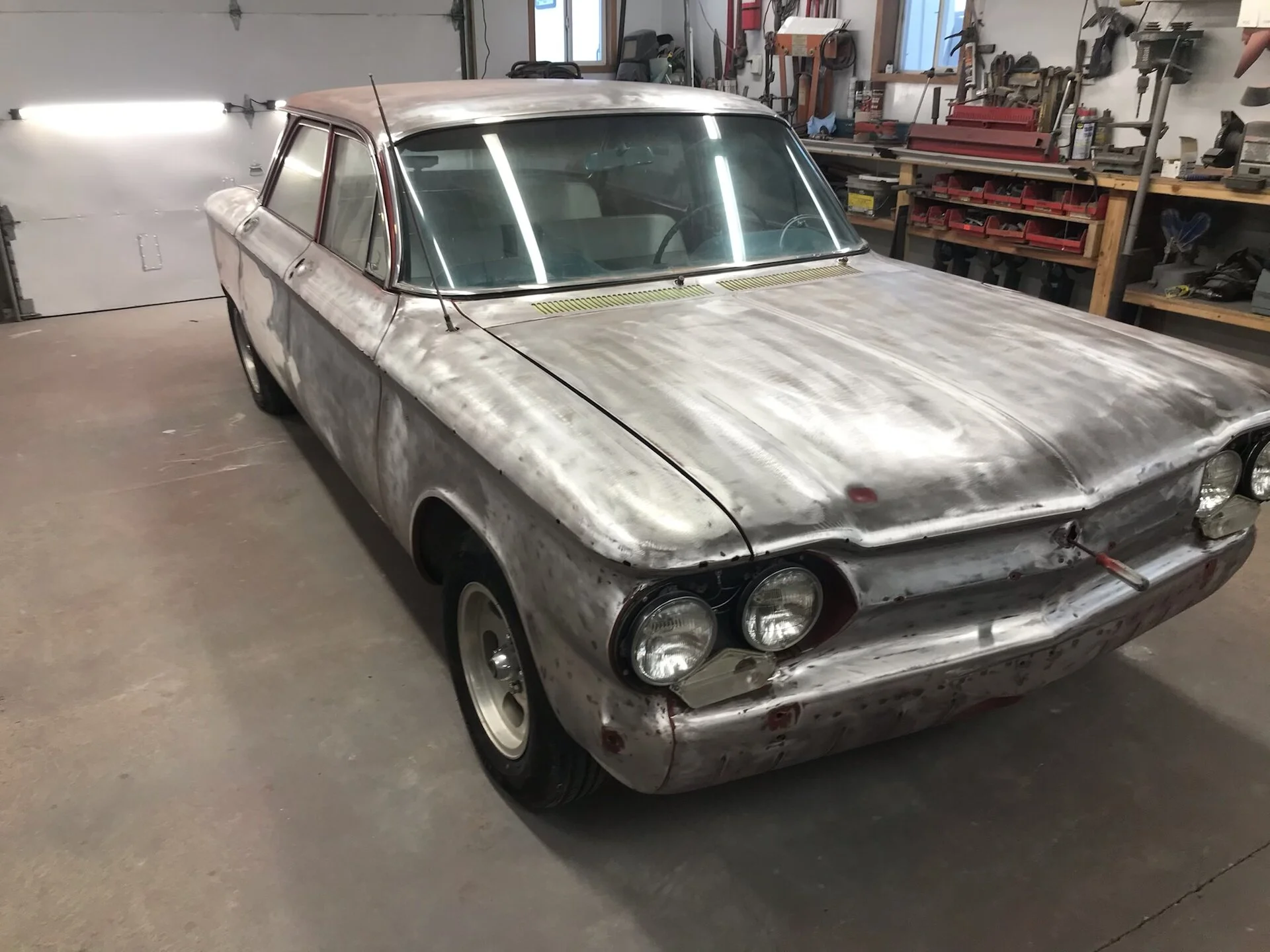

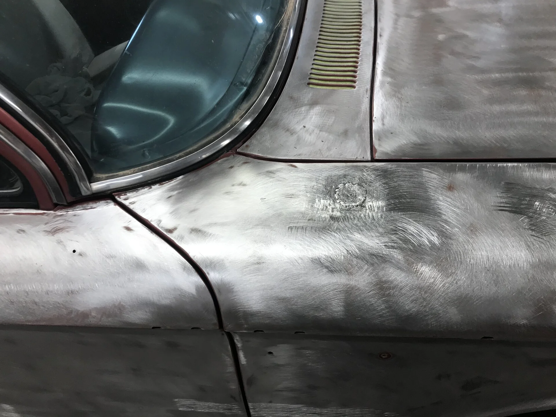

These are from when it was first sanded. There was not much rust, and I knew about the filler on the back door and quarter, and the light hit and run at the front door edge.
There are three big hail dents from a storm about 30 years ago. Dad got it moved in right as a fast moving storm dropped a lot of baseball size hail. I was across town and my second car did not come out as smooth from that storm.

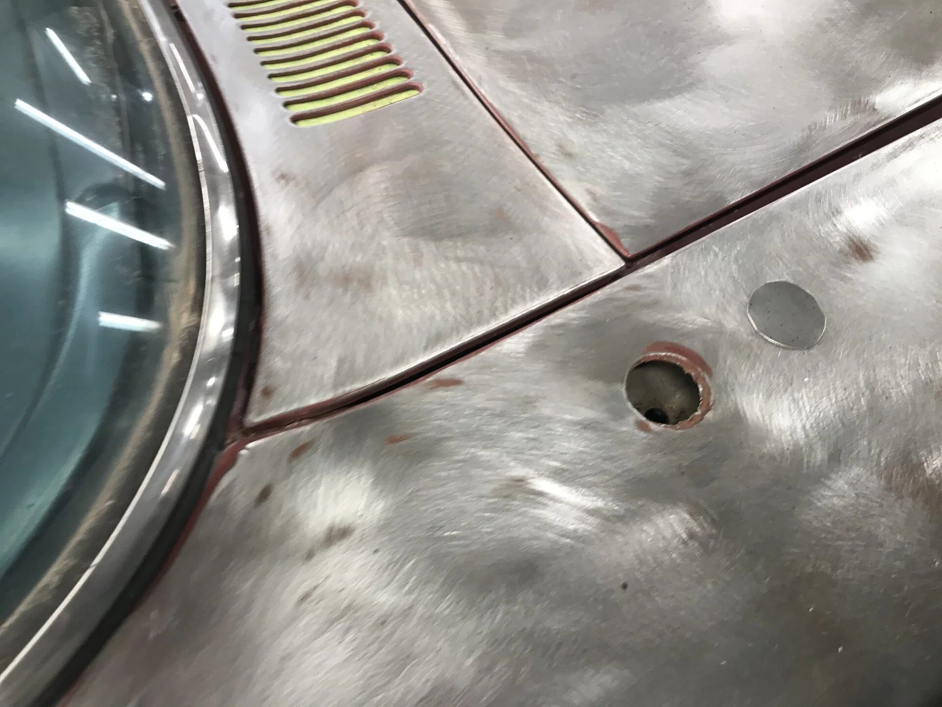

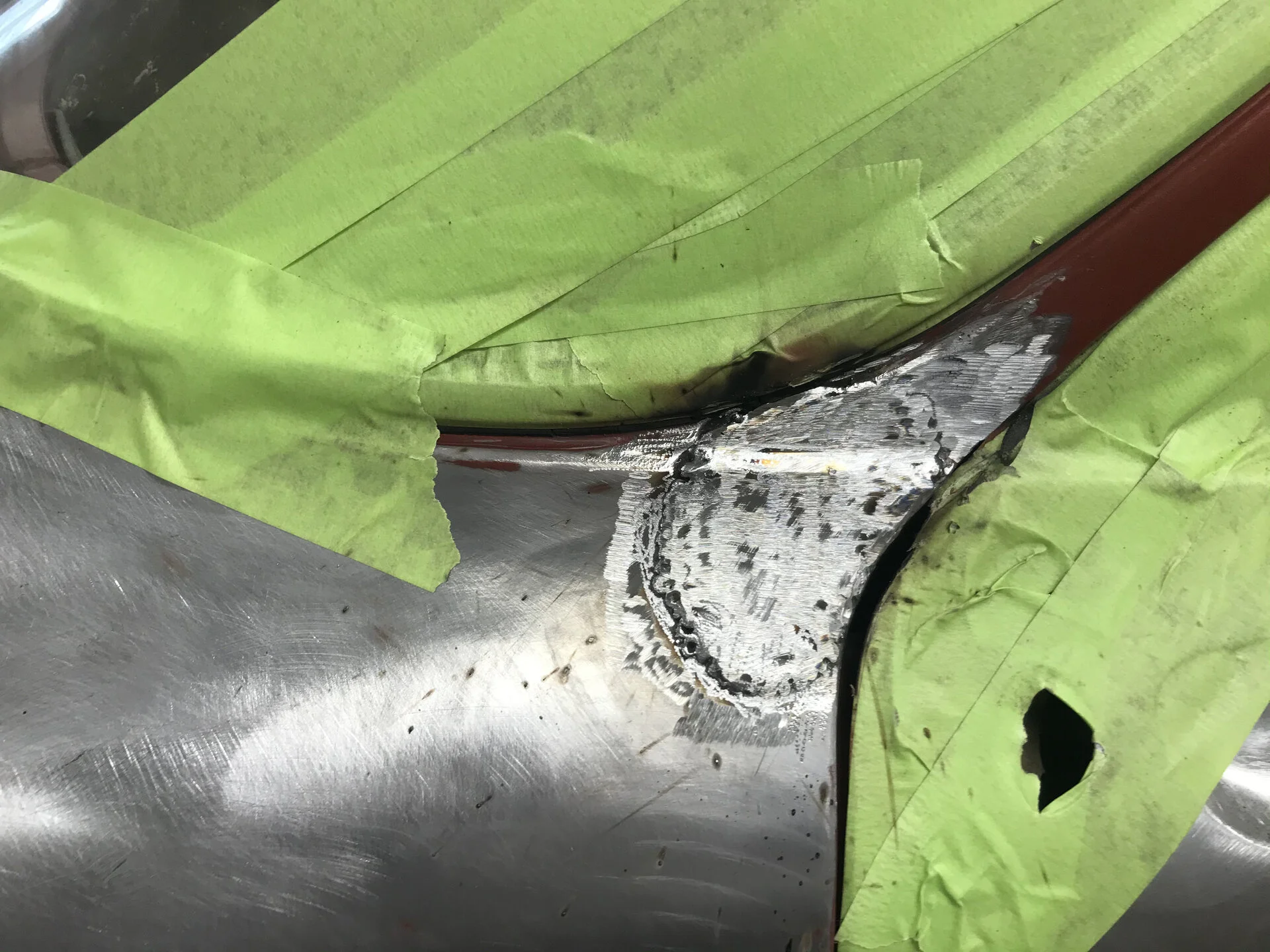

The antenna was not factory, and the cable was run through where the washer fluid nozzles are supposed to go. So now the mounting hole is plug welded, I will be using an under dash amplified antenna with a Custom Autosound radio in a factory radio pod. A car cover will not interfere with the antenna now. And I found a NOS two speed wiper motor and washer fluid kit.

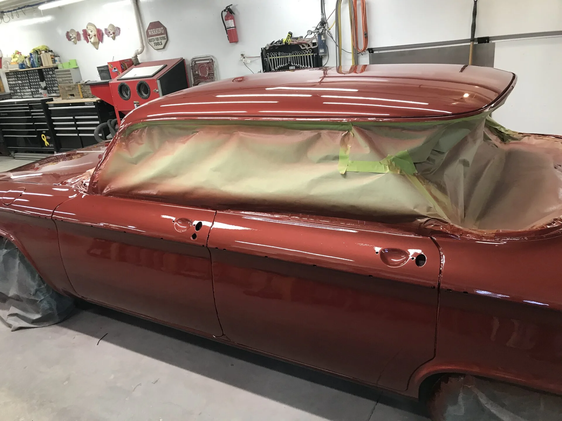

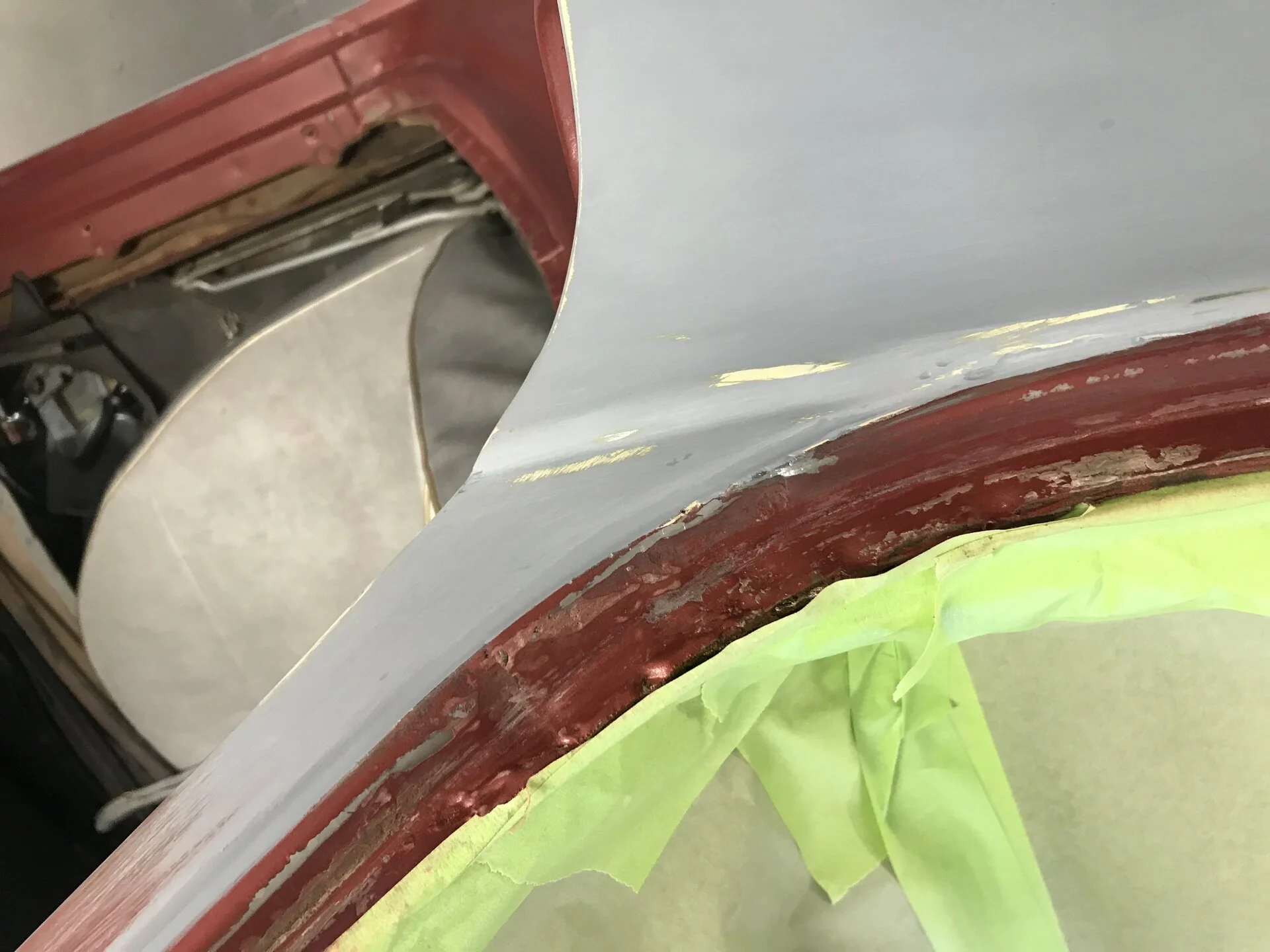

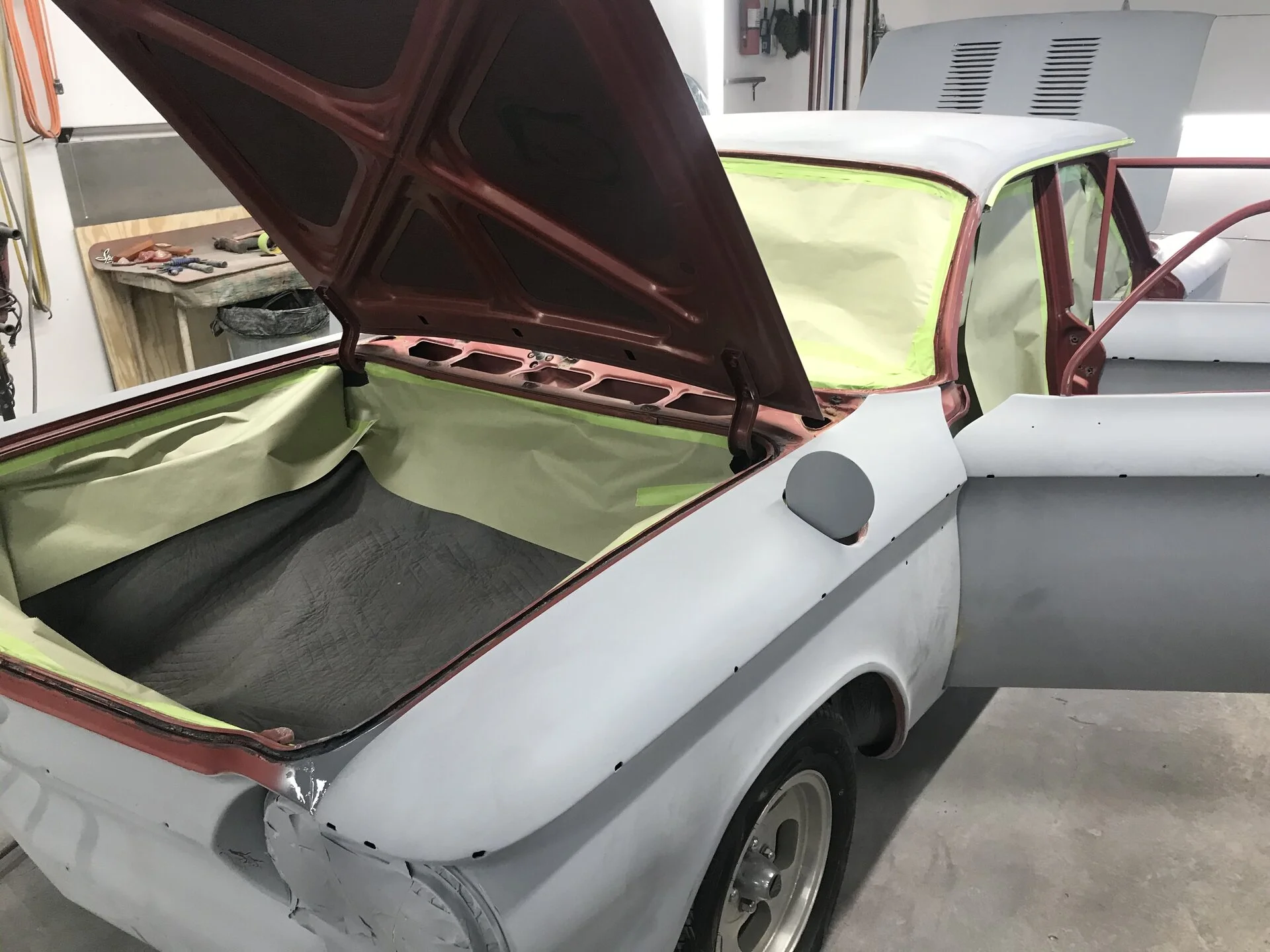

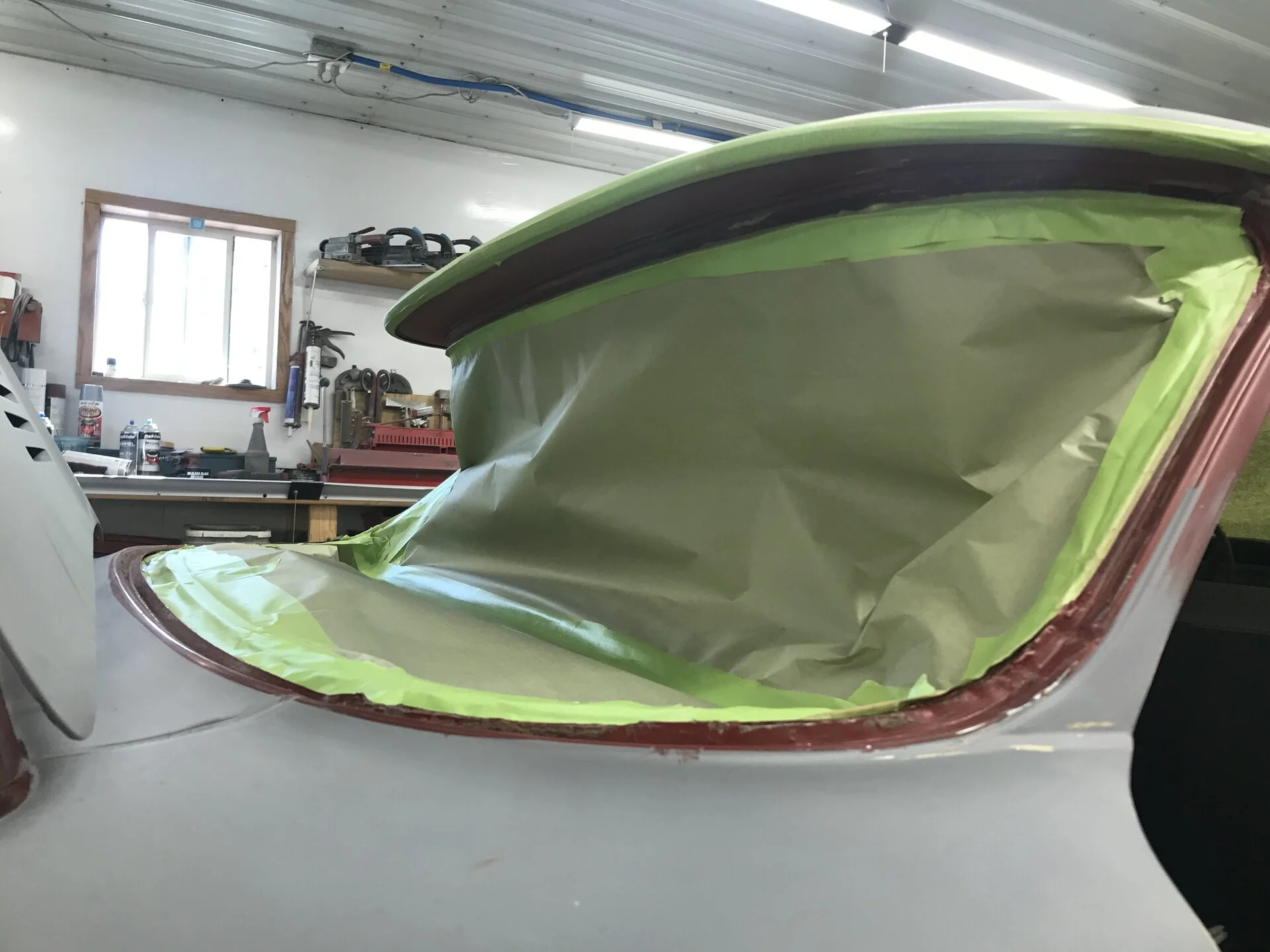

Trimming (cutting in) the edges and sills.
That is a huge piece of rear glass for the size of the car.

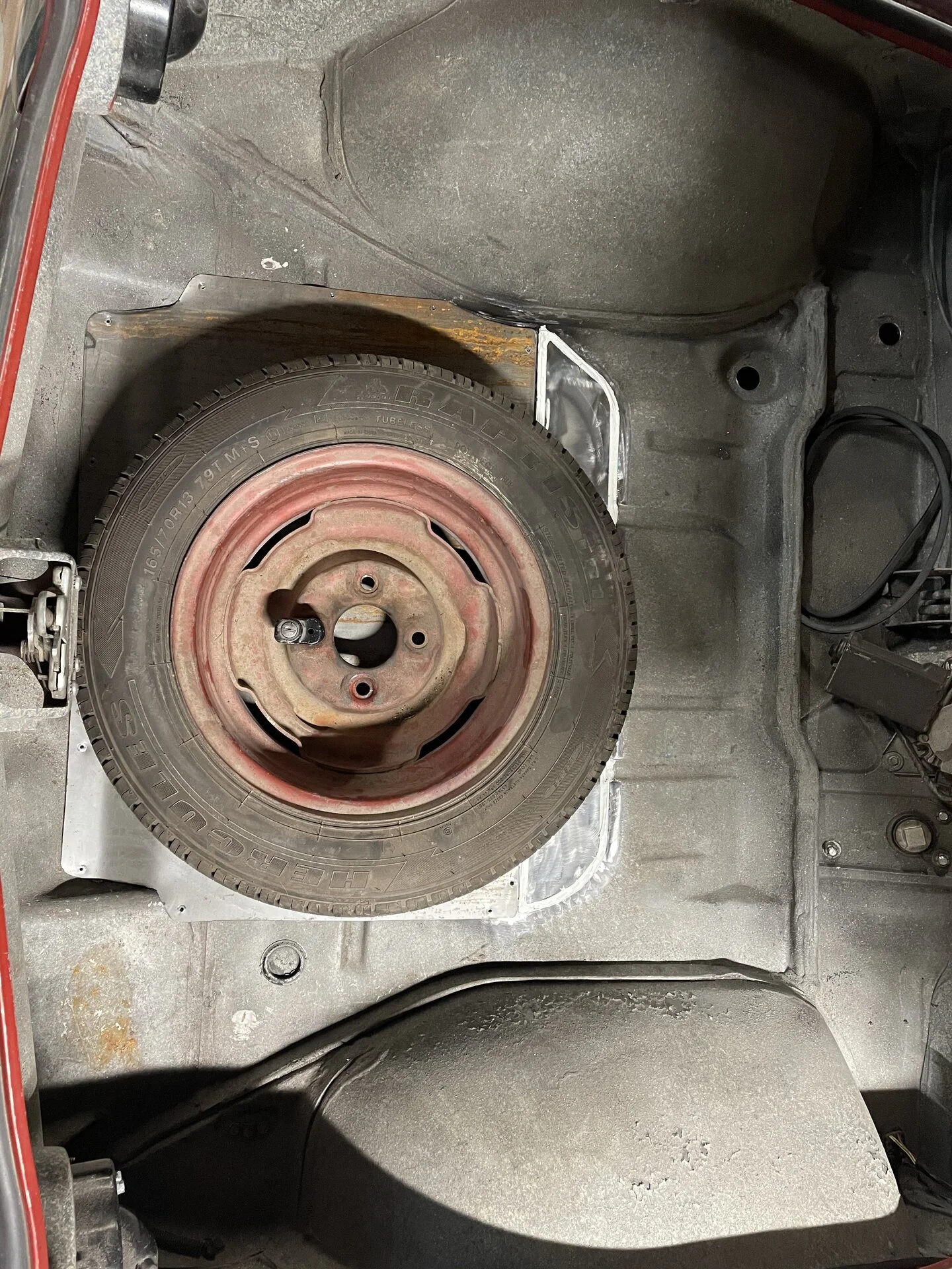

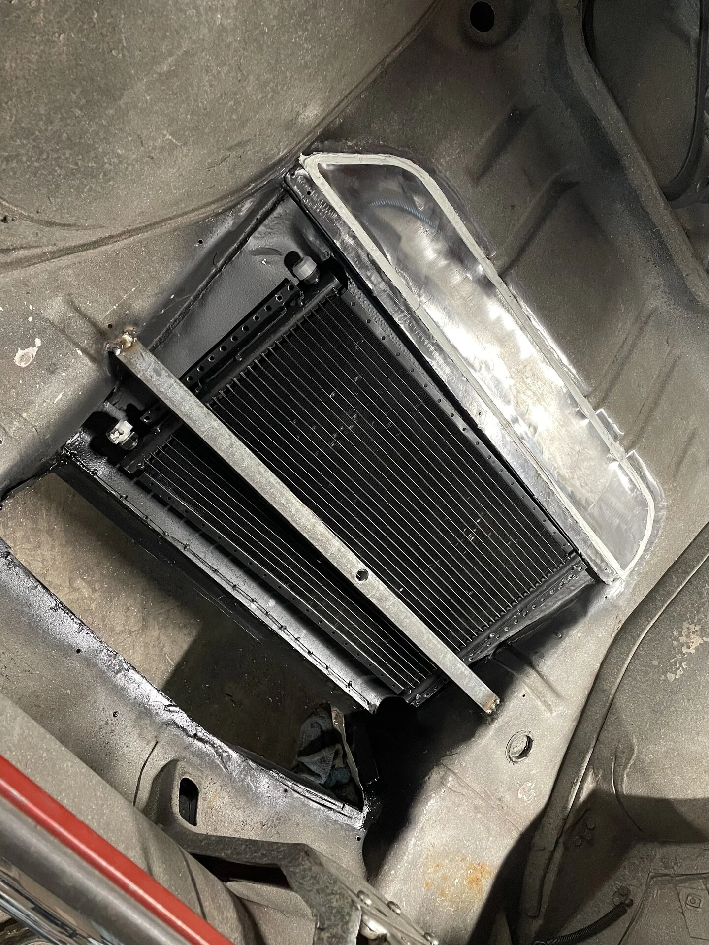

The trunk shrank with the AC kit. I hope to be able to modify a mount to still keeps a donut spare in the back, but the AC compressor is probably in the way.

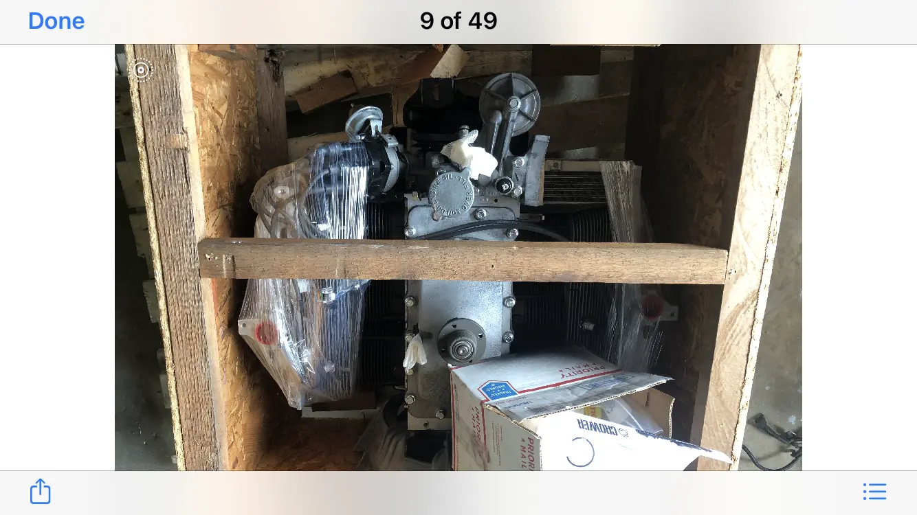

The new engine is still in the crate. Instead of the factory 80hp, it will have 130-140 Hp, and make the power where a powerglide needs it, instead of where the later 140 4 carb engines made it up high for a 4 speed. I will mothball and
seal the 31k mile factory engine, (unless I build an adult Big Wheel and use it.)

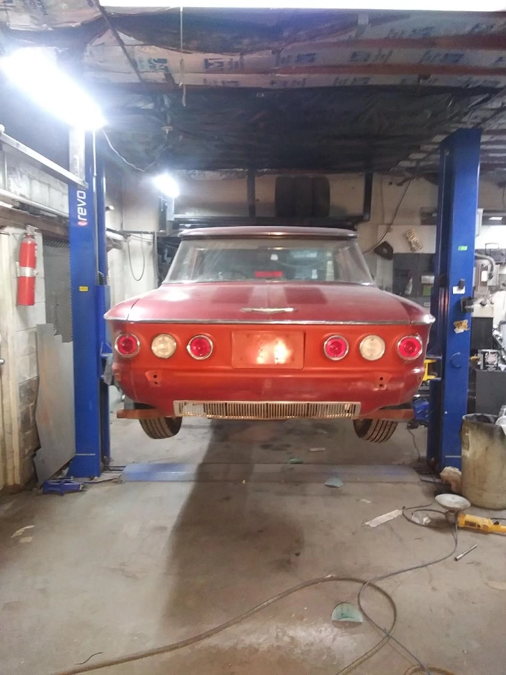

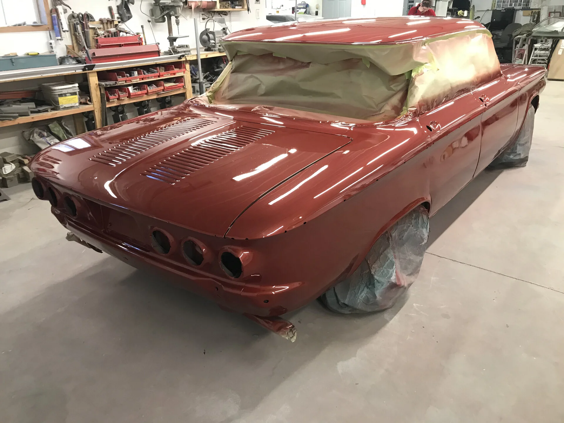

Gotta be the tail lights, they just look, ahhh, odd?
It is the rare Impala COPO option, or is it Kustom? :rlaugh:
I want no excuse for the crossover to not see that I have stopped. I also forms the rare two tone Monza (900 level trim, not the 60’s hatch) back up light lenses that will go in before it is done. I was going to put LED’s in a pair of the fake vents that mount on Monza’s between the rear window and engine cover. But up close, they would have not looked right. So a third brake light of some type will replace the JC Whitney special that rattled.

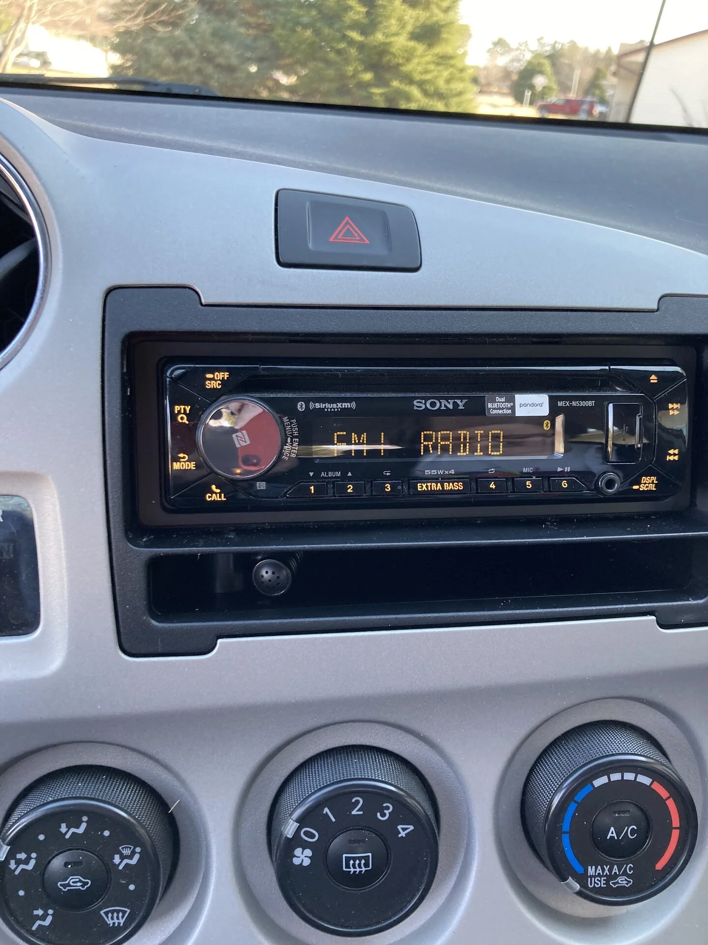

This weekend’s project was on my daughter’s Vibe, the Beetle replacement. She got a bee in her bonnet to put the Sony stereo we saved from the dead Bug in her new(er) car, and I mostly supervised.
The Crutchfield Vibe & Matrix harness adaptor was missing two pins (accessory and dash light dim). Hacking the car’s harness for two direct crimp connections was unconscious-able, and the factory wires are too thin for Scotchlocks. I wanted to leave it so the stock radio could be plugged back in. So…:scratch: We soldered in splices, used butyl electrical tape, and used fully shielded spade connectors on the spliced in wires. The stereo might not come out until after she drives the wheels off of it, but it could, and
we will not have electrical issues like on the Bug.
Here is proof it works. :) The black adaptor goes with the dash, and the thing in the phone holder slot is the hands free mic. I have another like it for my son to upgrade the 18 year old, similar Sony model in the Merc G. Marquis (the iPod/phone controls are starting not to work) and one for my Mustang.
