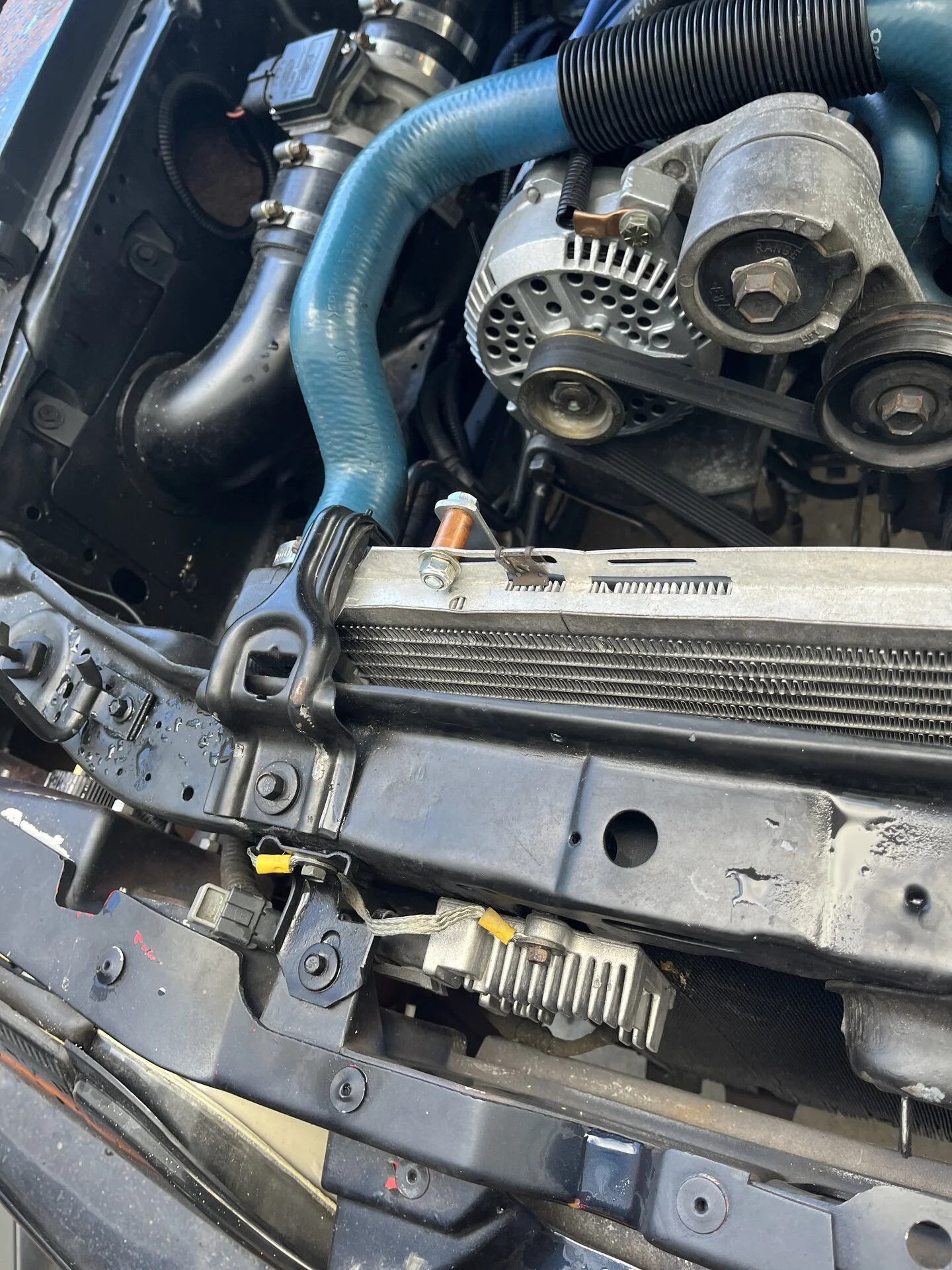

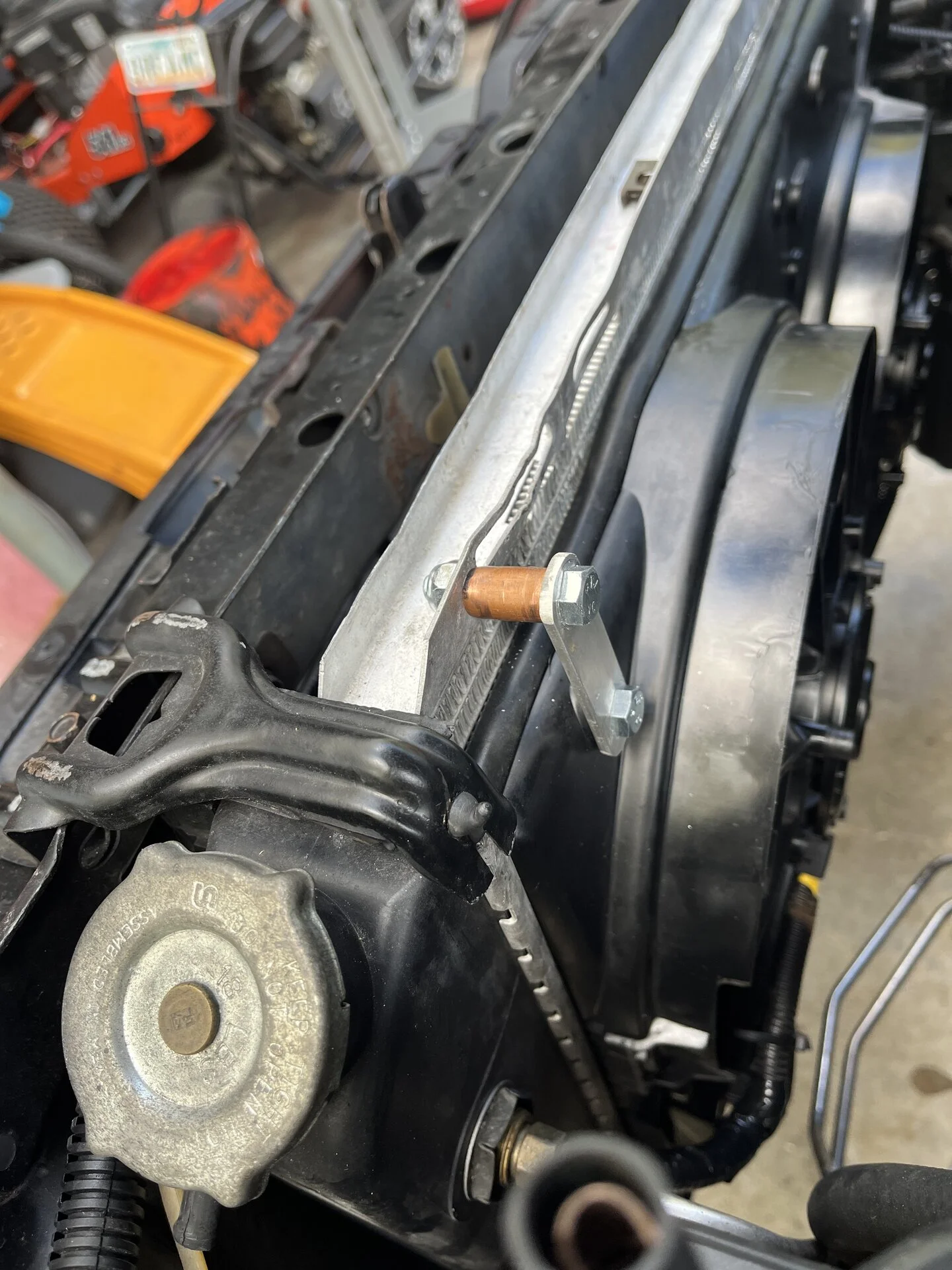

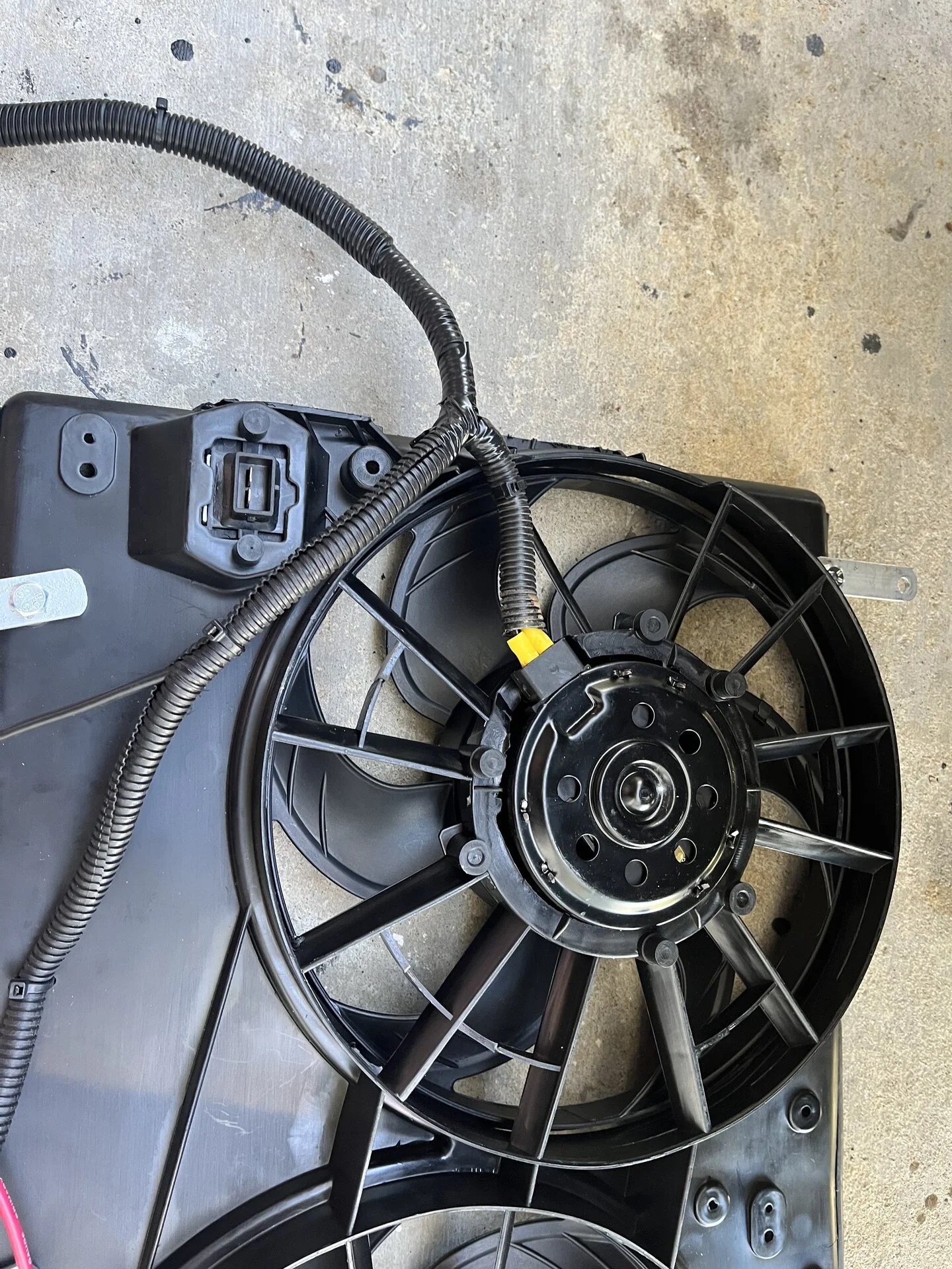

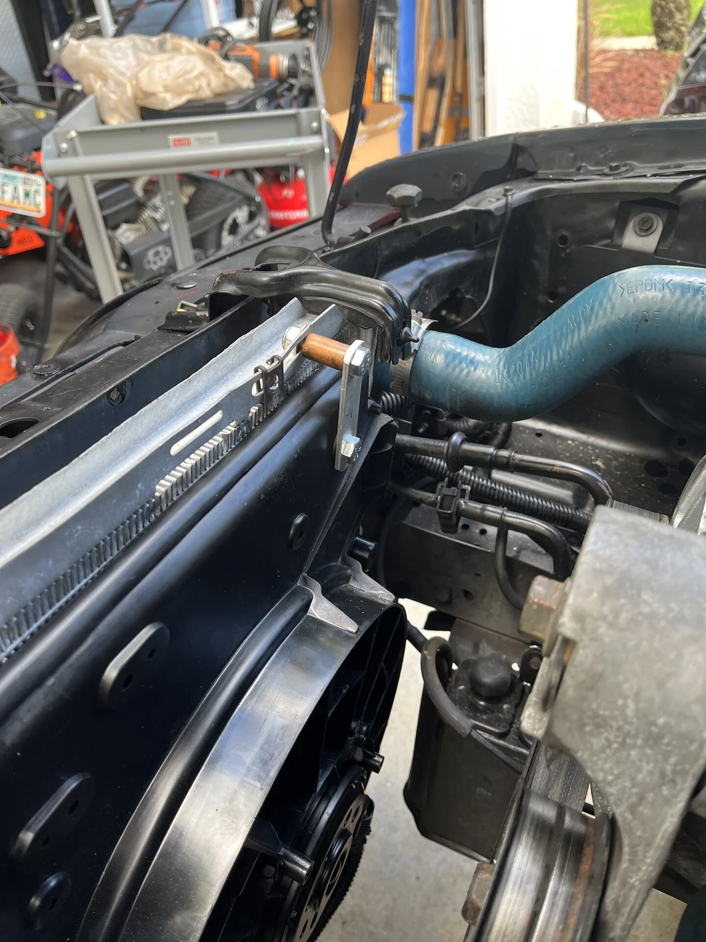

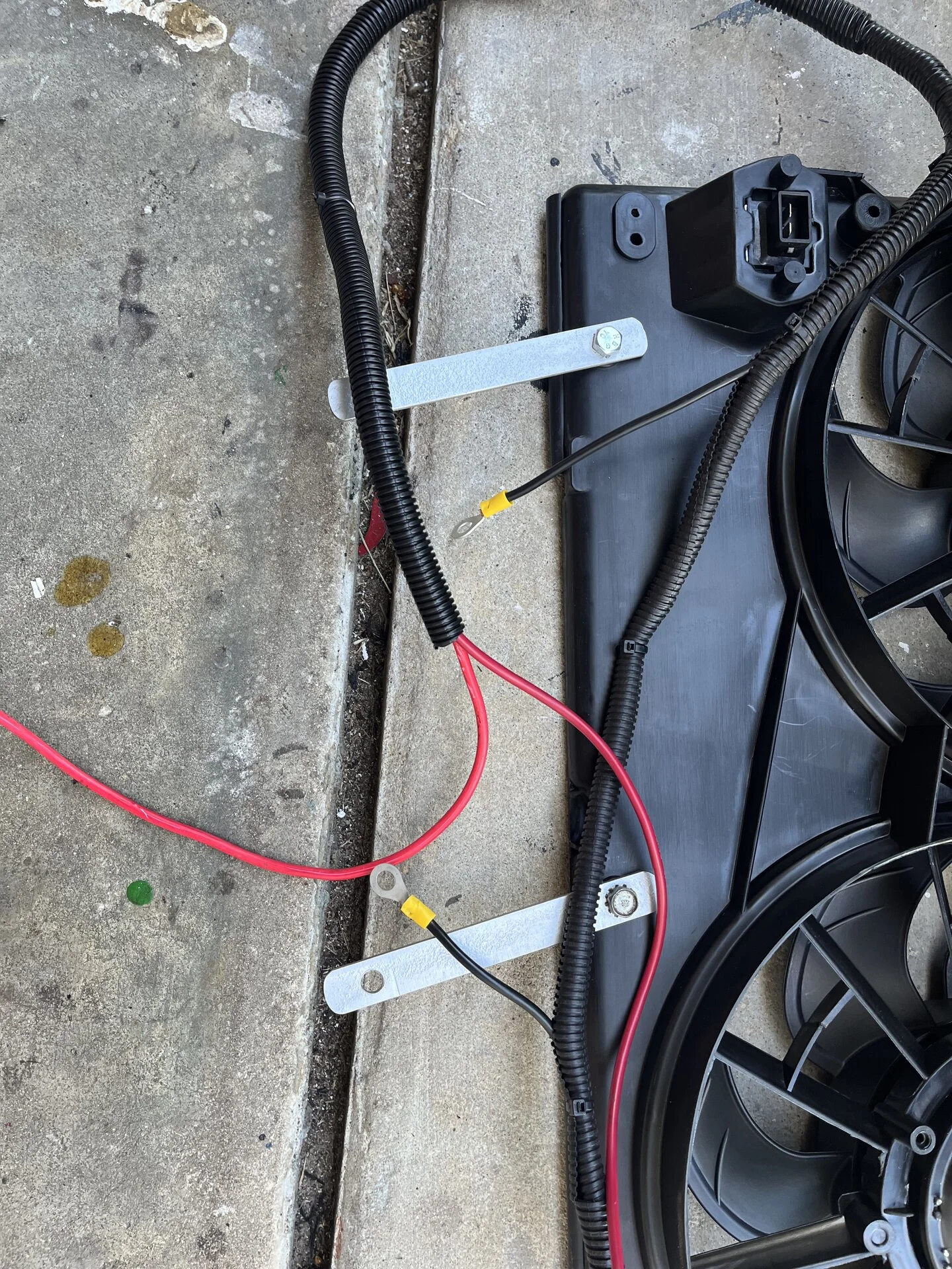

Well I finally had to move forward with the Contour fan conversion. Drove Blu Tunder the other day on a typical Africa hot Florida day and the temp shot up like a Elon Musk rocket leaving cape. Just need to wire in the solenoids. I watched several videos on the brackets and came up with an alternative for my project.

What are you using to control it? Relays, pwm? I use a pwm module controlled by Holley efi and only need about 60-65% duty cycle to keep mine cool around 185* But I don't live in Florida.
What is your t-stat, fan trigger temperature and temp sensor location?
Is that temperature with the fans running? If running, low or high speed?
I am assuming you are turning on high speed on the fans only. That would explain you 195 temp right now.
You original comment of being hot was probably due to some air in the system that has now worked it way out.
I have a 180 t-stat and on a cool day (60s or 70s outside), my car will stay around 180-185 on the highway all day long with the fans not coming on (they switch on low at 205, high at 215). On hotter days (80+) it will run up to fan turn on point.
Fans controlled by toggle switch, either on or off. Thermostat is 180 deg. It’s been blistering hot here in Tampa traffic. Alternator upgraded and under drive pullies
Dump the under drive pullies. They cause more issues than they are worth. The alternator and water pump should not be under driven. If anything; you want a higher flowing water pump. I'm in Phoenix FYI. Out here; I run the Contour fans on high speed only. These cars are engineered to run over 200*. I regularly run 210* plus in traffic with ac on. Your t-stat should be a 192*-195*. The old school "180* is perfect" addage is just that; old school. Engineers discovered years ago that warmer coolant temps create more power.
