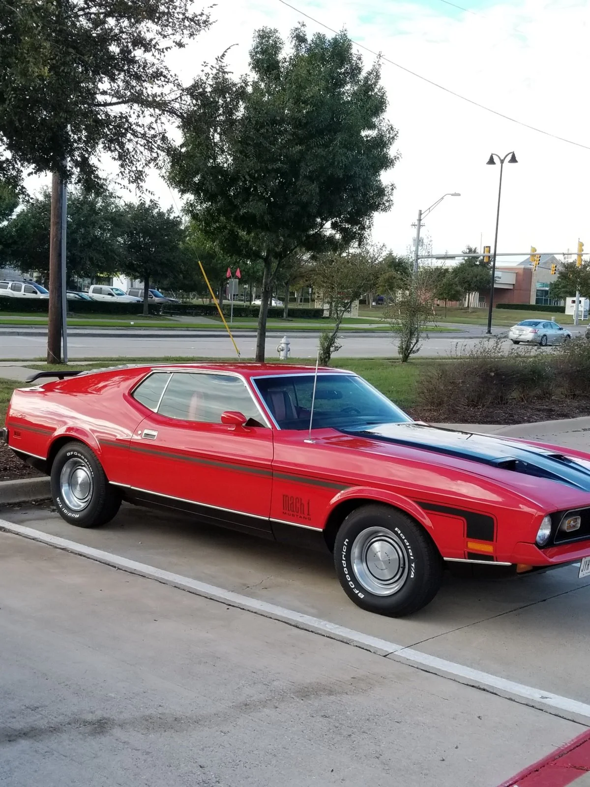

My 71 Mach 1 has single exhaust. I would like to convert to dual. Can I just have to cut out the existing Y and connect a new H pipe, run the new pipes with new mufflers?
Where can I get the best fitting dual exhaust kits and what brand to have a nice powerful song.
The engine is a 351 winsor with 4 bbl carb.
