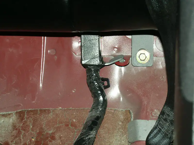

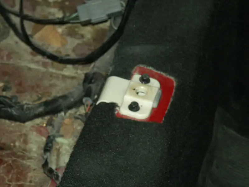

A picture (or three) is worth a thousand words. Use a large screwdriver to push in the tabs for the lower seat. Push in tab and raise slightly on the first one. Push in second tab and lift the rest of the way and pull toward the front of the car while slipping the seatbelts out. And a socket for the bolt in the rear upper seat (pic 3), one on either side. Pull straight up for the rear upper seat.

Thanks for the pictures that helped alot. I had no idea what type of tabs they were. Its kind of a cool design for the lower tabs. I figured thats how the back of the seat was held in, but didn't want to run into any surprises. We got the new carpet and upholstery installed. It looks great!
