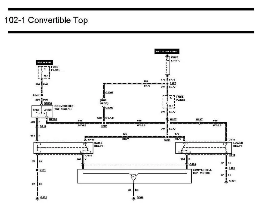

Great and simple wiring diagram. Does anyone know where the power going to the convertible top circuit breaker would we located? If it is close to the battery, I have been working around that area as well...
Fixed. Funny fix at that. I had replaced all the fuses...with used fuses of the correct amperage. Turns out the #5 fuse I used was corroded. I could take my test light with the key on, and have power at both of the test points on the back of the fuse...but the blade on the protected side was corroded. So no power through the fuse to the switch.
