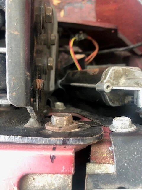

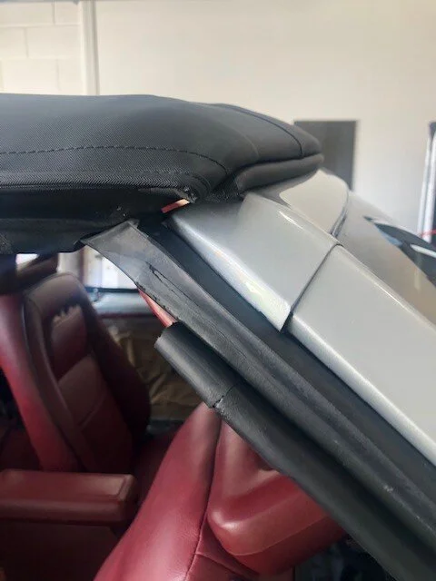

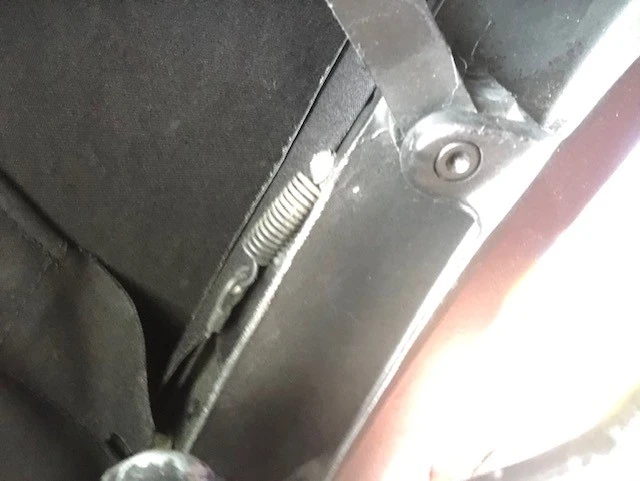

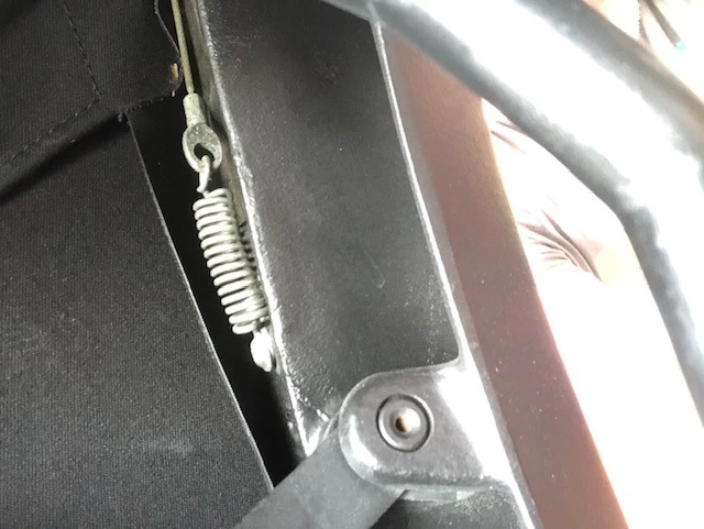

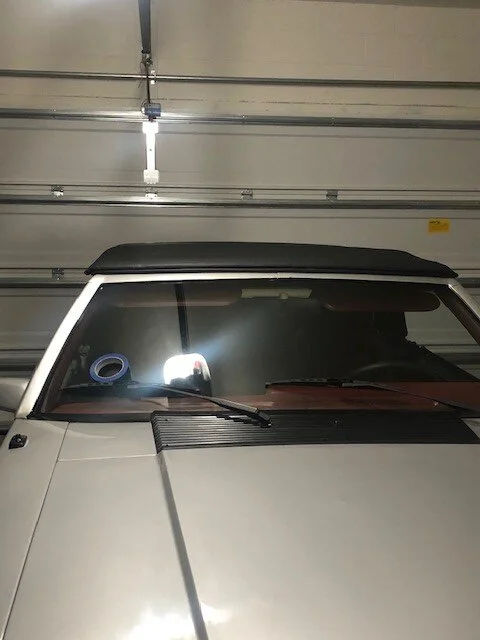

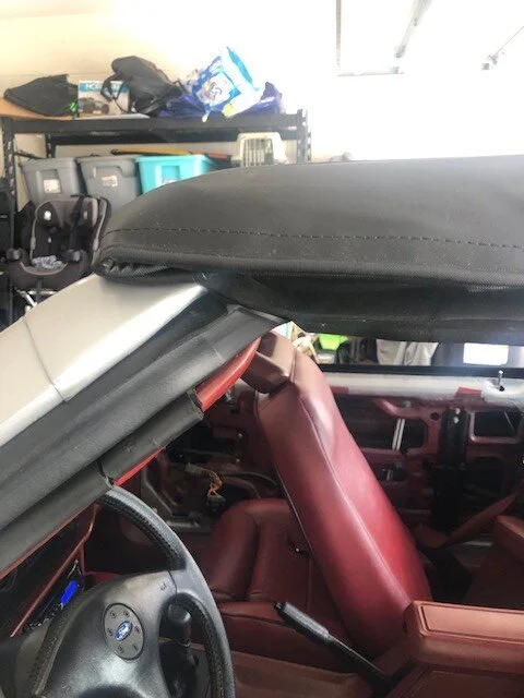

I recently purchased a 1984 Convertible...I knew going in the top needed some adjusting and yesterday I got the majority of it adjusted aside from one issue that I have no idea which adjustment to make. The passenger side is higher at the front header. It closes ok with some added pressure just to get the hook to engage. As seen in the pictures I adjusted the fore/aft forwarded but it really didn't help...It is almost as if the front edge is "twisted". The PO thought the top was too tight on that tight, but if that is indeed the case I do not know how to adjust the tension on the fabric.

The only way to adjust the tightness of the fabric is to let the sun heat it up for a few days. The fabric is stapled and glued on under the header seal.
Being in Florida the fabric is already plenty heated up and sitting in the sun hasn't helped. I am not even sure if that is the cause of my issue really.
I am wondering if adjusting the tension on the fabric cable/spring would help to allow that side to travel farther?
Mine was similar. I had to pull down the passenger side to get the hook to engage. I got a new top put on and I still need to do that. The only other frame of reference I have is a relative's 86 that does the same.
I'm not saying it's normal, but common.
Reactions: Boosted92LX
Around the rear of the top, inside the car, there are a bunch of nuts holding the rear brackets . Unzip and remove the lower window curtain with the bracket. Pay attention because shims ( washers ) may be installed behind it. Remove that right side bracket and see if the top settles down.
Technically, the bow controls the tension on the front of the top. That's why on an older car the back can rip up but the top still stays tight between the bow and windshield. The tension cables can cause some issues closing. There should be a spring at the end of the cable screwed to the top frame behind quarter window.
Over the years I have come across new cables that where either longer or shorter.
Yes. Move it up and use a self tapping screw to reinstall....or get a different length spring. When screwing a tapping screw in the frame be careful. Back and forth to keep from stressing the frame. I've never cracked one but always been careful. Could drill a pilot hole with the correct bit, also.
