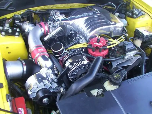

Here's a pic of mine with a getto-fabbed disharge tube. I wanna get the Vortech Fox tube, but the one with the mondo bypass mount is pretty expensive!!

The_Mustang said:
No, he's saying that the Fox discharge tapers down as it nears the outlet on the head unit. It goes from 3" down to whatever size the outlet is. You're pretty much gonna have to cut all of the tapered part off leaving a 3" pipe. You get a reducer and you'll be all set!
What kind of discharge tube is that then? Clean engine....

That is just a piece of mild steel tubing. Thanks for the clean comment, I do try!
The guy I bought the supercharger kit from had that discharge made up, this is why I went with a Fox throttle body setup because that's all I had to work with.. and I had the parts to do the swap anyway.

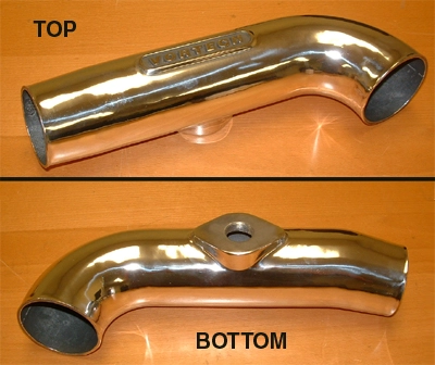

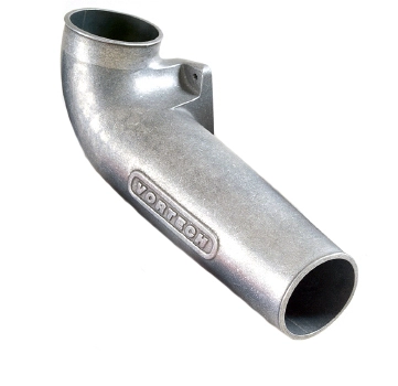

This is the one I need:
I assume this is the one you want:

RC, it depends if you're running a Race bypass or mondo bypass with your setup, if you're just using to stock plastic bypass then you can use a regular discharge tube.
YES..I think mine is just the tubing with connector underneath....THat looks REALLY nice and clean in the hoods!!
