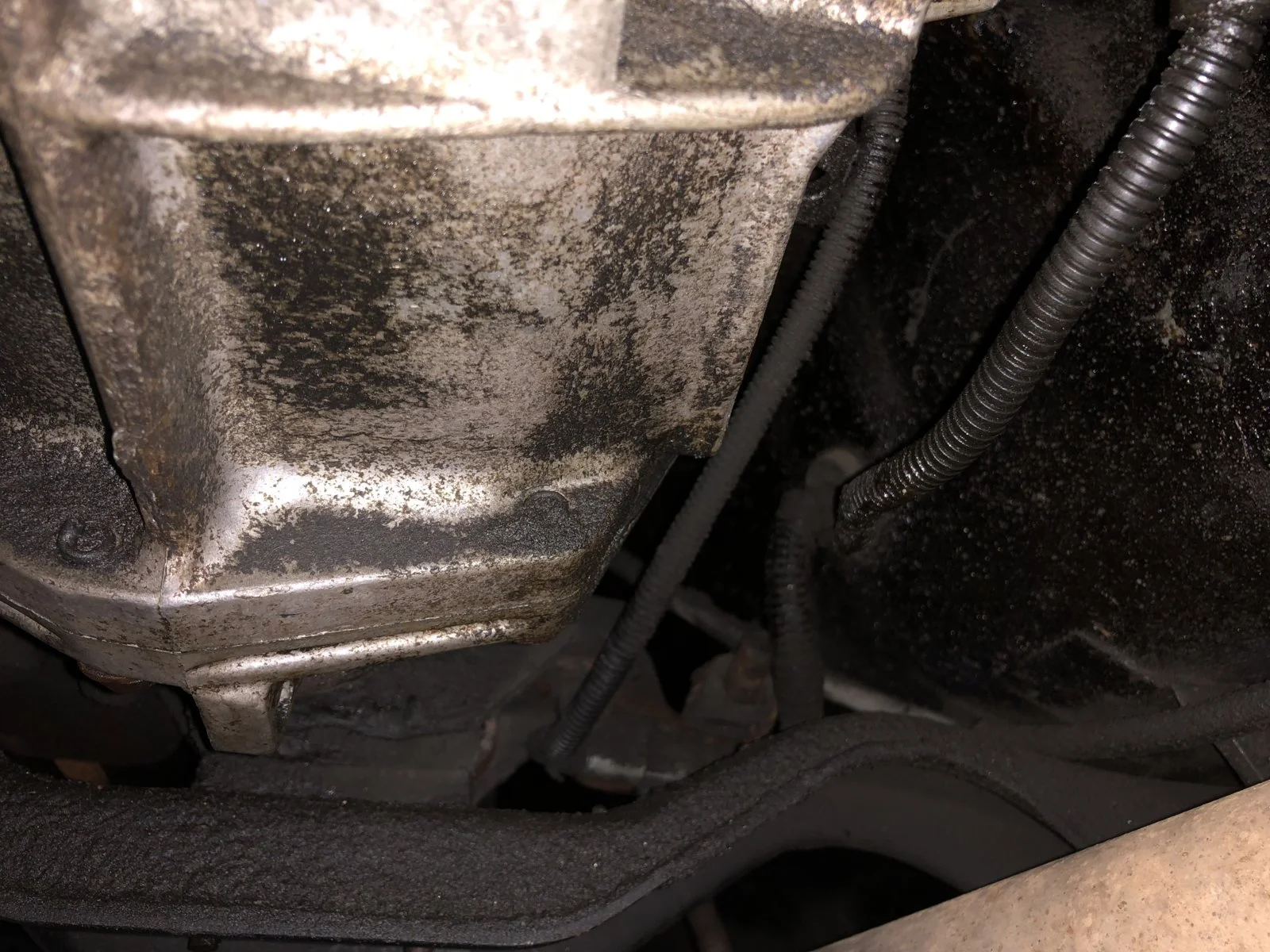

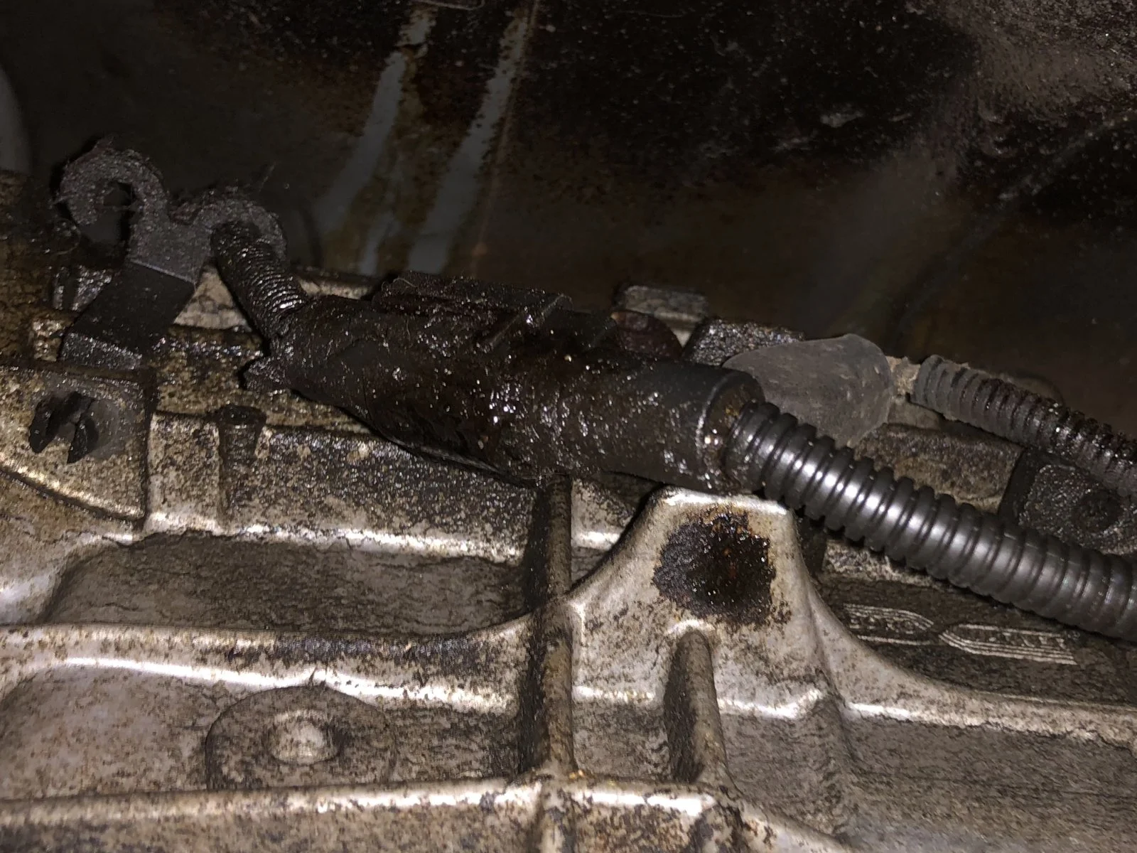

So here’s what I got. These plugs seem to already be plugged into another plug.

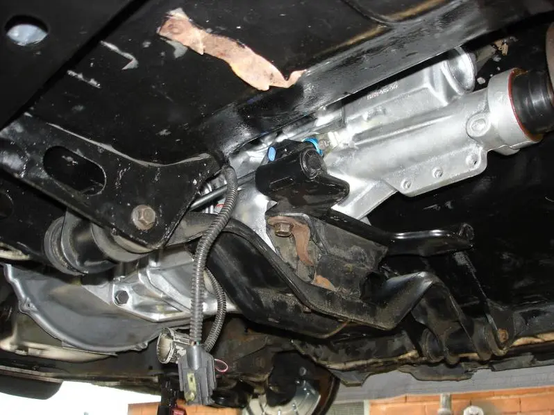

Here's the only pic when I did mine. Located drivers rear of trans. You can see the plastic clip the plug is inserted in that has the typical faded yellow Ford plug to stick it into a hole

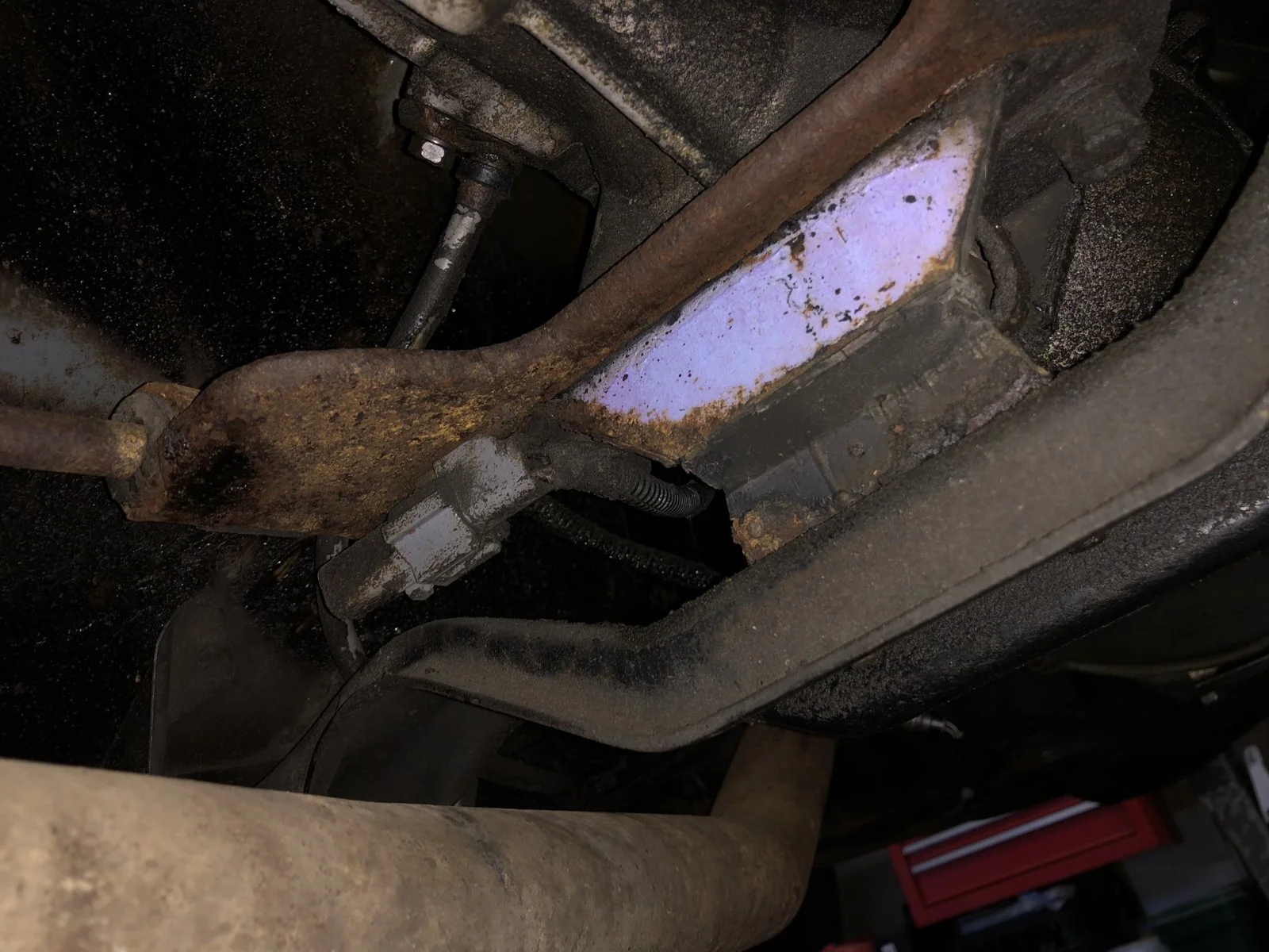

Right side of x member...the small hole is where I'm 99% sure it was attached to on my car
Thinking about it...it's possible I gave some bad info. My car is a late 88 so it has the o2 harness jumper that 87s and early 88s don't have.
Ford eventually started prewiring all '88s like a MAF car (minus the MAF wiring) and may have added the vss wiring at the same time they added the o2 jumper loop for the start circuit.
Long story short...you may not have the wiring. In that case, you just need to get the VsS pigtail from LMR or rockauto and run two wires to the ECU area
Nothing that I can see. I wonder if 87 didn’t have that provision? That would be my luck. Not a huge deal since it’s only 2 wires to the ecu.
