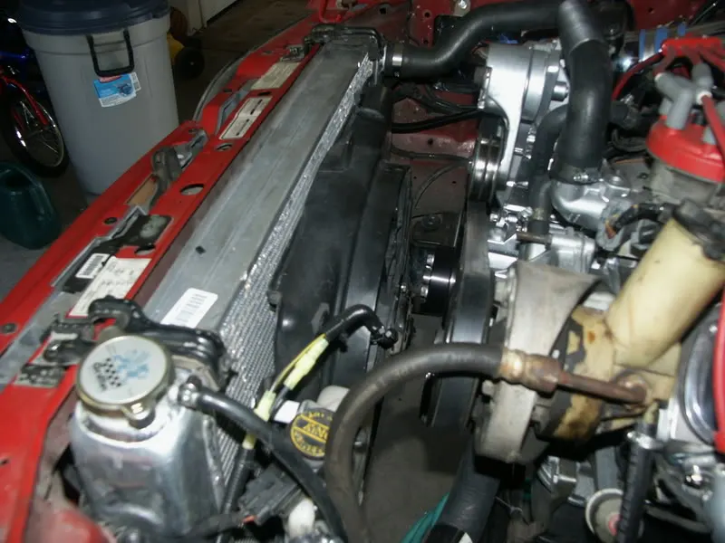

Ummm....I have a Taurus fan and use the stock puke tank in the stock location - just requires a little thought on how to mount it.

My stock coolant bottle fit right back on. It curves exactly the same as my taurus fan, and I just used a couple radiator pull through ties creatively to hold it in, and used some safety wire (creatively) to hold the bottom on to the power steering cooler lines.

The bottom of the taurus fan fits in to the mounting slot at the bottom where the old shroud fit in. Then, you use radiator pull through ties in the holes in the top corners of the taurus fan to hold the top on.

I mounted my fan shroud exactly the same as the stock one. Used a cut-off wheel to make slits in the bottom for the stock style clips and used two small aluminum "L" brackets for the upper mouints - if you look close in the pic above you can see the heads of the rivets I used to attach them to the fan shroud.
