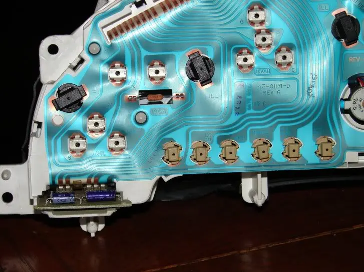

you have to remove the
headlight knob,
cluster bezel,
unscrew the retaining speedo cluster bolts and remove the cluster,
disconnect the 2 main harness on the cluster and you'll see the lights sticking out
find the one for the coolant light and twist it off
keep it in a box or something :cool:
i just snapped a pic for you. opposite side, far left, it'll say Lo Cool :cool: lol
Dude....thank you SOOOO much!!!! Thats a kick ass description of the situation....thanx so much for taking the time to do that bro.....I'll get on that then and remove the peice.....you rule
