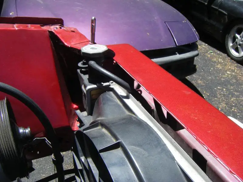

Here is the picture of the how canton 94-95 mustang one looks mounted,
I had to use the 99-up V6 coolant bracket so it sits and fit perfect without a spacer of some sort,
I had to find this out the hard way after trying to make this can work with 94-95 bracket, it simply will not fit so dont even try with 94-95 coolant/ccrm bracket,
Of course you will have to relocate the ccrm to the fender or under your air box
