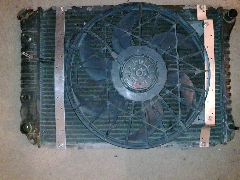

The fan and under drives together might be compounding the issue. I honestly don't know how many CFM the Mark VIII fan moves but, I don't have under drives yet either. Like the fan idea, you could put the stock pulleys back on, if you have them, & see if it helps. might be a band aid fix until you can get a fan with more CFM. Here is a pic of how I "rigged" my Mark VIII fan. you can pick up the metal straps at Lowe's or Home Depot. My car didn't have a shroud & I haven't bothered with one as it doesn't over heat. I'm sure there are prettier ways to do it but, mine isn't meant to be a show car.
