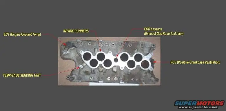

As for the temp guage...I know it is easy, but I have had it explained to me many times, and yet still don 't get where it is located. I know it is on the upper intake plenum/manifold correct? I just don't get where, which make me think mine isn't there.

The water temp sending unit is on the lower intake manifold right in front, behind the distributor. A 5 minute job to replace. Check first to see if the wire is connected.

mikestang63 said:
The "Temp Gauge" arrow is pointing at an upper manifold bolt boss. ???
The sender the red arrow is looking for is the one on the left front, right behind the first lower manifold bolt. (Driver's side extreme front)

I will probably just buy a new radiator cap rather than play the testing game. can't be too expensive right?
Where? haha
This is why I never understood people's explanations. They always put up pictures w/o arrows and try to explain locations.
Try saving the picture and use paint to correct his misguided arrow.
