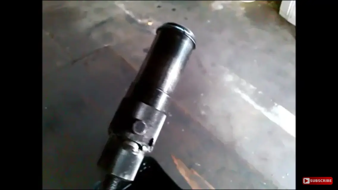

When the T-5 tailshaft bushing needed changed, my shop made the tool to go in after the seal was pulled, expand to hook on to the bushing and pulled it right out.
I swiped a pic of the type of tool from a youtube video. It also shows the general procedure. You do not need to hit your hand with the hammer.

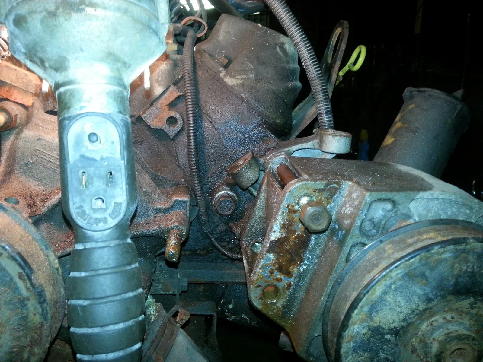

Decided to do the timing cover gasket while I’m in there. Also going to attempt the in car car oil pan gasket. Honest the front crank seal looks perfect after 30 years and I’m surprised. Main question is; I’ve done my homework but noticed the MarkVII Has the power steering pump bracket bolted to the studs on the water pump. Has anyone encountered this on their mustang? I have not been able to find a good write up on this in any searches, include MarkVII searches. Have a manual which I’ll double check but figured I’d ask you guys for some advice. Thanks in advance.

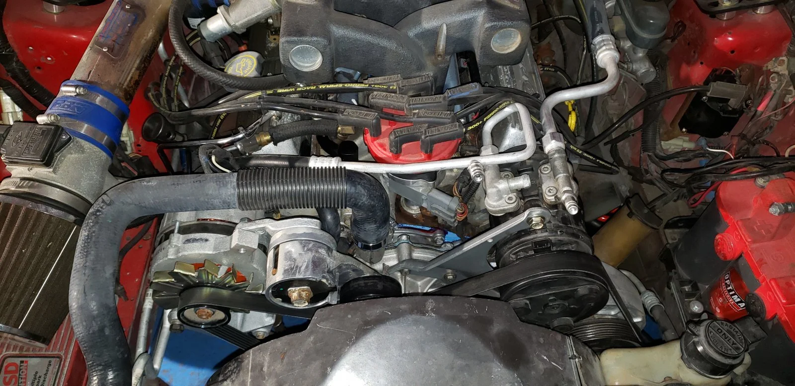

I'm assuming you are talking about the big plate that bolt in tow or three places at the water pump then holds the power steering pump in two places? If so yeah. My mustang is like that. I'll see if I can find a picture.
Reactions: admLSC7

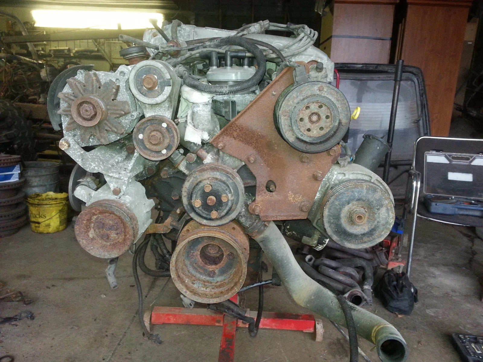

Here is my OEM setup from when I first got my car. I took these as I tore down the engine so I would not forget where everything went.
Engine and trans were bolted together and on a pallet when I bought the car so all accessories were still in place.
Yeah, that setup appears to be doing basically the same thing the bracket on my car does, but your's is setup different. If no one else chimes in with pics or helpful comments by this evening I'll take some better pics of my car. I've never messed with a Mark before. I'm just trying to help you see how this setup is on a V8 Fox.
Reactions: admLSC7

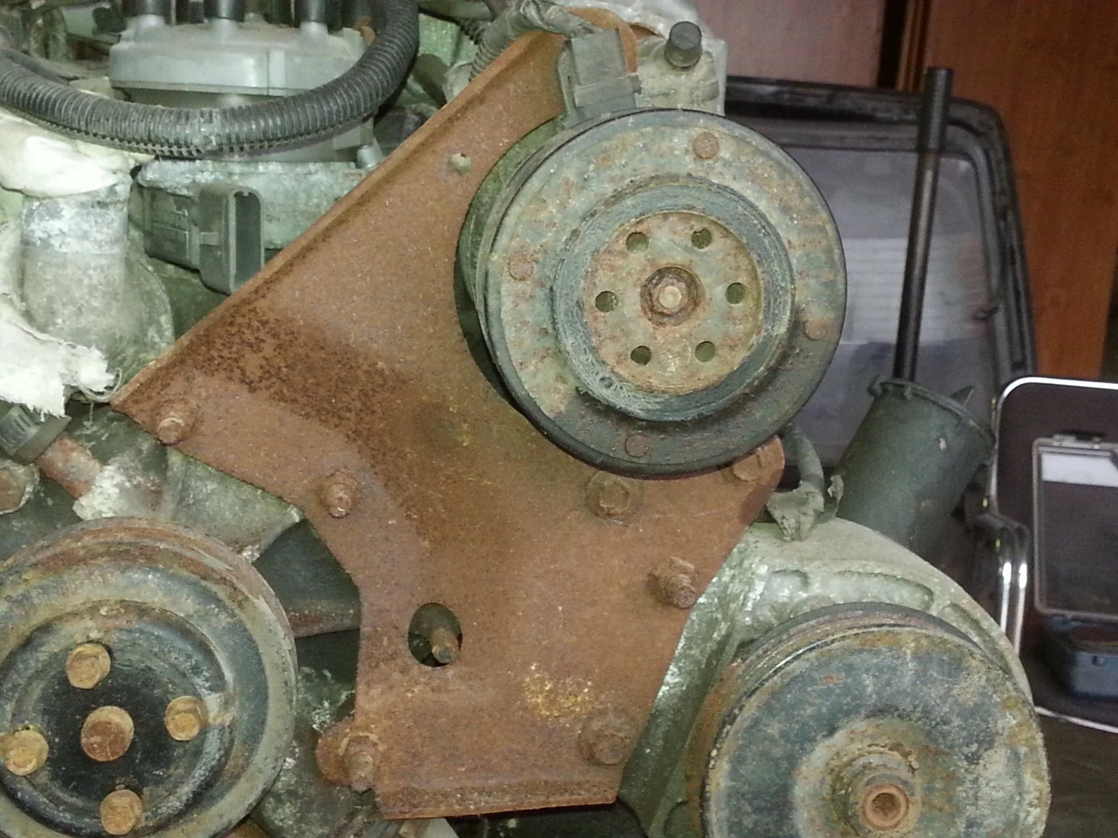

When the main front plate is removed here is the remaining PS bracketry. Shown with the rear mount for the AC compressor. From my other pics I count 3 mounting holes coming off the water pump studs.
Reactions: admLSC7

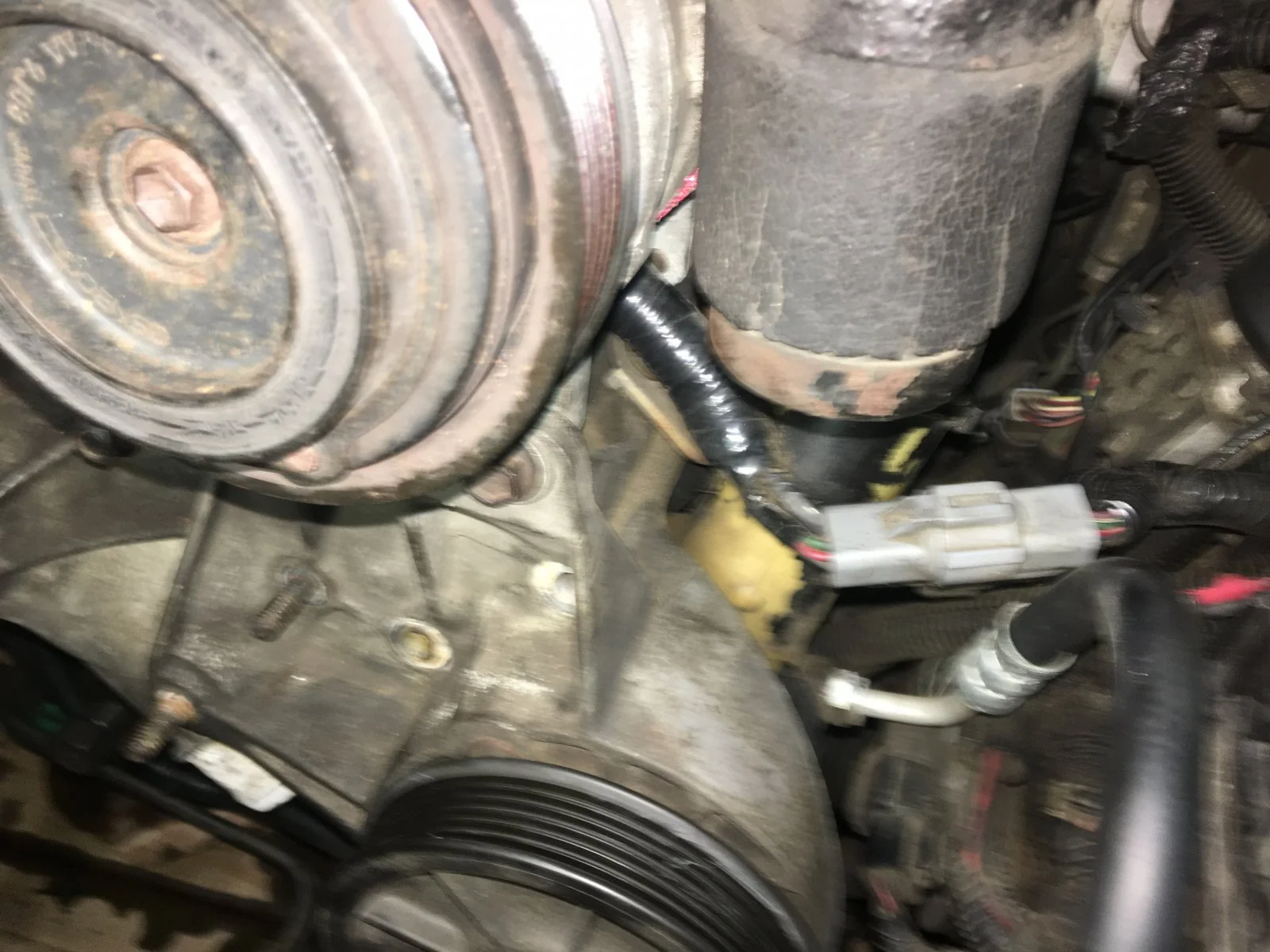

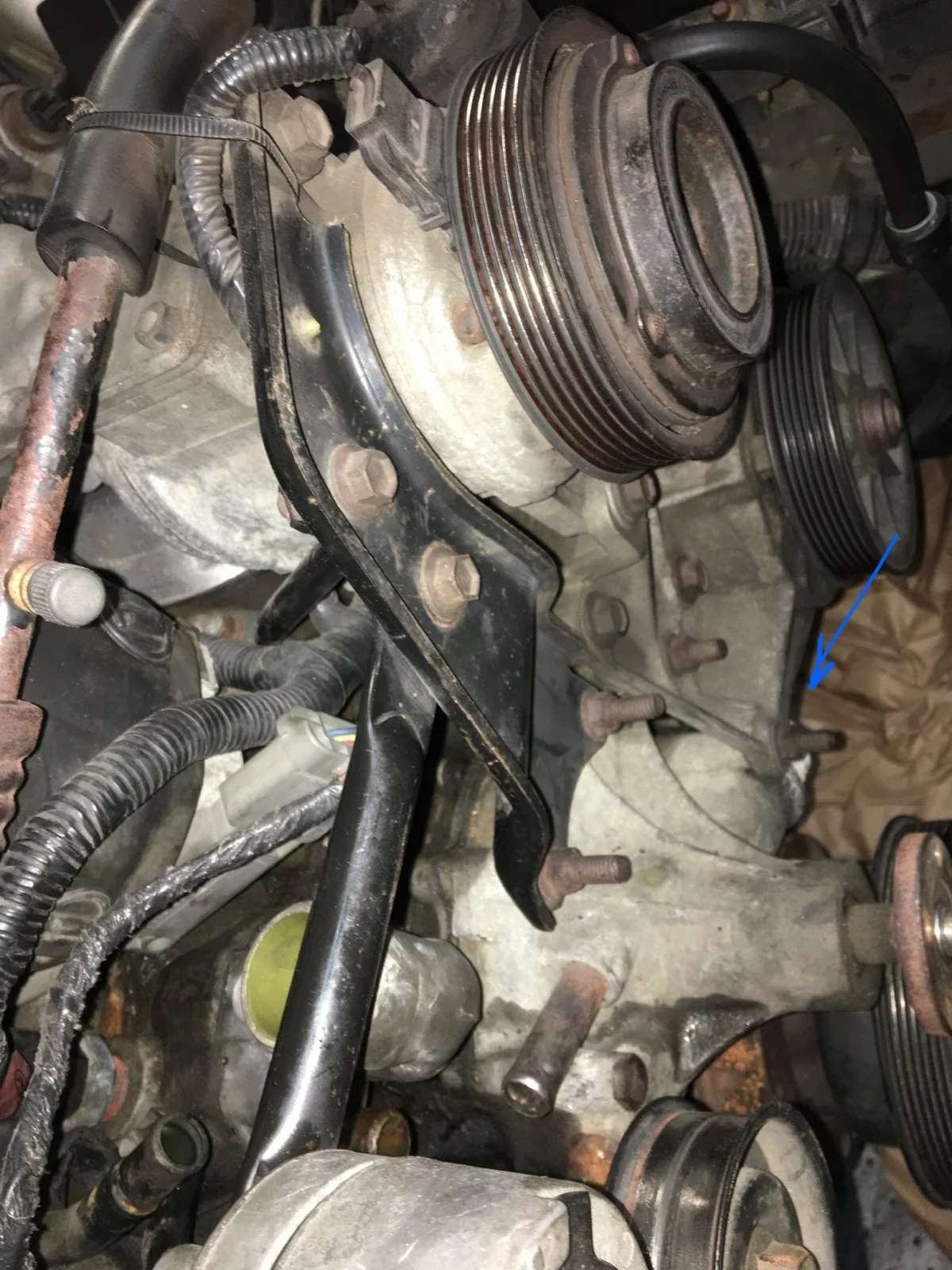

I ended up removing the PS pump completely and removed from the AC compressor which is currently suspended with a strap. There is no bracket like that on my car unfortunately. Definitely wish there was that’s for sure, wow that looks way easier. The power steering pump/ bracket is assembled to the pump and pulley. Whole thing had to come out to get the studs off the water pump. Seems you guys don’t have that on the stands unless later years. Bummed about that but it’s off now so I’m in for the long haul.
Have a manual I’ve had for 20 years and swear I was looking at it the other day too. Guess it grew legs can’t find it anywhere. Here’s a pic for both of you guys of the pump. 3 bolts hold it to the block and 2 attach the the longer water pump studs. Not the best pic.
Thanks again Olivethefet too
