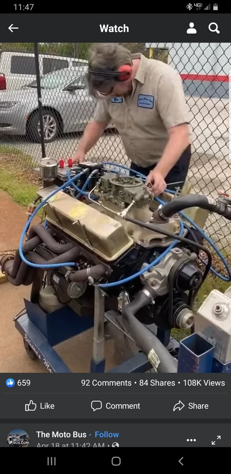

If the suction of the pump becomes more than the radiator can flow it will collapse the hose. Here's a screen shot of Ellisons Machine Shop running an engine they currently have for sale in Maryland. Look at that hose sucking in.
This guy is pretty awesome and shares a lot of knowledge. If you have FB join and watch some of his vids.
yeah that’s definitely no bueno! I probably just reuse the spring, thanks. Long as it comes out in one piece. Ha
