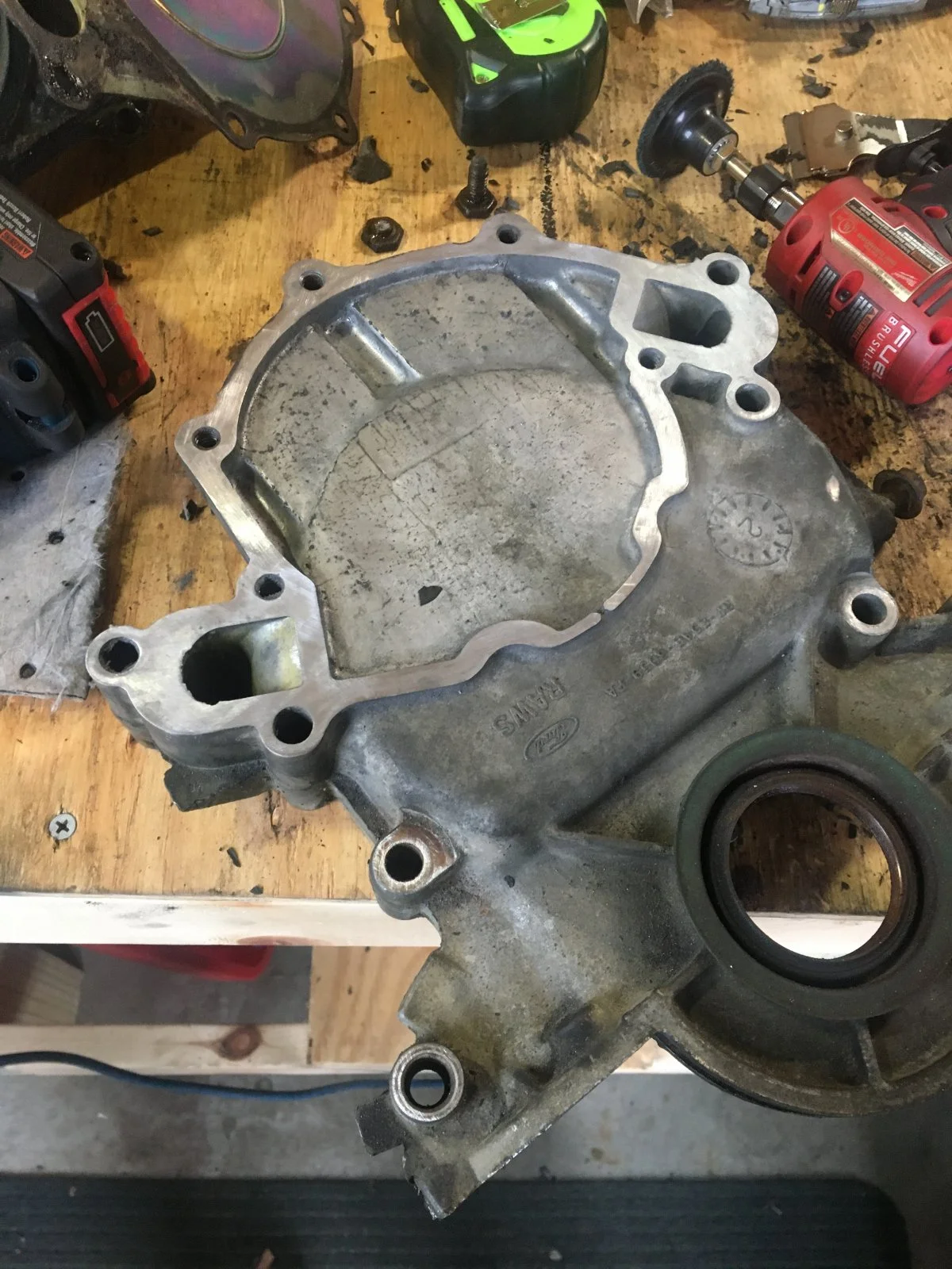

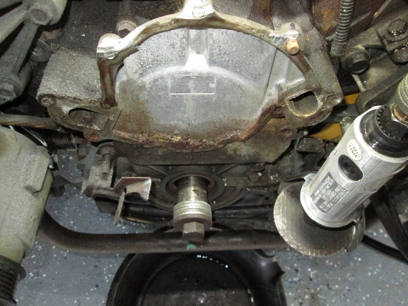

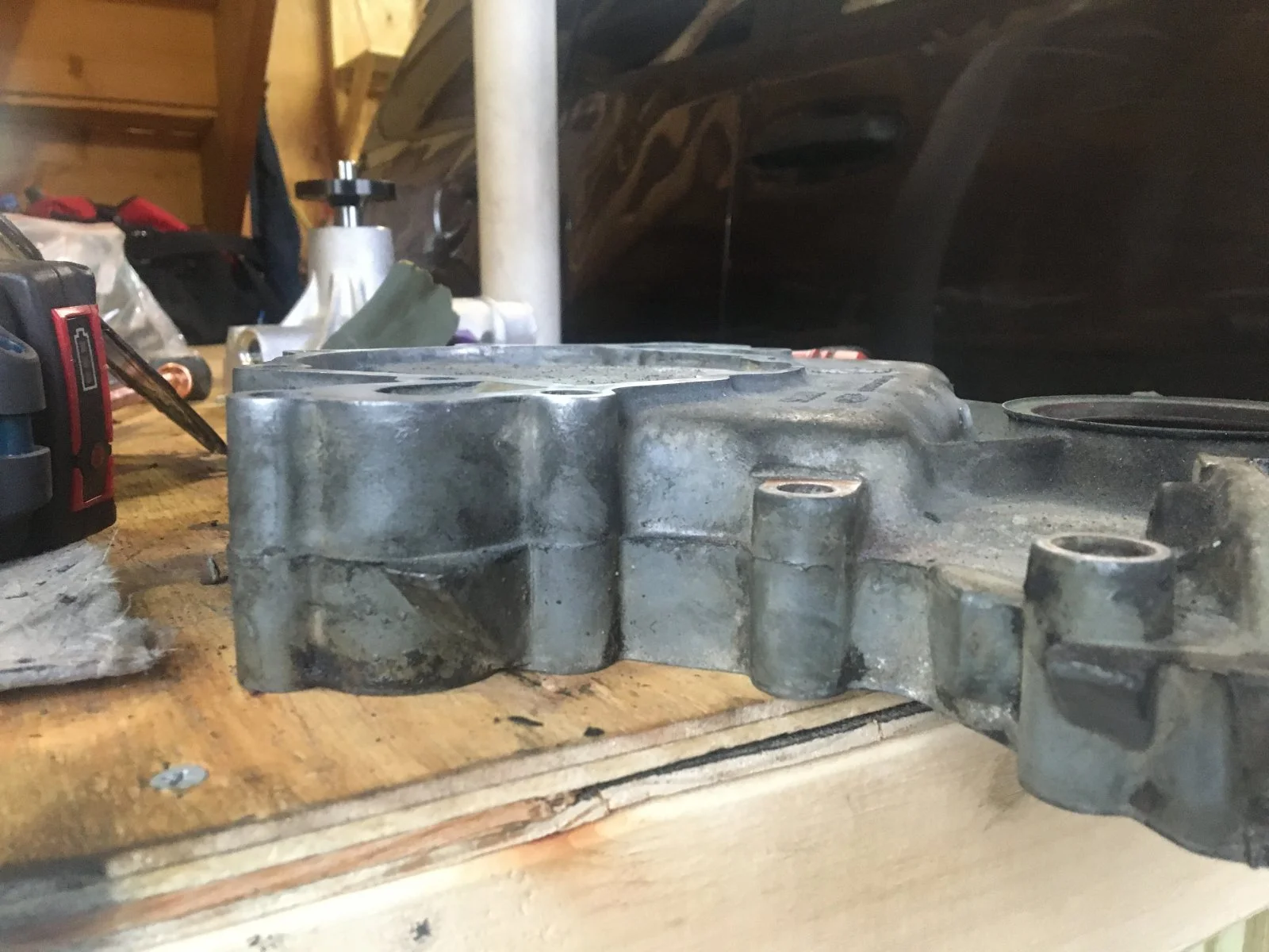

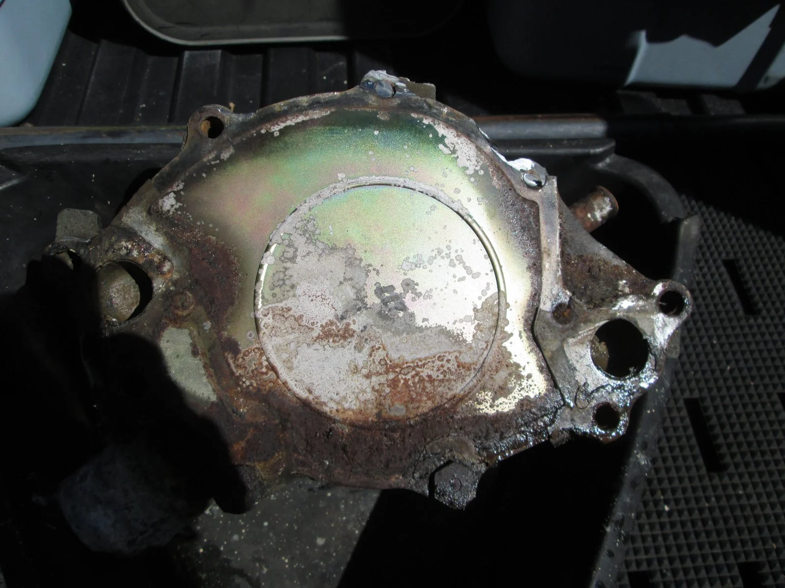

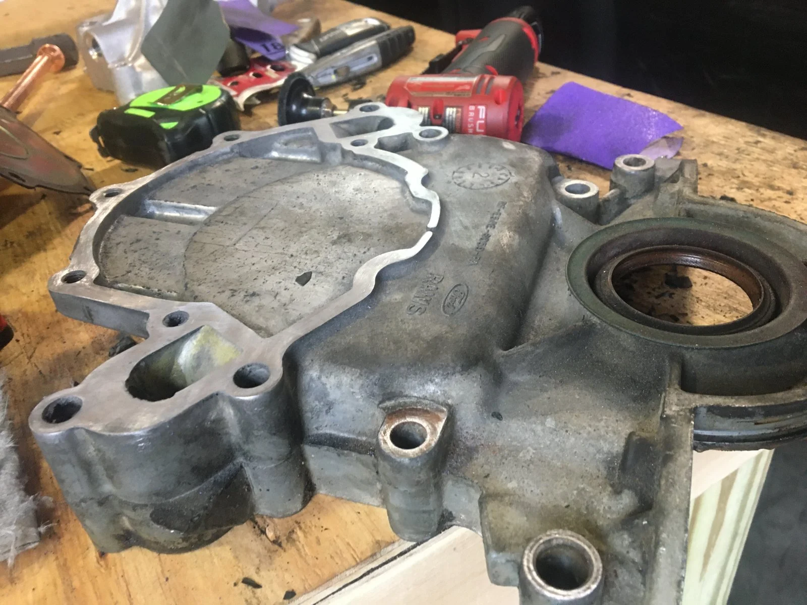

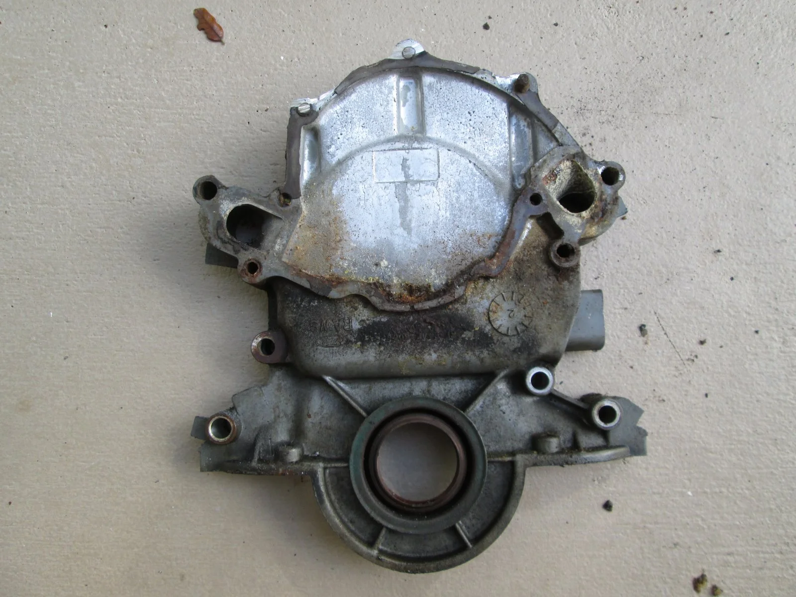

Wondering if any of you guys have reused the timing cover after cleaning. Starting to think i should have just dropped for a new one. Cleaning the hell out of it more than once. Can’t stand paper gaskets.

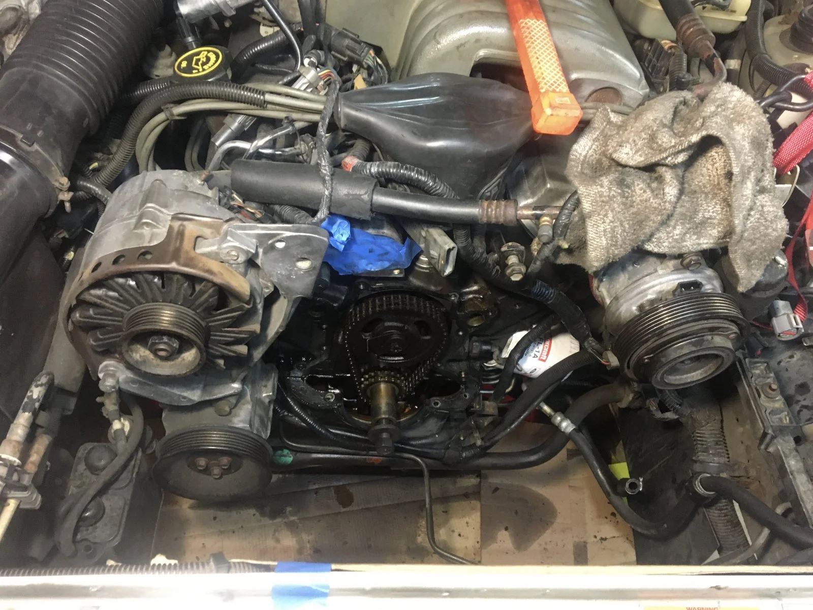

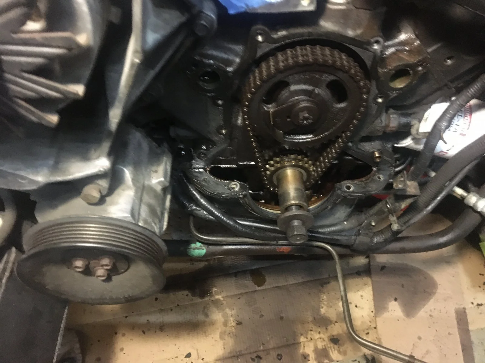

Current status...

No need for a new cover unless there is something wrong with it. I just went through this. I've changed these before but this time I had issues with water leaking into the oil. Solution was to clean the ever loving christ out of it and not be stingy with the RTV. I'm not talking gooped on, but I coated the gasket and put a film on the block and cover. Then let it sit for a bit and bolted it up. Seems to have worked so far. At least I dont have water in my oil.

Water in oil is no bueno. Yeah don’t really want to do this again. Wishing I just bought the chain. Was going to reuse the cover but I’m just going to order one now. Cleaned the hell out of it but don’t want to do this again for a while. Slight pitting, maybe from cavitation/age. Meaning gasket surface. Have other projects lined up. Trying to get SN95 coil over upfront. New rear control arms, uppers/lowers, but need custom or Tbird since mine are 1” longer than a stang. Finally attach the SN95 sway bar, but waiting to another response from maximum motorsports since my rear shocks are 3.5” longer and it will mess up the droop travel. Anyway, don’t want to put it back together and risk it.
and yeah, when I was younger I made the mistake of too much RTV. Thin coat should do. Got the water pump/thermostat specific and also old school gasket shelack which worked well for my thermostat last time. Considering it. I’ve seen some guys coat the whole gasket super thin.
It's electrolysis that eats the cover and bolts. Some anti seize and rtv takes care for it for the most part.

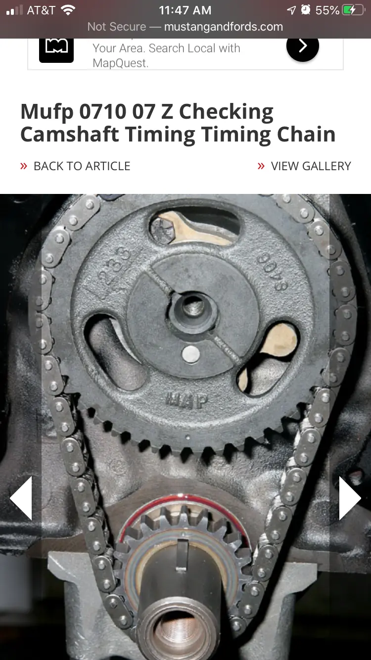

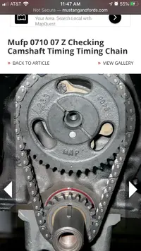

Now that I’m in there I’m deciding to do the chain. The main question I have on this is: I’ve already dissasblemed everything besides the chain and my timing marks are not at TDC.
a. Should I rotate the crank by hand and get to the tdc ? (see photo below) which is from the internet. (Showing alignment) cam at 6 and crank at 12
B. Will I damage anything I’d I do rotate the motor by hand? Should I put her in neutral?
c. Or, when installing the new chain can I align it exactly as is, ie not atTDC. I would much rather align TDC if A And B are possible.
I’ve read much on this and just need some clarification. Don’t see why I can’t align at TDC then proceed, which is definitely how I would rather do this. (Again, I’m 2 degree advanced timing and I know these run at 10 degree which puts me at 12 degree advanced all around) I do not Think that will affect TDC since TDC is TDC. I know this was supposed to be cooling system post, but I’m in too far now to NOT do this.

Your timing cover is fine, reuse it.
Get a set of Felpro gaskets & a tube of Permatex Super High Tack Gasket Sealant to hold the gaskets in place.
Also got a tube of Permatex Red RTV High Temp Gasket Maker to put in the corners.
You'll hardly use any of the Permatex tubes; I have enough remaining to do 10-20 water pumps.
I was able to reuse the original oil pan rubber gasket. Don't cut the front away & don't use the 3 pieces that come with the gasket kit.
Stuff old rags all around the chain to keep the gasket scrapings from getting into the oil pan.
We just dropped the oil pan just enough to get the timing chain cover on.
When all done, drain the existing oil in case any bits of gasket got into it.
Put cheap oil in, run to temp, check for water leaks, then drain oil & refill with good oil.

Thanks, think you read my mind on some of this. Done enough gaskets to know not to use too much rtv. More so on other cars. And I’ve found it good practice to do the corners for sure. Again thanks. I did go with the Felpro kit as well. Not feeling the corner piece gaskets. An I definitely will be flushing as much as I can from that oil pan while I’m at it.

BTW, your chain looks good. There is a backlash spec, don't remember it right now. Can look it up if you need it.

After lining it back up there’s less slack. I saw .50 of an inch for the slack. Wishing I knew to Check the slack degrees the before I took it as part. Oh well. Just read up on that.
