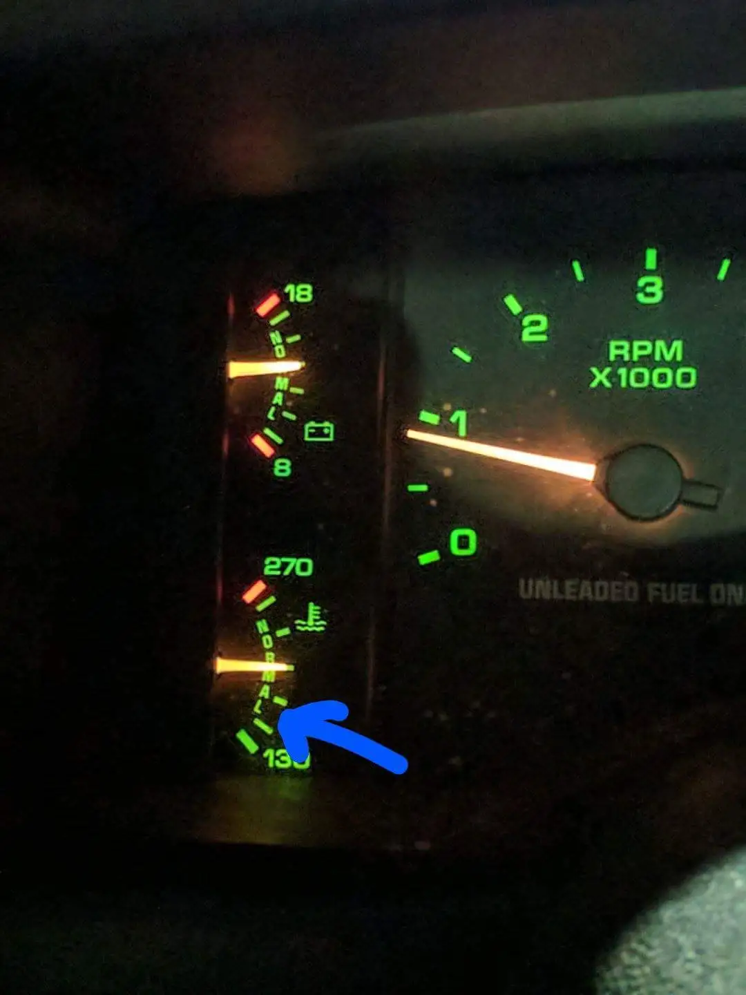

Next question, my car runs extremely cool, summer, winter, short trips, long trips (2hrs) unless I'm idling for an extended period of time(NY traffic, drive thru) is my thermostat not working properly? When the temperature does go up during long traffic and drive thrus it goes up to about half way. The second I start moving again it drops down (pic attached below, arrow is where it normally sits while driving, what the gauge is it, is where it is when it idles for an extended period of time (5-10mins))

2. While you are replacing the radiator hoses and heater core hoses go ahead and do the thermostat. Most likely it is stuck open or non-existant.

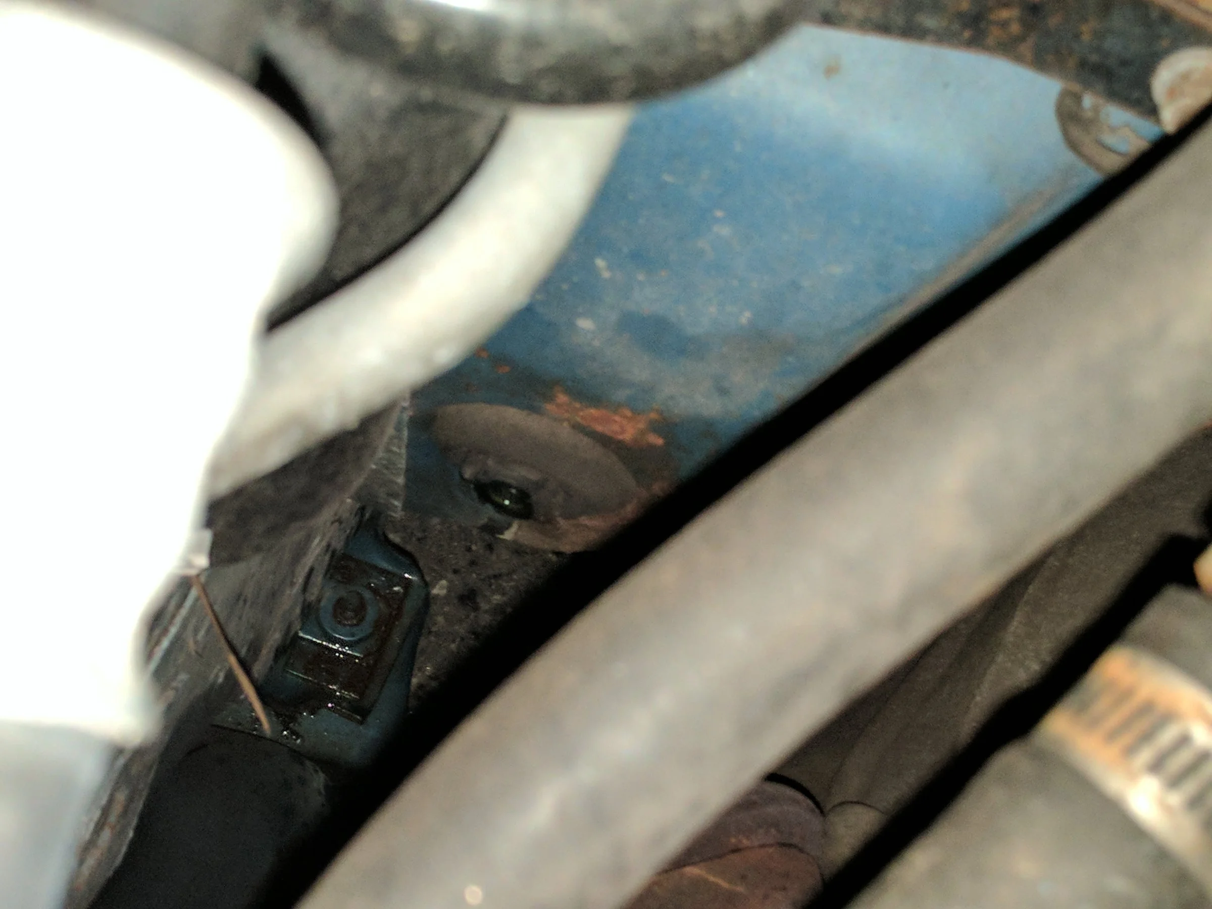

Been driving it the last few weeks and when I'd turn the heat on to see if it smelt look coolant it reeled and typically left a puddle under the car , tonight it smelled for a minute and went away. Heat still blows really hot but my defroster isn't defrosting the window at all. And sometimes my car has no puddle of coolant under it, but this is where it's leaking from.

My first post will fix all your problems.

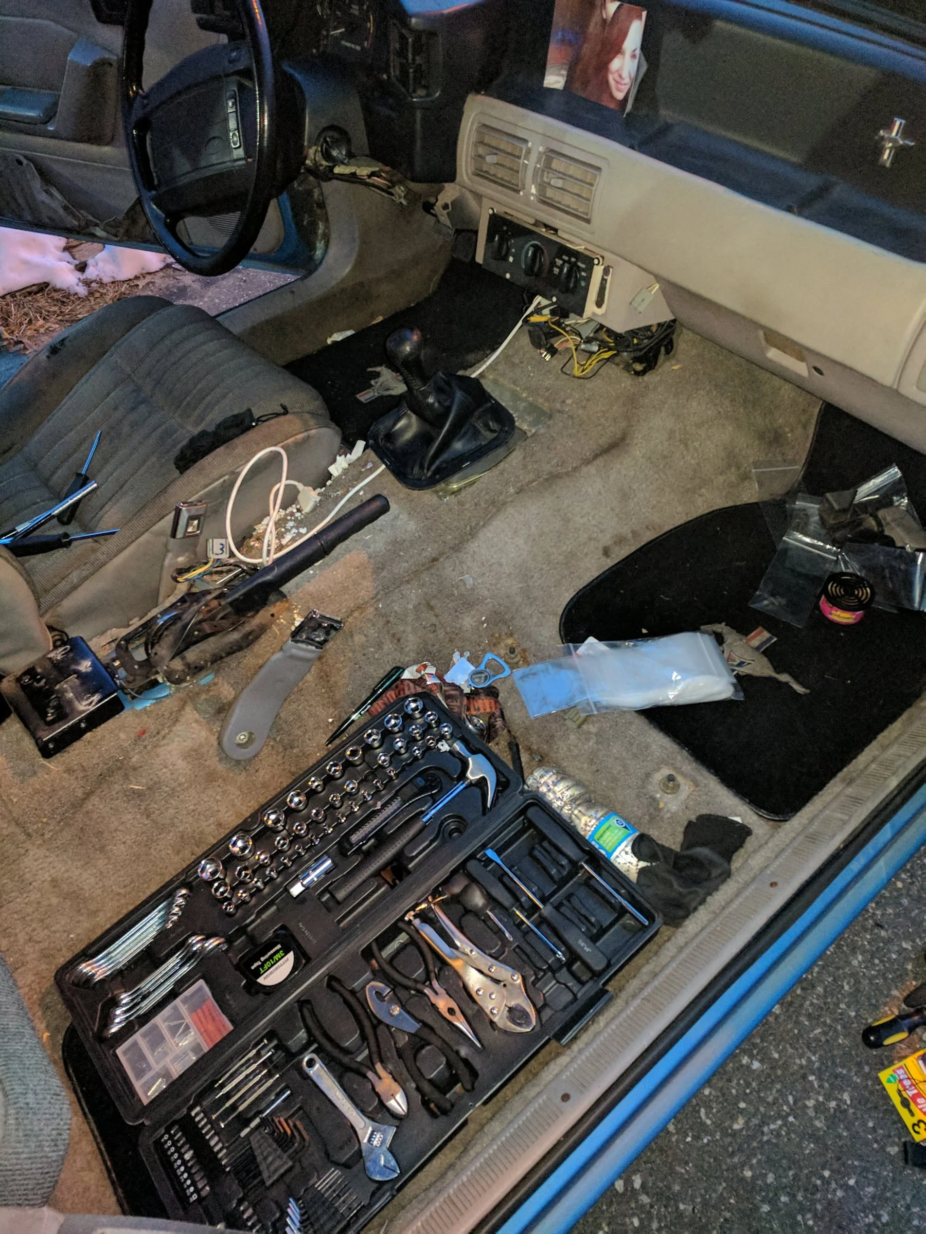

Already started pulling everything apart and labeling everything, heater core is coming in mail tomorrow. Pulled out seats and center console to make life easier. I want this to go as smoothly as possible being it's my daily driver. Thanks again
