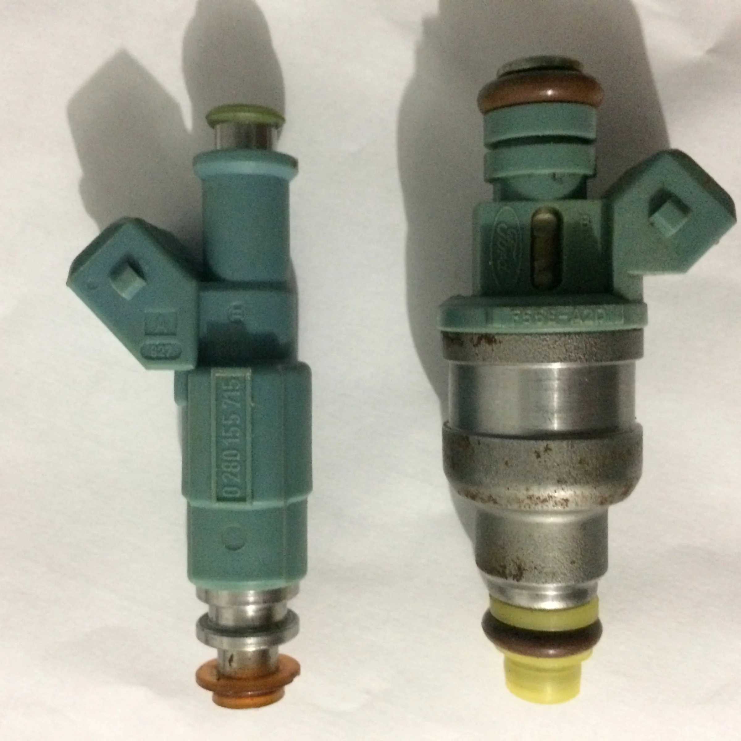

On the 24 lbs injectors upgrade which ones do you guys preferred, or doesn't matter?
I hear the some people have clearance issues with the adapters you need to run the style injector on the left. The fatter injector on the right is the stock 5.0 style and that's what I have (although mine are Bosch 30#). You'll need a matching MAF programmed to run 24# injectors FYI.
Thank a FoxMustangLvr!!
No adapters are necessary, same plug type as the ones I'm running right now, but bay I'll run the fat ones and yes I need a MAF calibrated for that.

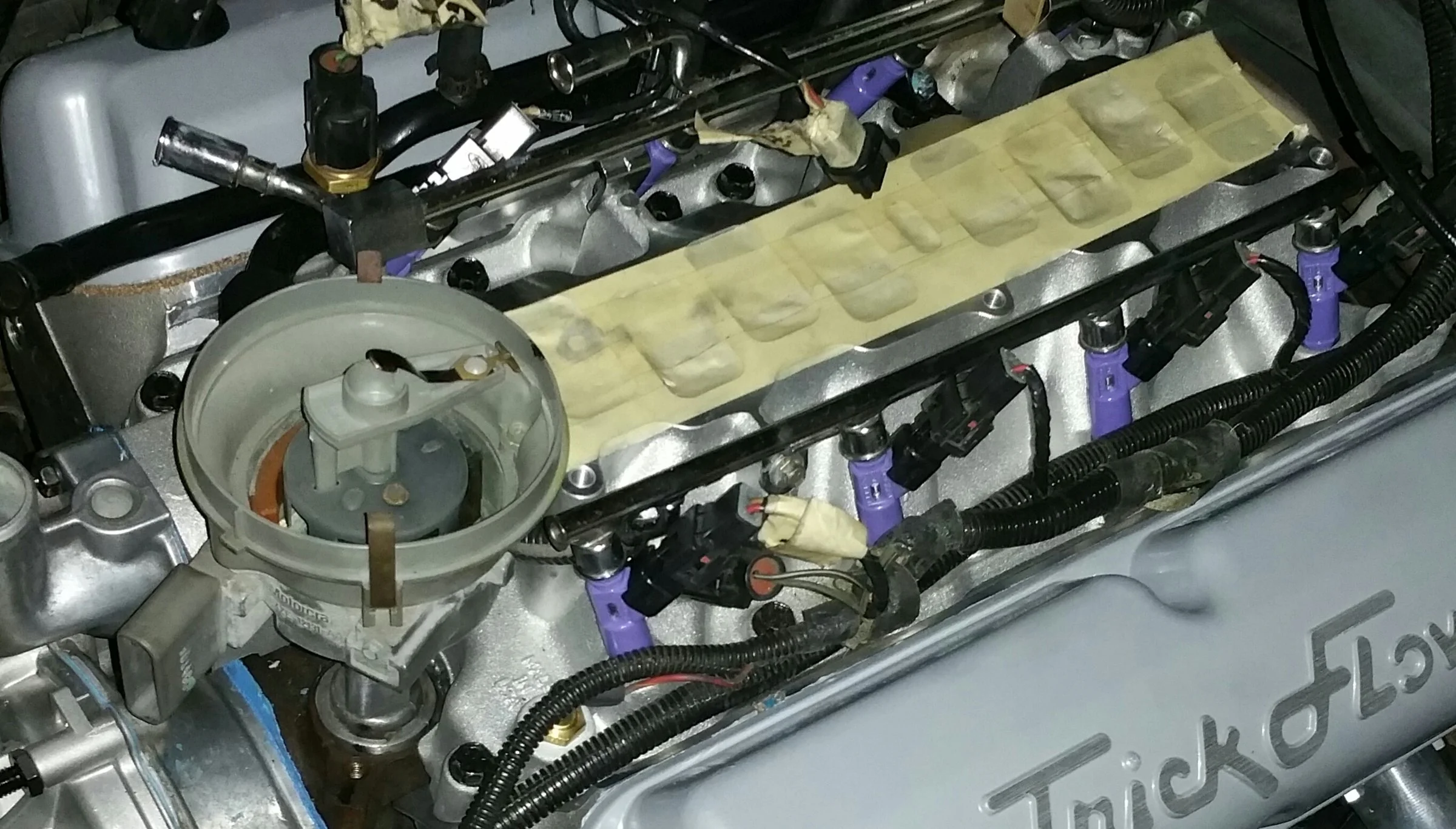

Is that a filter of some sort from the oil fill to the trottlebody ? Did you have oil in the throttle body ? Just curious since I'm in the Trick Flow boat too.
Jersey Joe, you are correct, that little filter is the one used on carburetors.
I had some clearance issues with my rollers hitting the oil baffle on the passenger side valve cover so I grounded it off and some oil mist started going up to the TB. I cut a stainless steel mesh and placed it at the bottom of the oil filler, plus I placed that little filter before the TB. and it works nice, no crap in there and keeps it clean.
also I have an oil separator on the hose coming out of the PCV valve, and yes it keeps the intake cleaner than without it. YY
