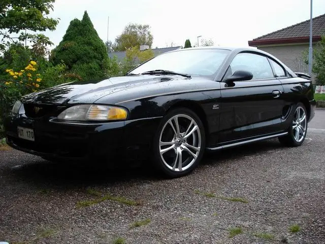

Hey all,
Got myself a -94 GT that´s gone 76´
It´s a really nice car (only had Trans Am´s before) and really like the model. BUT, it´s really thirsty. I´ve done a complete overhaul replacing oils, sparkplugs (R42TS), wires and set base timing. I found lots of vacuumleaks too and therefor replaced all the plenum/tb gaskets. And still it drains the tank quicker than my 700hp Turbo Trans AM :notnice: Oh, and I´ve also replaced the fuelfilter.
I also have some problems with my steering. I´ve made a bunch of search for it. Maybe I´m searching with the wrong keyword.
1st; it feels very instable in all speed. I slightly have to steer against it to the right.
2nd; if I stand still (engine not running) and tries to turn the steeringwheel, it makes a strange squeek. Doesn´t matter what way I turn it.
3rd; if I change a lane, there´s a small "hop" in the wheel. It´s not every time, but almost.
I have checked that rubber joint next to the header, but it looks ok and doesn´t feel play.
The former owner said he had to replace something during this spring. But he couldn´t specify what, but it had to do with the steering. He had installed Steeda Sportsprings, but swore he made an alignment of the wheels afterwards. I was planning to do that myself, but want to get rid of the other problems with the steering first.
Any good ideas are highly apreciated.
Thanks in advance
/Andreas

I paid $38 a piece I think at Napa for O2 sensors, so at least it's not too expensive if they're bad. Nice looking car btw, I like the wheels. :nice: Similar looking to some I found on Ebay, but ended up with chrome Y2K Cobras instead.

Thanks man. I´ve had to fix lots of things on it and the paint wasn´t too good looking. But a couple of hours rubbing and waxing got it really nice looking. And those wheels did quit good on the Mustang :nice:
