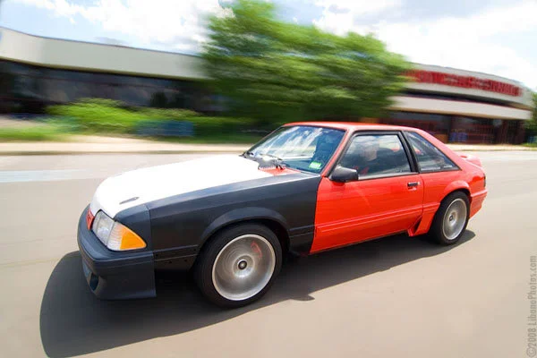

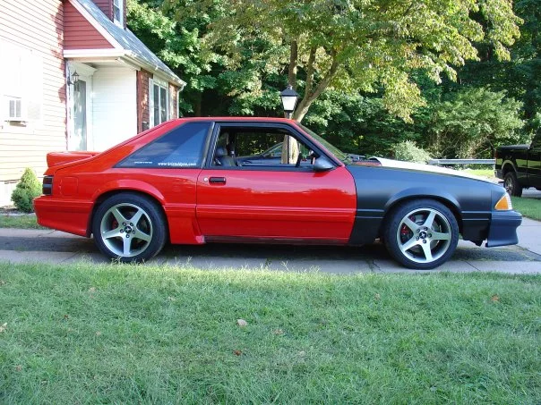

Im running OEM 03 Cobra wheels on an 94-98 spec rear axle, the specs on the wheels are 26mm offset, with a 6.12" backspace. I did need to roll the rear fenders with the 275 series tire. It wasn't much clearance needed, but it was enough to cut up the sidewall a little, most people dont even notice it on the tires though.
More info:

Here are the most recent, forgive the lack of paint. All the extra cash is going to pay for a wedding, so the car is a little on the back burner these days.
Thats cool, my Dart is three colors too. Car looks great with the Cobra's. I see you have Aerocatches also. I just got a set. Have to work up the nerve to cut my CF hood though.
