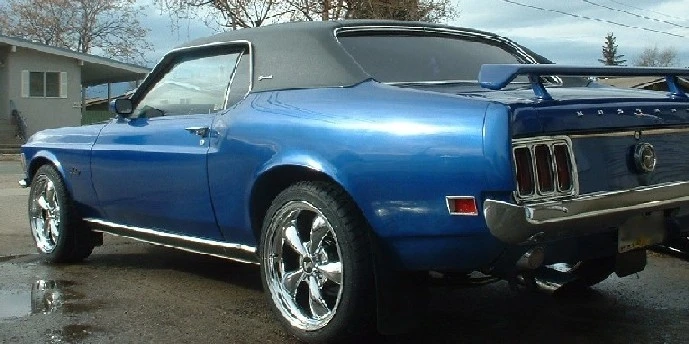

OK, here's a pic of the 70 with 18" chrome bullit's.
rims are 18"x9", tires are 245/40/18's
Picture was taken of the car at factory ride height. I'm in the process of lowering her about 1.5"

cool.... now those were a 5.95 b/s and a 1" spacer? 1.25?
Yes, there is 5" of backspacing (5.95b/s with 1" spacer).
However, I think a little more backspacing would be better. 5.5" would be best IMHO. I had a hard time finding spacers less than 1" and when I did find them everyone wanted a premium. So eventually I just bought some cheap 1" spacers locally...
Rears would have worked fine with the 6" of backspacing. It's only the fronts that needed spacers, and you could probably get by with only a .25" spacer on the fronts.
