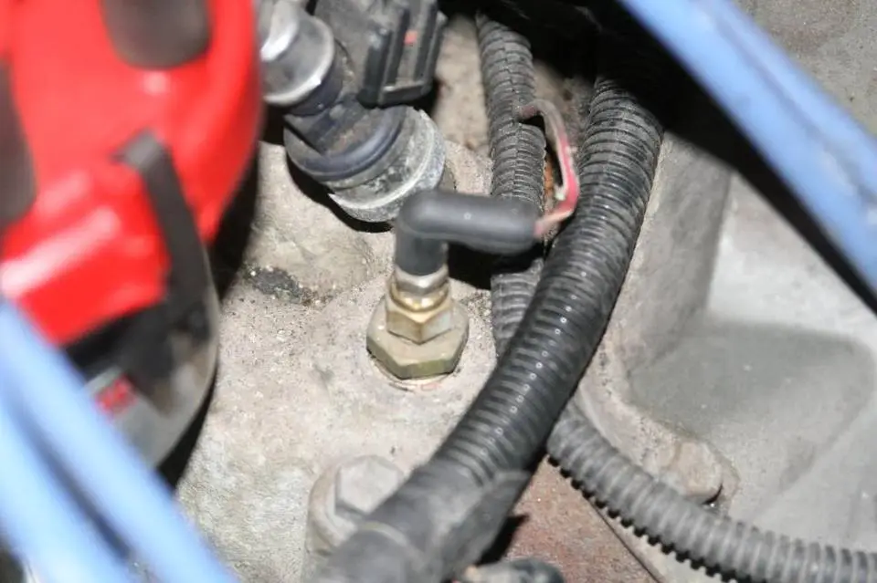

Is the gauge cluster temp sensor the one that's at the front of the intake? the one that has threads but nothing threads on just a slip/push single wire connector that has a 90degree beand in it?
i r not sure.
temp sensor
