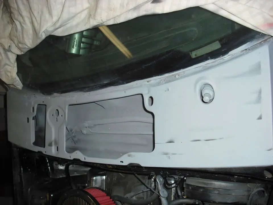

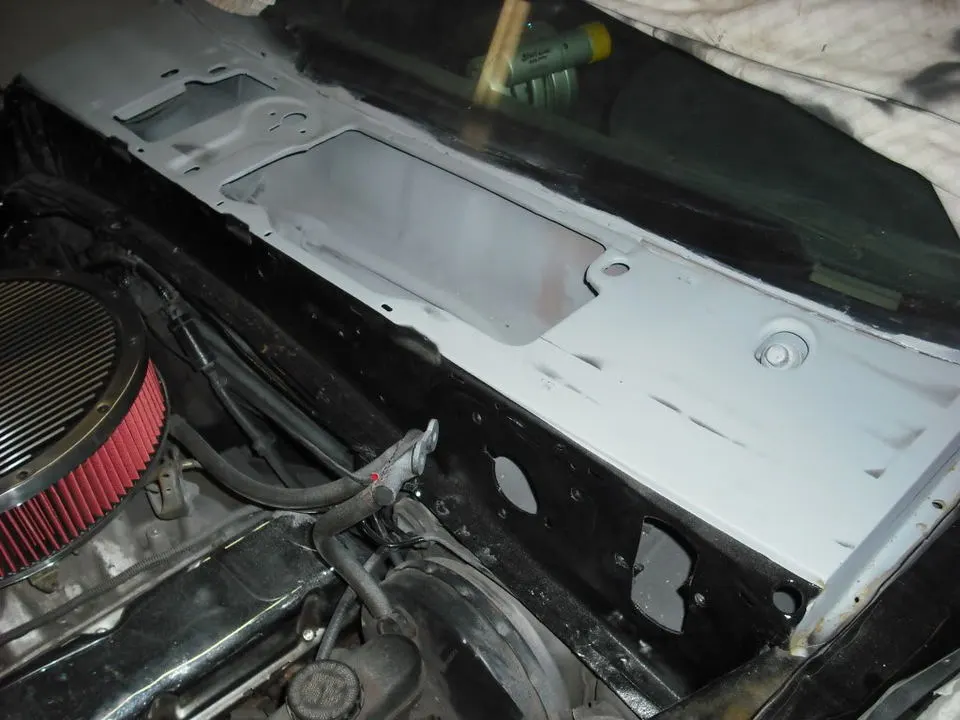

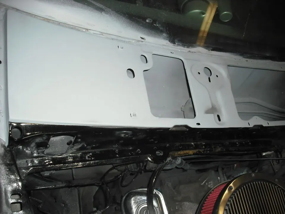

Cowl removal progress thread
Got some more work done on the cowl finally, weldin in the cowl where the spot welds were drilled, the cowls pretty much ready for paint now, been busy doin the rest of the body work on the car.

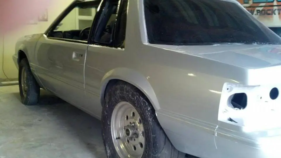

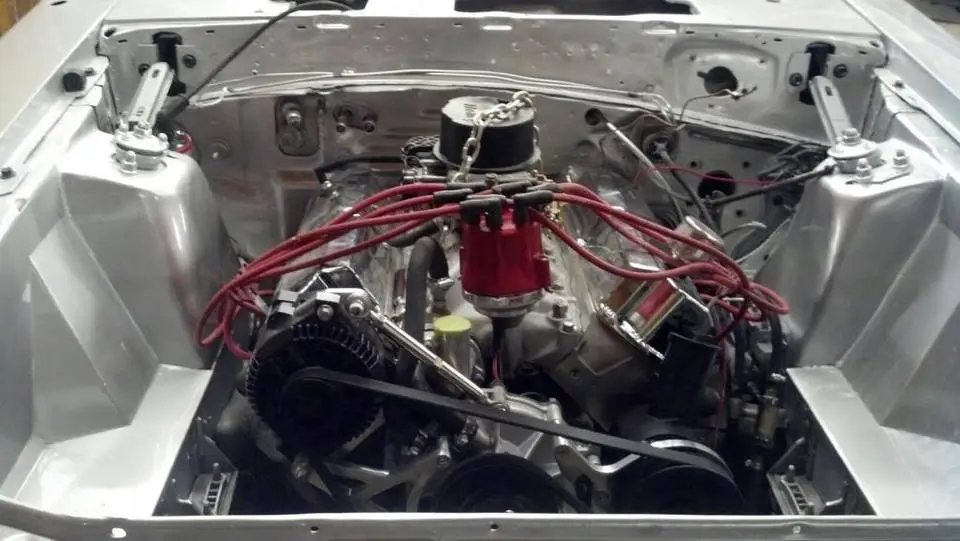

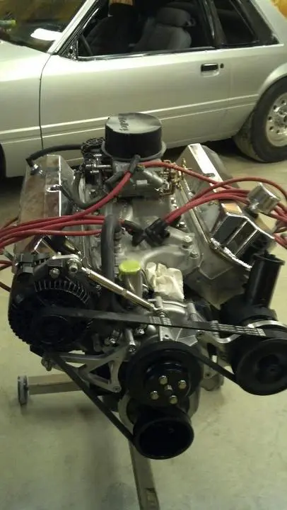

He didn't lose interest. Life gets in the way sometimes. Then we found a good deal on a 347 stroker so money went to that. The motor should be together soon and then it's back to body work.
If the powerplant doesn't come first then your priorities are ****ed up.
Yep, lost interest in it for sure. Or maybe now it's got an awesome fresh paint job and a running 347.

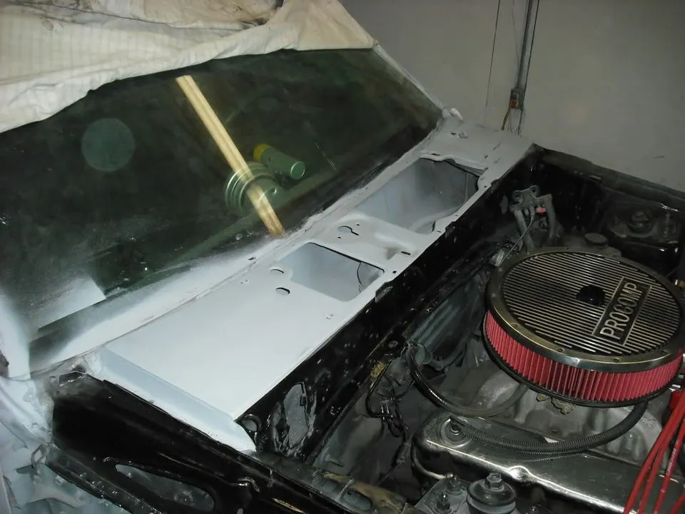

OK,...you should know I'd be the one to ask this, so consider the source.
It looks to me like somebody spent a whole bunch of time filling and smoothing and the fender aprons and strut towers, and spent <3 minutes on the firewall.
Seriously, you had the the entire engine out of it and didn't block off the A/C or heater hose ports?:scratch:
And your poor brake lines look like they're having a really BAD hair day.
It's the little things...........

Yes, he is going to use a cover, and he is not completely done with everything in the bay yet. That was right after dropping it in. Just because the pics are posted doesn't mean it's done.
Oh, and he didn't block off the heater and evap ports because he plans on putting A/C back in the car.

My limited experience from a hundred years ago, back when they made wooden cowels, was to cut more than what you need, they didn't take the windshield out and butt welded that edge. And remember hot slag from welding pits glass so cover it up good

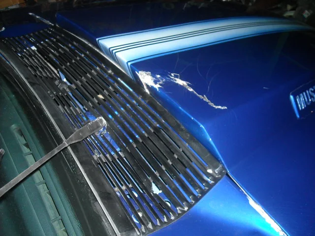

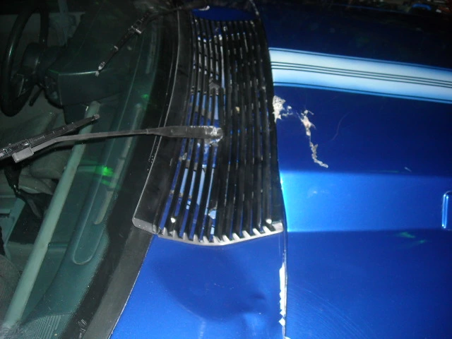

I have the same problem but I'm going to try the bodywork method. You did a great job though, it looks good. What happened to your hood?
Those raised cowl hoods can sure do some damage, that rear edge lands right on the wiper end. Ouch!!!!
