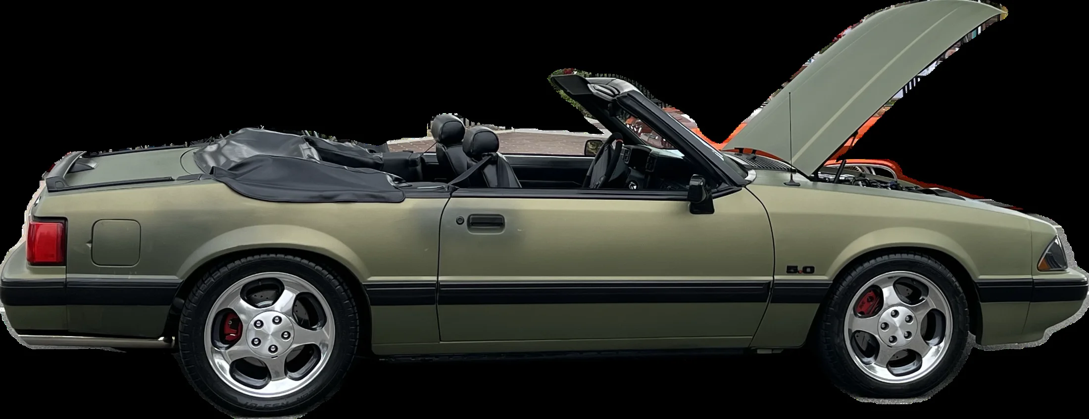

Hi All, I live in Kalifornisky (CA) and looking for some help. Do any of you know who can do a Coyote swap for me with everything legal?
i have a 1991 Fox Vert that i would like to swap over to a Coyote?
thanks!
