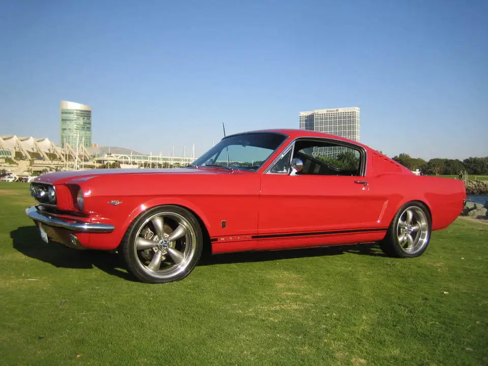

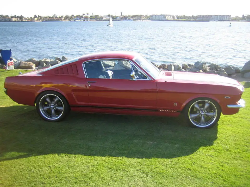

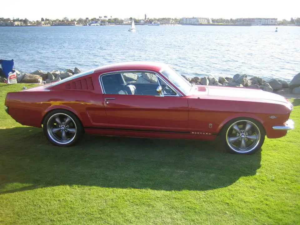

Mine are Coy's and I liked that they had:
-Flat lip from edge to spokes (TT II have an extra lip hump)
-Valve stem behind spoke, off lip
-No problems with my wheels.
Front: 18x7 4.50 Backspacing - BF G Force 225/40/18
Coils were cut, fenders not rolled, very minor rubbing on front left on hard turns
Rear: 18x8 4.75 Backspacing - BF G Force 245/40/18
mid eye springs, attempted to roll rear quarter lip - some rubbing on hard dips, rear disks may have caused the wheel to be out more than a drum brake

Your pictures look a lot better than the ones on their website. The ones on their site make them look bad. Does the center cap have their logo? Are those the gunmetal?

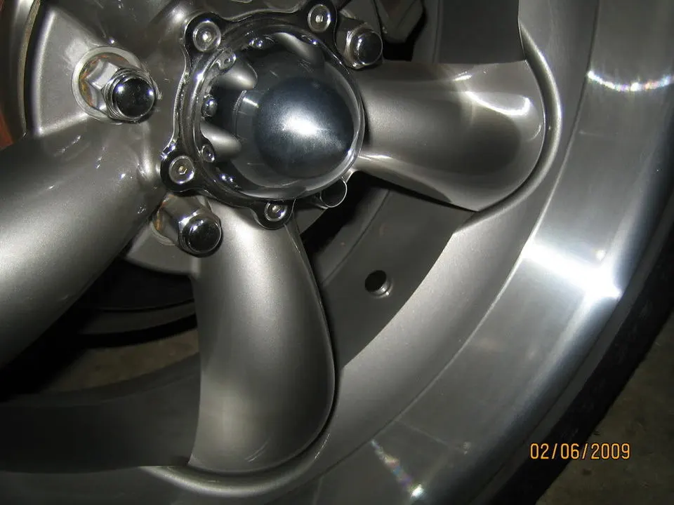

Through Coy's, I upgraded the center caps to their bullet style. It was another $50 for all four. Each wheel did come with lug nuts, valve stems, and caps with their logo. But I am not crazy about logos and I have seen their logo wear off. I was Charged $100 for shipping to San Diego, CA.
My color is gunmetal. I did notice that Coy's now sells a flat black version of the C-5. Interesting. . .

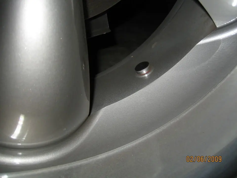

Here is a close up of my valve stems from Gorilla. After removing the cap a valve extension is used to air up the tire.
Here is close up of the bullet cap:
