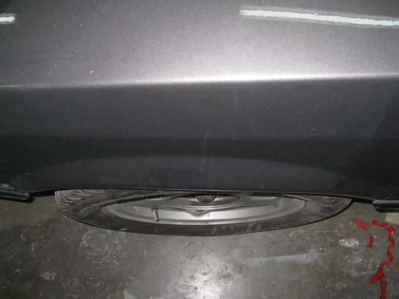

Alright, heres some photos to further demonstrate the problem. When I went back to the shop, I measured from the center of each hub front to back. The drivers side was 100", and the passenger side was 101.3", so theres a problem. Now how do I fix this problem?
Driver
Passenger
Is there a stock offset for the passenger side that I dont know about? Or did Ford make Ponies with different offsets? I need help guys. Thanks.
