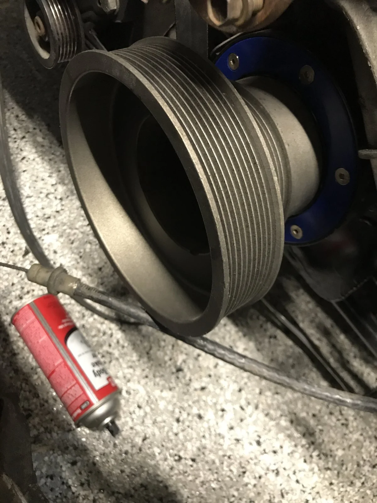

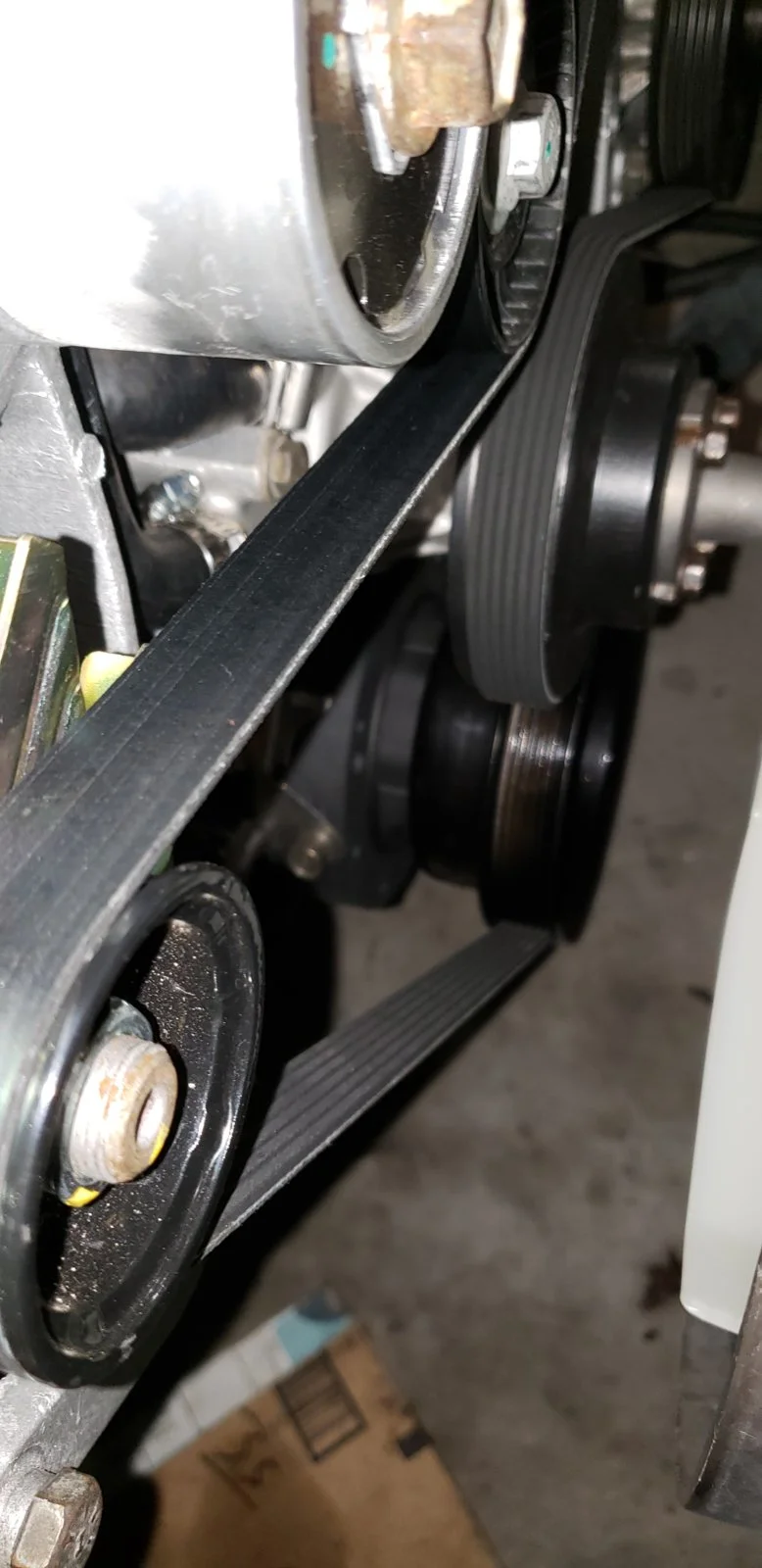

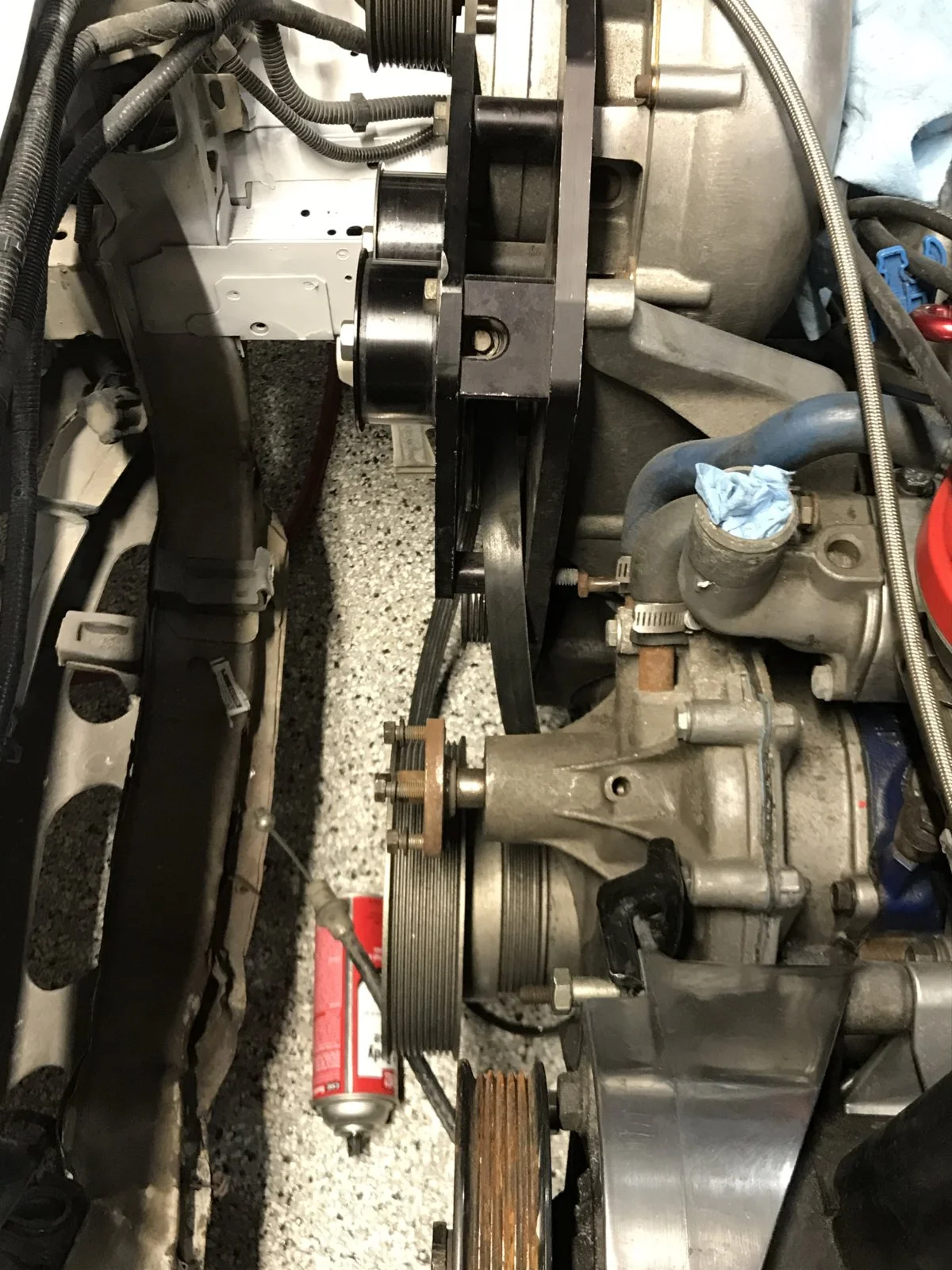

Just got my engine back and went to put the serpentine belt on and the crankshaft pulley doesn’t line up with everything. Just had a new harmonic balancer installed. Do I need a spacer?

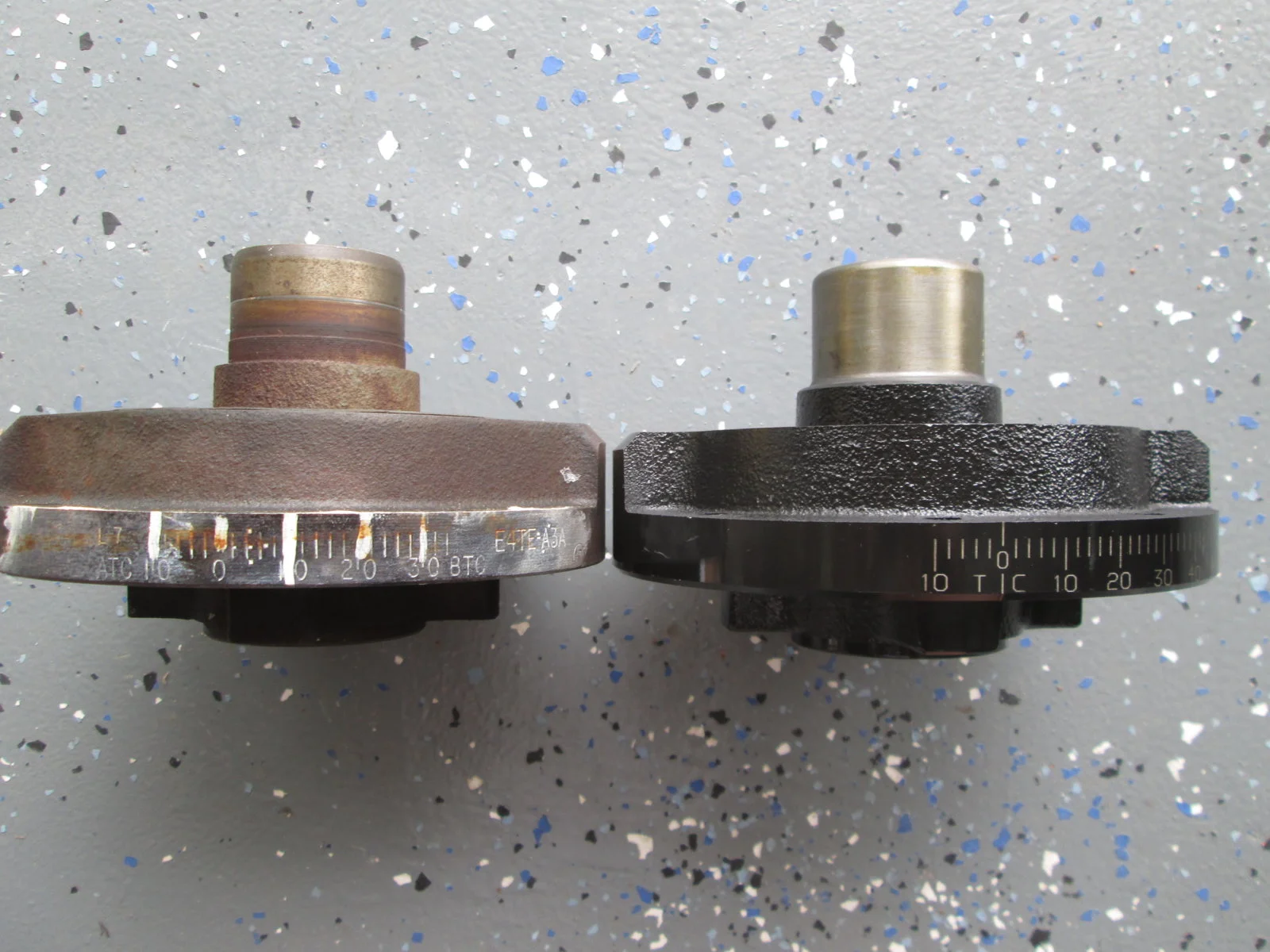

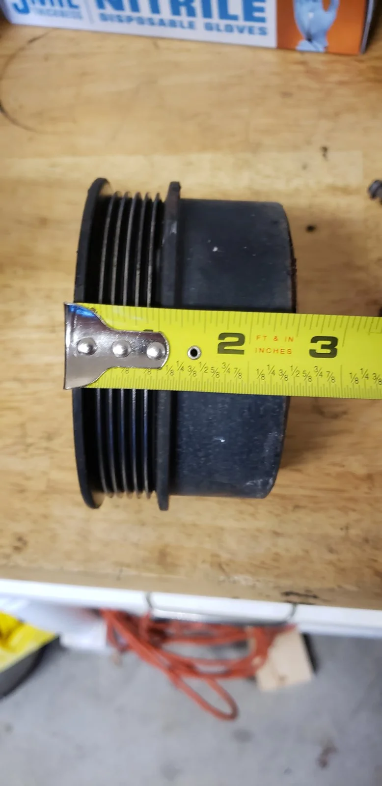

This is a pic of my crank pulley. It's just a standard fox 5.0 pulley. The other pic is of an under drive pulley. The overall depth of it should be the same. Your crank pulley doesn't look standard. Im no expert though!
There are spacers to accommodate the wide range of Ford dampers and pulleys and aftermarket stuff. Mock it up and measure for the spacer thickness.
