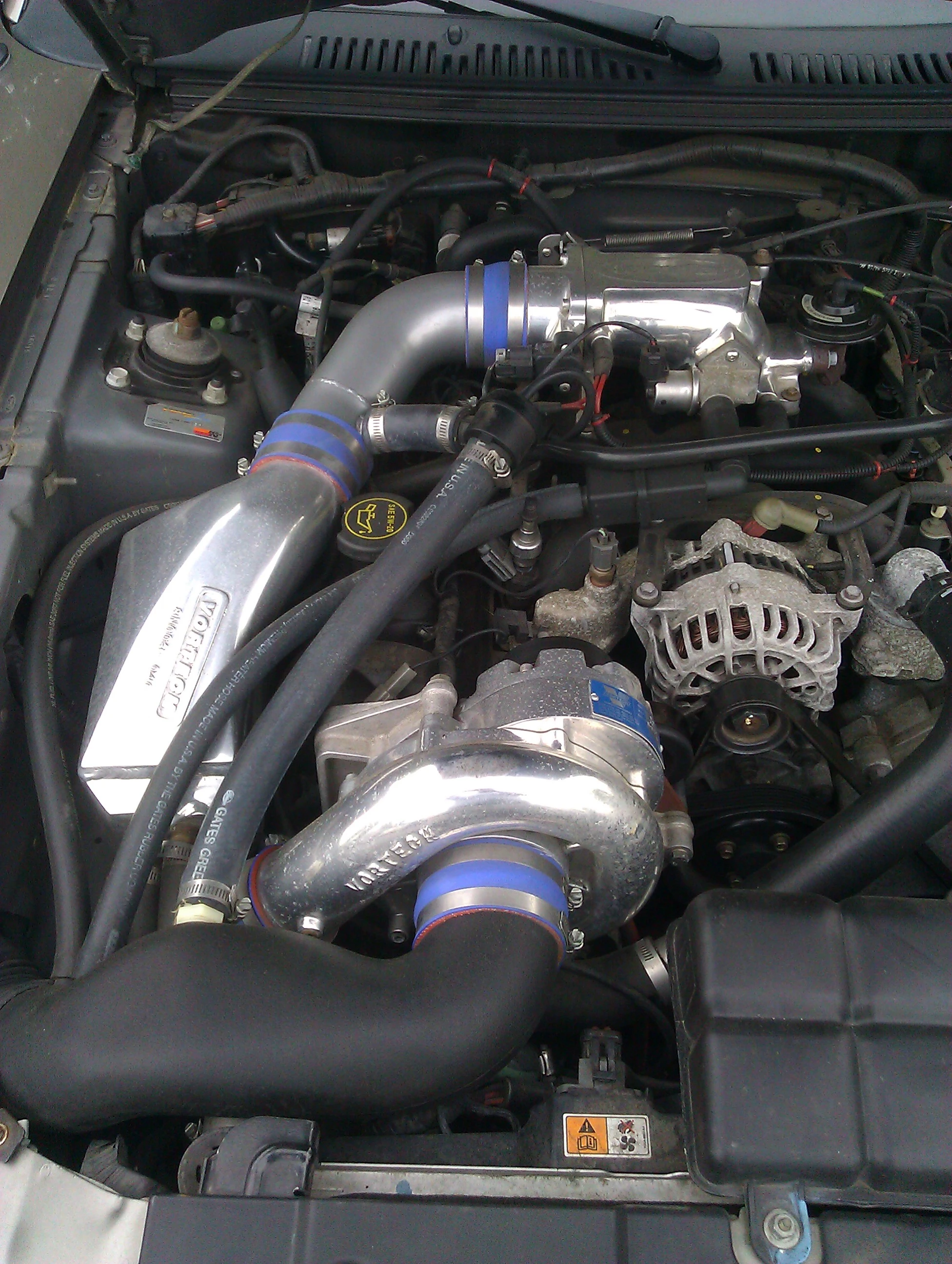

Here is a pic, let me know what else you would need.

If it is a V2, that means the supercharger is engine-oil lubricated, IIRC.
That looks like the out-of-the-box Vortech V2 kit. Aftercooled, fuel pump included, (probably fuel injectors included), tune included, etc. Nothing at all wrong with it. Probably somewhere in the neighborhood of 350-360 rwhp.
Better exhaust (offroad [non-catted] midpipe and/or long tube headers) and a custom dyno tune will go a long ways towards making more power. Those things should easily put you near or at 400 rwhp. A smaller supercharger pulley would easily put you over 400. Go small enough, and that unit will easily make more than enough power to scatter some rods and/or pistons. A front-mount intercooler (FMIC) would also yield some benefits, but probably not enough to justify the cost on a stock-bottom-end motor.
