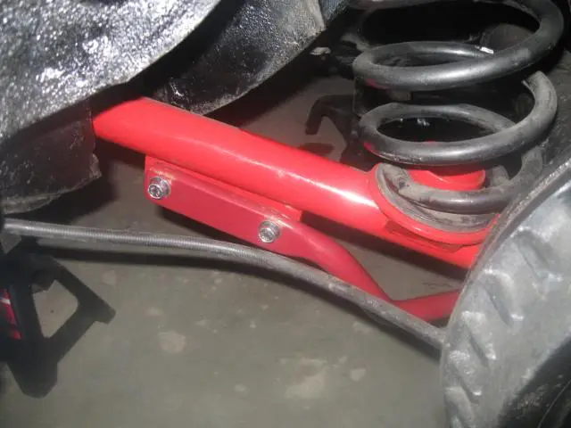

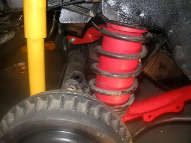

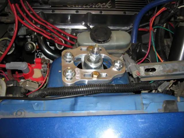

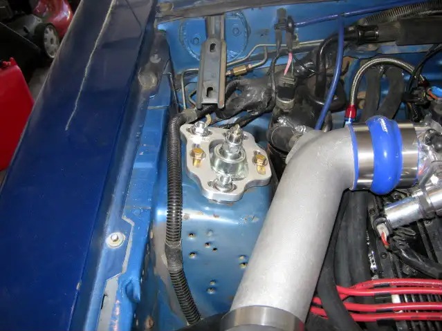

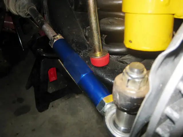

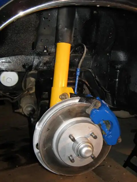

I know my setup isn't the best, but it has worked fantastic so far:
Eibach Pro Lowering Springs
Koni Yellow shocks/struts - 3 way adjustable, struts can be used as coil overs later
Eibach Front & Rear Sways
GMS Control Arms
UPR CC Plates
UPR Sub Frame Connectors
UPR Bump-steer kit
