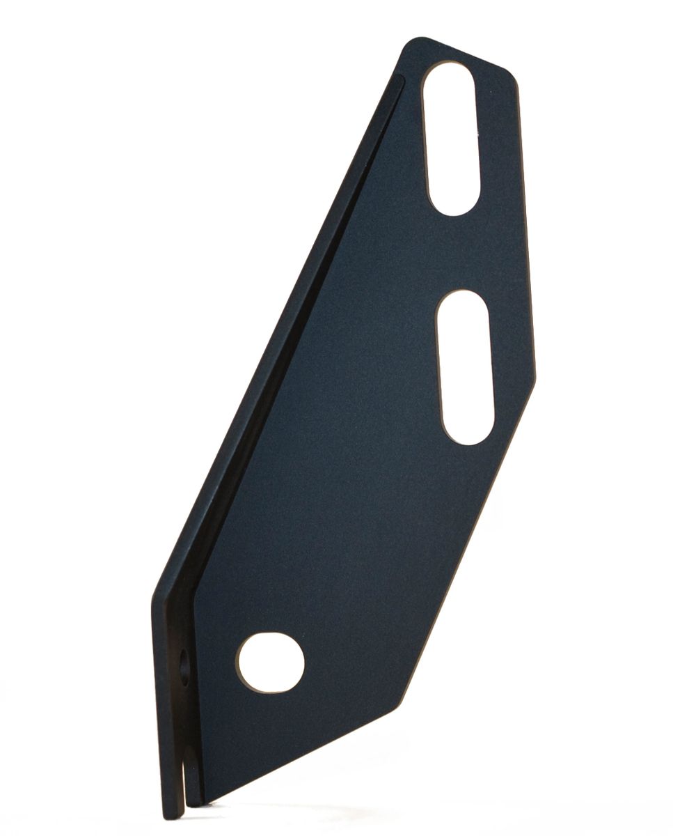

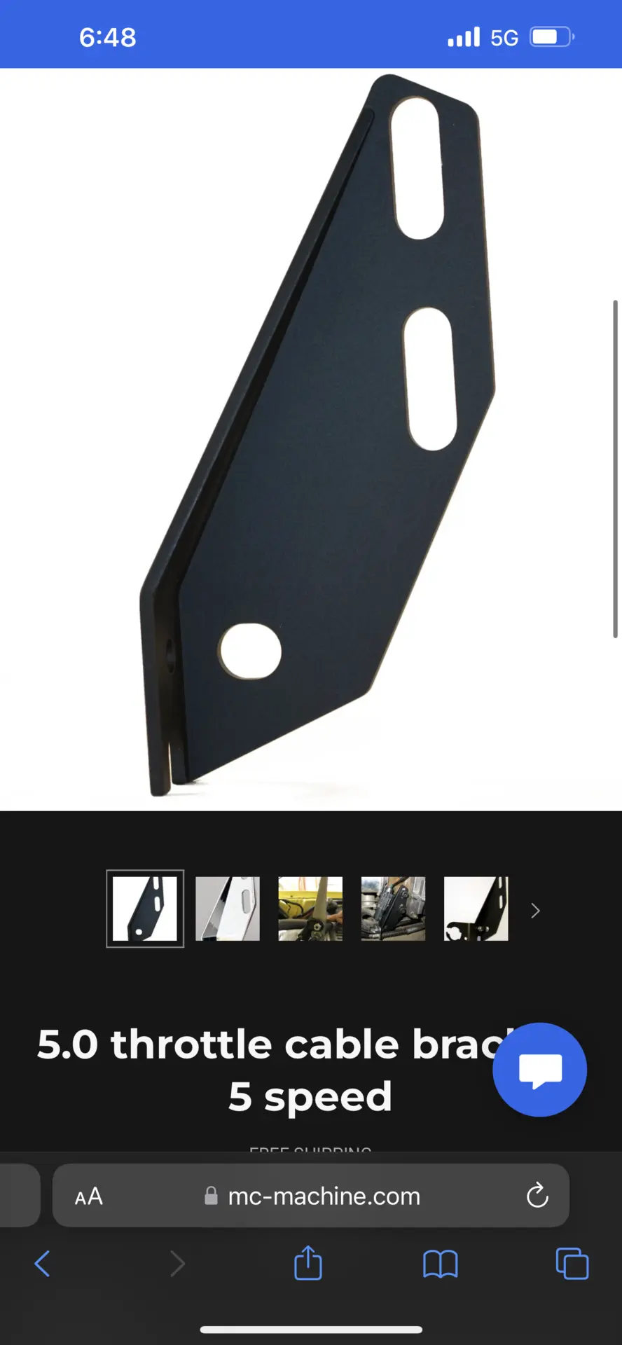

I wonder if one of those throttle brackets from MC machine would work?
One of these would do the trick

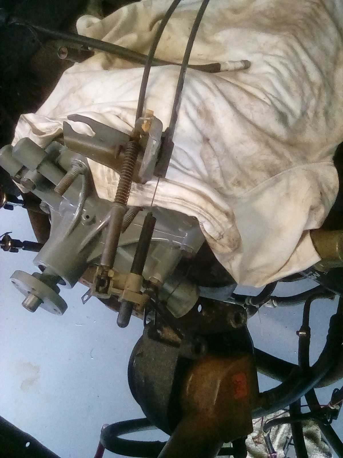

Does anyone have a pic of how the cruise cable is suppose to attach to throttle?
The part on the right side in the pic is what i cut off to clear the covers.
That’s where the kickdown bolts up for the AOD .
