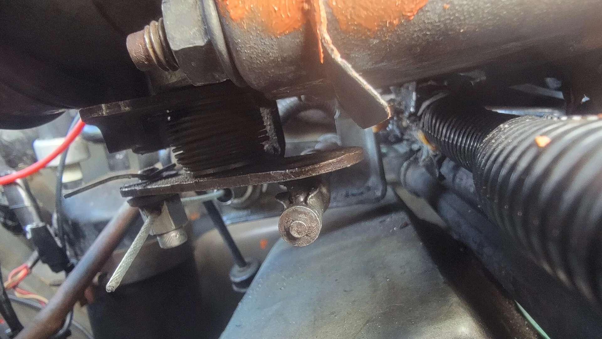

I disconnected mine and just put the cable on the ball I'll send a pic if it's ok to do
