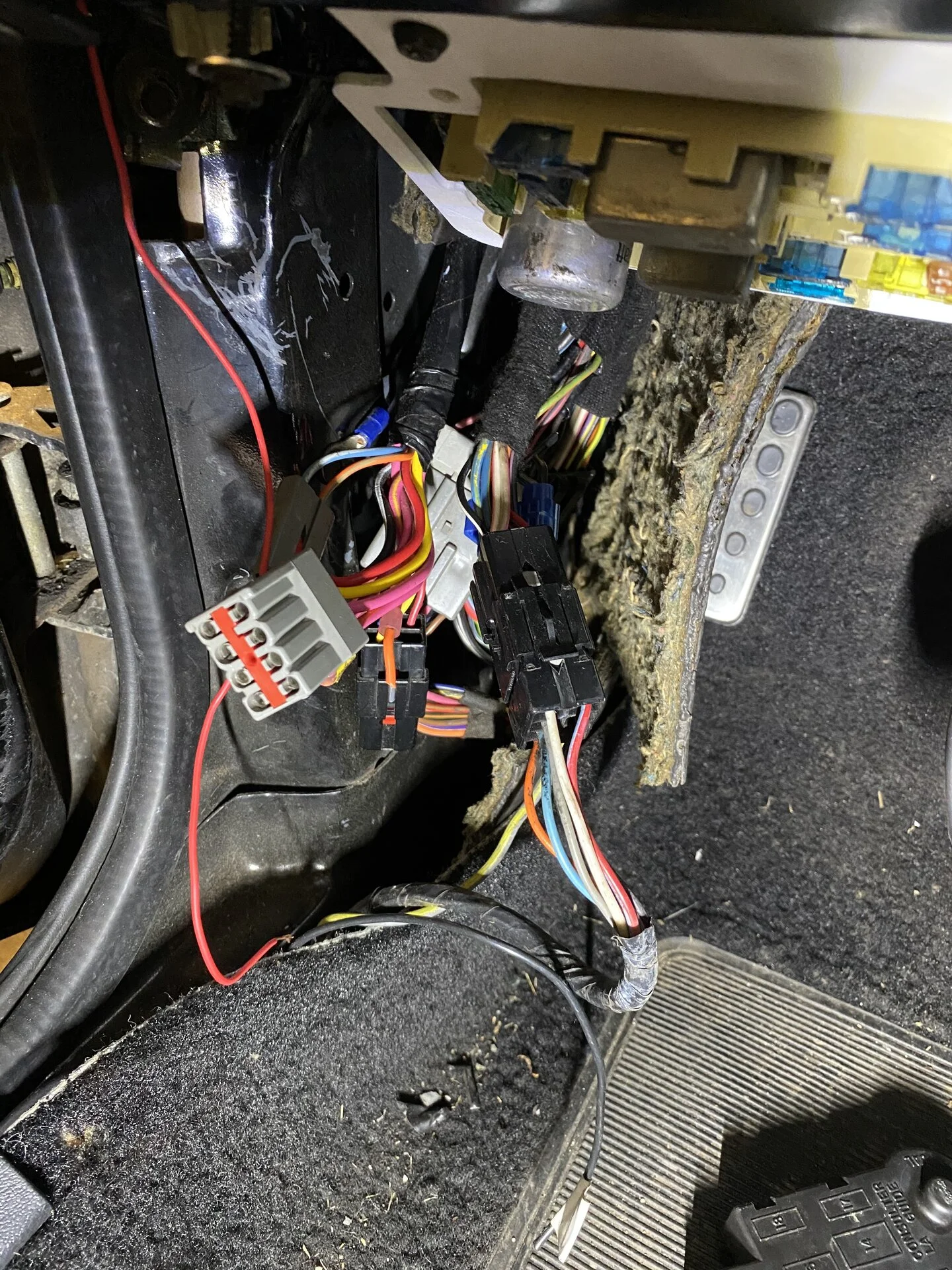

SInce that first test signals a failed VSS, I would back-up that test by probing a different location. I would test in the transmission harness that comes in from under the car. The harness runs under the driver's seat, and over to the driver's kick panel. Inside, you'll find a black 8-pin connector that should have the same wire colors in it. You can test at this location.

SInce that first test signals a failed VSS, I would back-up that test by probing a different location. I would test in the transmission harness that comes in from under the car. The harness runs under the driver's seat, and over to the driver's kick panel. Inside, you'll find a gray 8-pin connector that should have the same wire colors in it. You can test at this location.

is that trans harness under the drivers seat?
It runs under the seat but the plug is in the lock panel.
I got the color wrong. Black 8-pin connector. I found a pic of mine. Black connector coming up from the carpet
this plug is the last plug before you are at the sensor connection itself

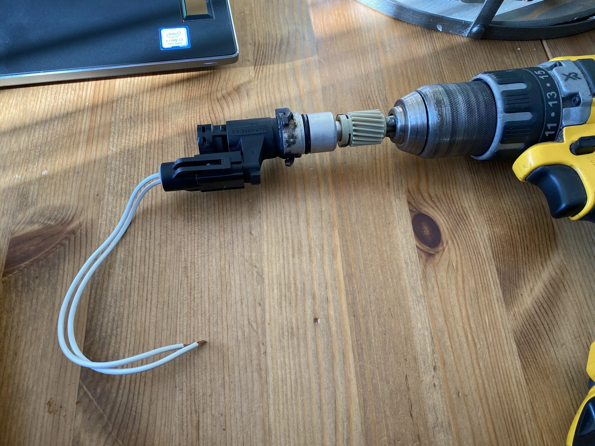

I had a spare VSS so I tried this out. Plugged in a harness end and set my DMM to 20v ac. I was able to spin up to 10 volts

I’ve got power back to the crimp on the wire pulled out of the connector that goes to the amp now. So it seems I just need to find a way to keep the crimps from pulling out of the connector. I’ll try to get that fixed and I’ll update if this fixes the cruise.
