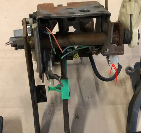

Clutch switch is here. Should be closed continuity with the clutch pedal out and open when you push it in
