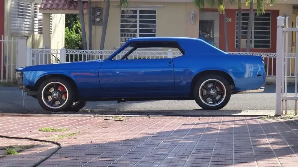

I wont bore you guys with a long story, so im keeping it the shortest I can.
In 1995 my dad bought me a 1969 Mustang Grande. My plan was to paint it with some money I had back then but the engine broke a couple of month of driving it. A friend of my brother fixed the 302 V8 engine.
What I remember from back then:
  • 302 Block was bore .40
  • He put a 1969 or 1970 Mach1 351w Cylinder heads
  • Edelbrock Torker II Intake
  • Holley 650 double pumper
  • Forged pistons (I think 9.5 compression)
  • He ported the exhaust of the heads and made bigger some oil holes in the engine block.
  • Comp Cams Roller rockers 1.6
  • Duration 280, Lift 512 Magnum Competition Cam (almost sure this is correct)
  • Hydraulic Flat Tappet Lifters
This engine was only used for a small 15 minutes trip and was removed from the car. 17 years later we are finishing the car and start up the engine. It works great BUT the cam its too aggressive for what we are looking for right know.
What I recently added:
  • Shorty Headers
  • Aluminum Radiator with electric fan
  • C4 Saturday Night Special Converter (which is too low for the cam)
  • Flowmaster American Thunder 2.5" dual exhaust
  • Steeroids Rack
  • 13" Baer Brakes on all 4 corners
  • 9" Rear posi 4.11 (not sure about the ratio)
  • Fiberglass Hood
  • Classic Auto Air A/C Kit
  • Wheels 17 x 8 Front, 17 x 9.5 Back
Question:
What Competition Cam (or other) you guys recommend?????
You can see the motor in idle here:
First off, I love the color (amost painted mine a similar blue) and the big brakes look really sweet, those are on my list to get eventually, but my car stops now and thats good enough, not like we have a track anywhere NEAR me to even get to use them on anyway. About the cam...with the specs you gave for the engine, I cant imagine that cam being too aggressive. It may have a little too much lift, and you can probably fix that with some 1.6 rockers instead of 1.7's. Ditch that single plane intake if you are going to enjoy it on the street...i had a torker II on my camaro and it was great at the track, but on the street it left my bottom end (cruising RPM's) a little sluggish. I would try to verify that camshaft somehow and the rockers are an easy swap if you want to just try it and can find some cheap somewhere, but I'm sure you will get lots of other good advice off of this thread.
Reactions: tdmach1
Robzz thanks for the advice and the compliments.:nice: I have read a lot about the Torker II intake, most of it bad, Im replacing it for sure in the future, but right now im focusing in finishing the car.
