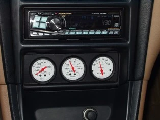

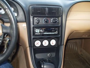

Here's what I did on my old '98, and I know '99 and '00's are the same...I had 3 2-1/16 Autometer Phantom gauges(mechanical water temp, mechanical vacuum, and volt meter). I used a mudflap for the gauge holder. I know now someone makes a gauge holder for this area, I'm just notsure who. Let me know if you want more pics.
Oh yeah, you can tap into the dash lighting and dim the gauges the same as the rest of the dash. I don't really have anymore hints, but if I think of something, I'll let you know. Also, I had a volt meter, it is really pointless. All it does is show 12v w/ ignition on and 14v with car running. If I were you, do electric water temp and oil pressure gauge.

bingo...this is what I was looking for.
how exactly did you mount the faceplate with the gauges into the cluster?
