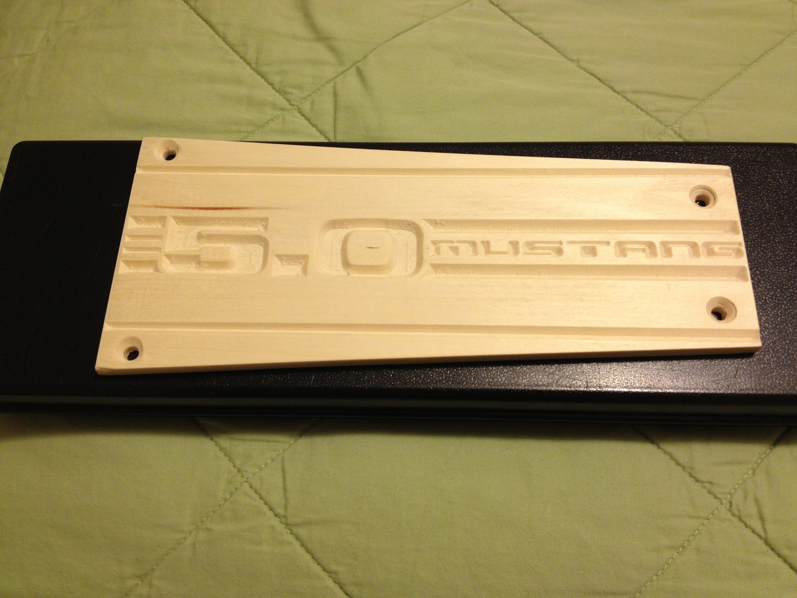

cdurbin
5 Year Member
Jul 27, 2012
563
109
64
North Charleston, SC
Dec 29, 2012
#16
  • Dec 29, 2012
  • #16
First prototype milled out of wood today. Fits perfect.
Will be moving on the the real deal in the next week or so.
Looking for ideas for other custom Fox parts as well.
Thanks
Reactions: Vaz88GT and 84Ttop
Coast2CoaStang
Aug 11, 2008
254
Dec 29, 2012
#17
  • Dec 29, 2012
  • #17
That looks awesome. If you made one with LX font where the 5.0 is, I would buy two, lol. I think you are onto something. Make a couple of styles and they'll sell.
