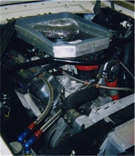

In the last few pages of mags like Car Craft, there is a company that has been selling dual snorkel housings that go over your open element air cleaner. Ad has been going for years. The housings come in all shapes and sizes, they accept different tubing depending on what you order. I have seen pics of the set-up on several Fords, the one that sticks out is a T-Bolt clone... worked very well. Not as flashy as what folks were doing at the time by snorkeling oval air cleaners, but did the same thing.
Dave
This one?
http://www.ramairbox.com/
