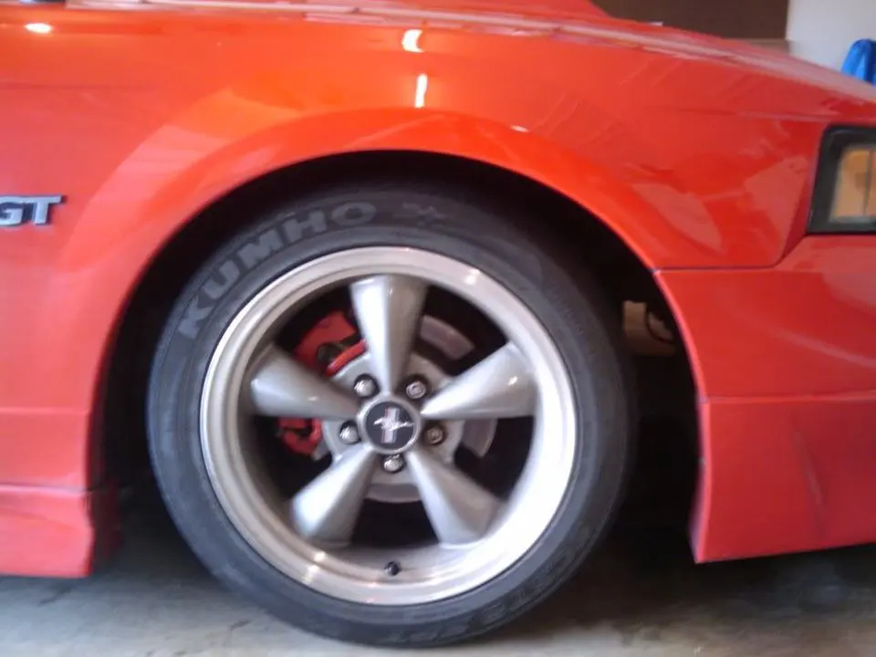

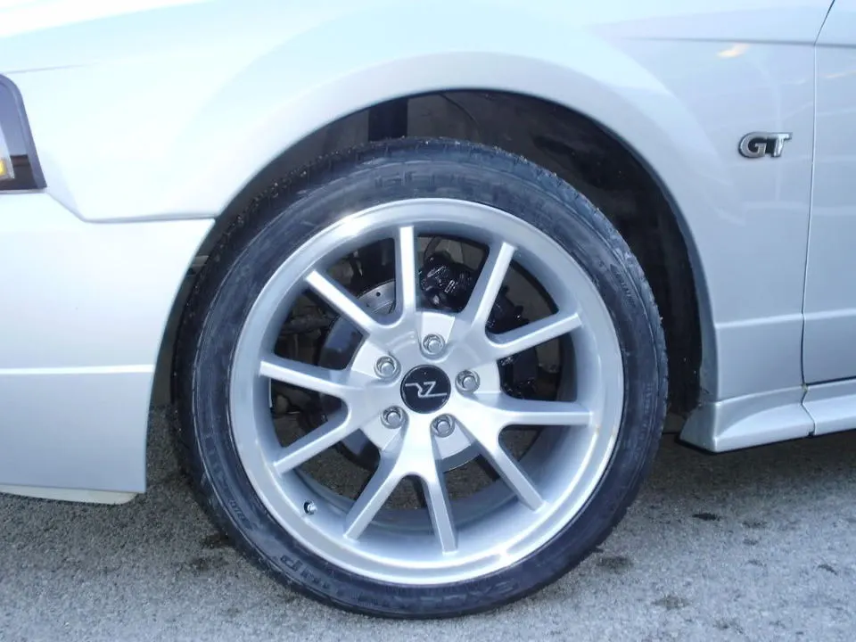

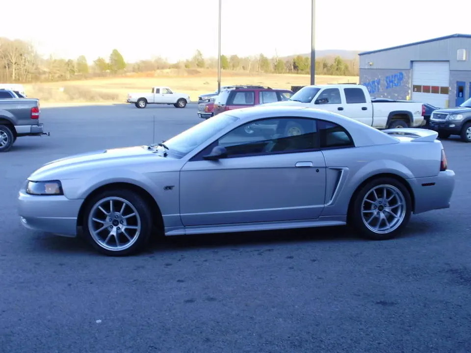

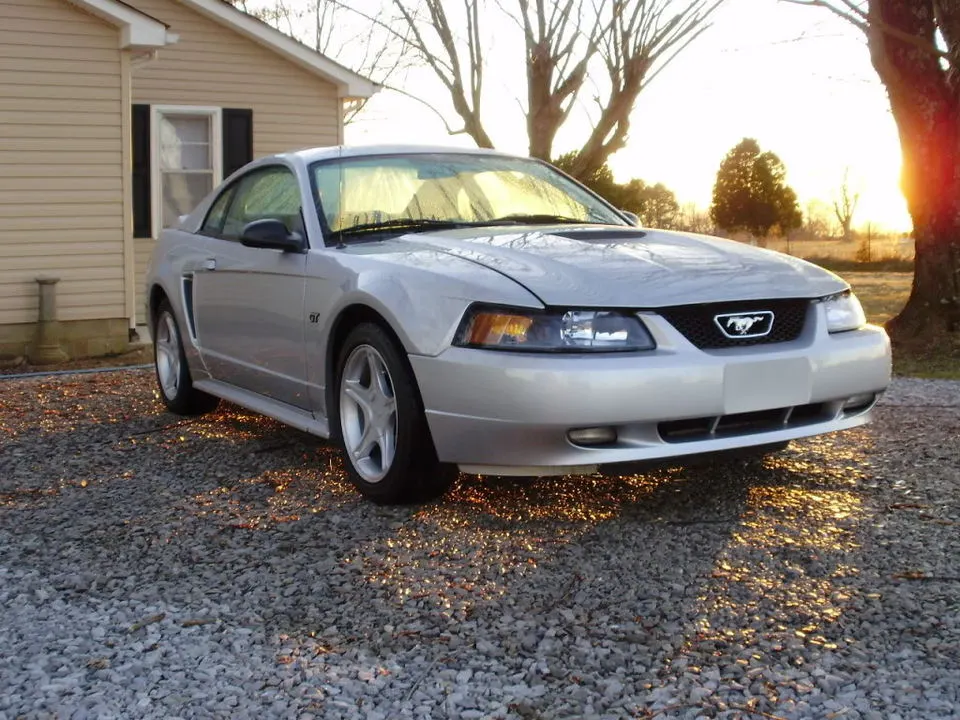

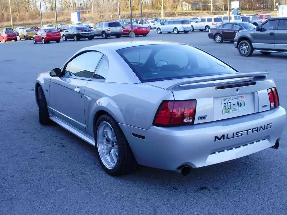

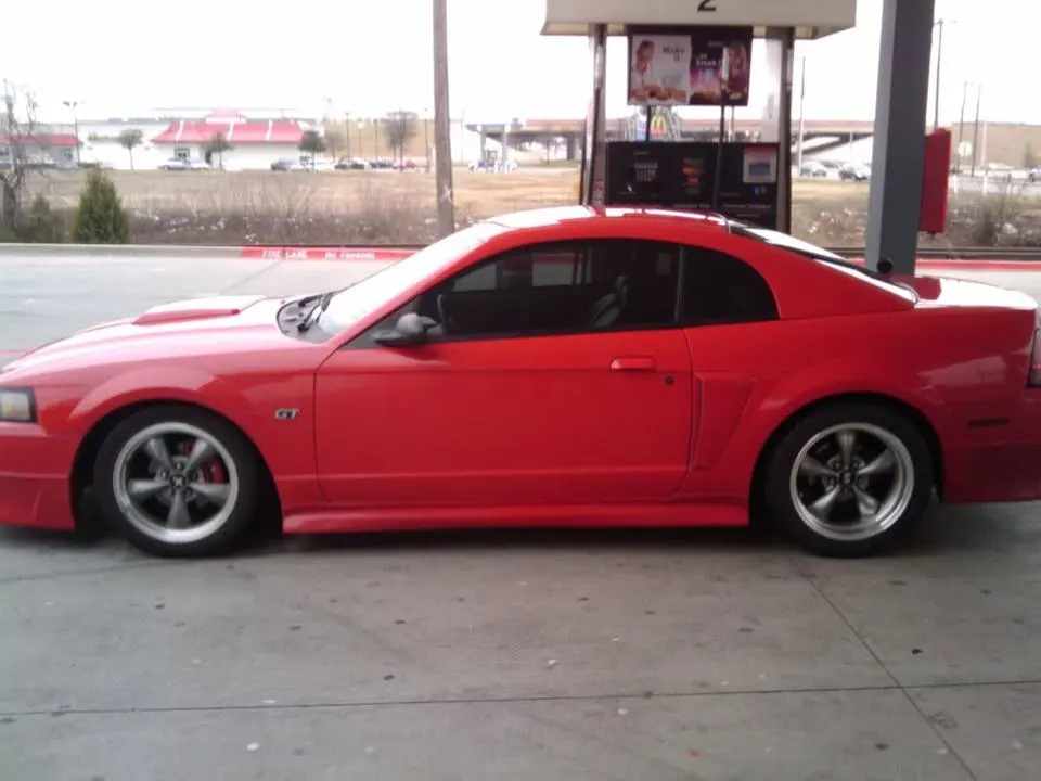

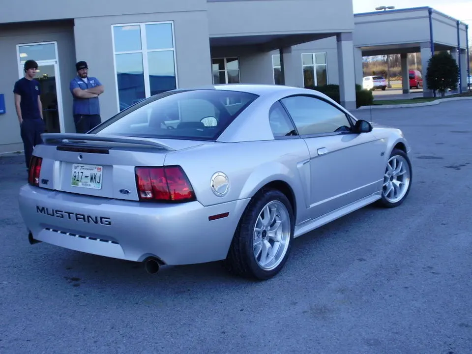

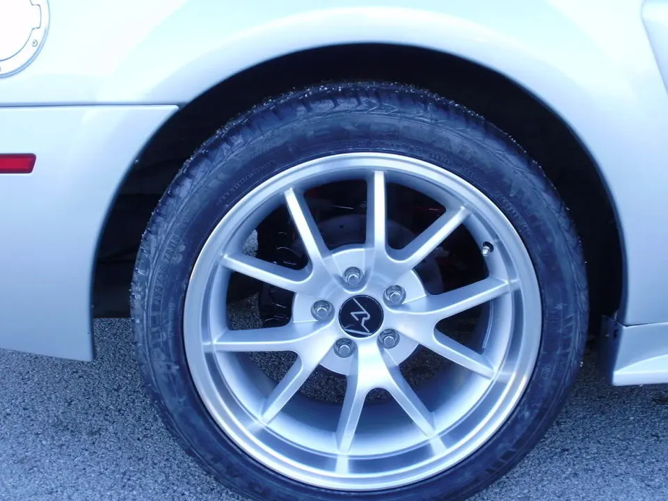

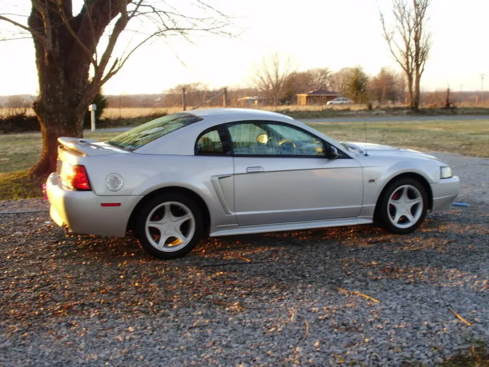

all the pics below are with the sportlines. car didnt look near as 'gappy' in the front with stock wheels/tires (245/45/17). with the new wheels/tires (265/35/18 fronts), i wouldnt think the tire size is the thing to blame....is it?
cut the current eibach sportlines (front only) or swap them in for the H&R SS springs ($235 shipped is cheapest i can find) ? i just dont think deleting the isolators will give the desired drop.

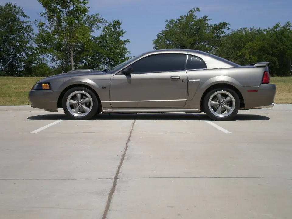

Sounds like your pass side isn't all the way in the pocket of the a arm. I have sportlines with iso in my car. I don't think if I pulled mine out it would sit that low. The only time it did was when I had trimmed eibach drag springs.

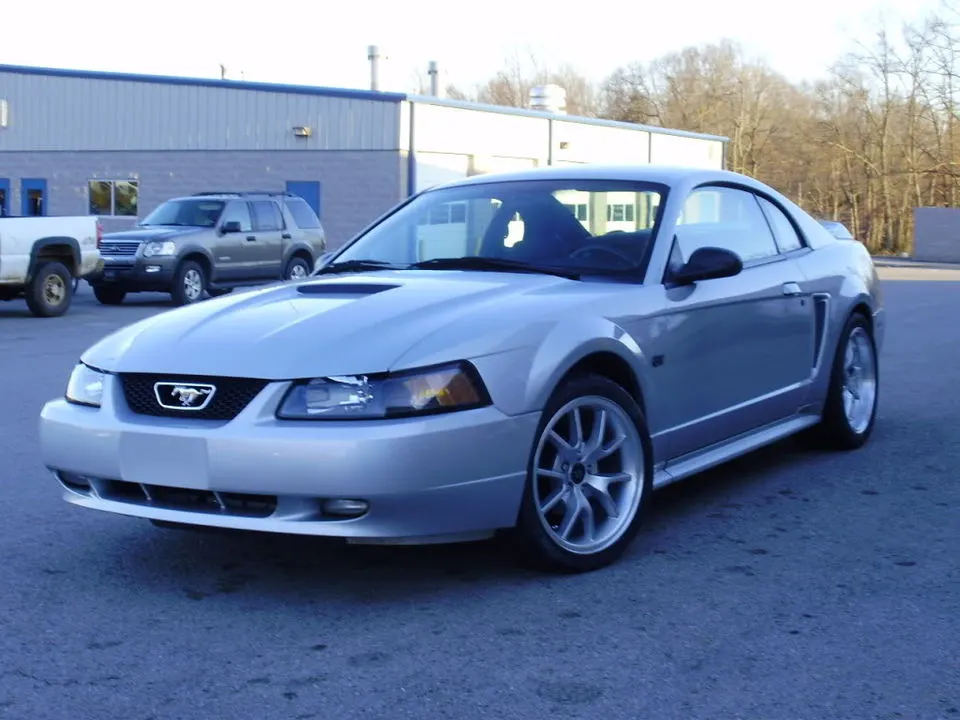

Here is my car with sportlines, isos, and non cut.
nah i have rechecked it, at first i was like WTF! lol but now i just kinda got use to the way it sits, i think its my car because i kinda had a hard time getting the shock to go though the cc plate on the driver side when the passanger side just went right through easily
Damn, If I new that I woulda not installed the isos when I installed my sportlines this morning! LOL!
There's always NEXT weekend ;) Looks good man!
