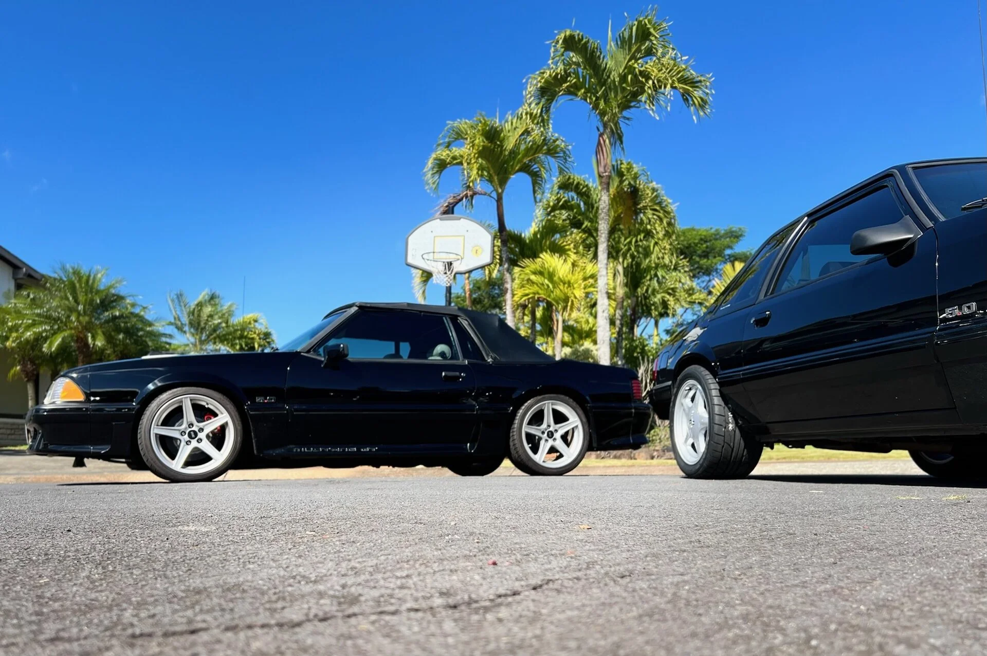

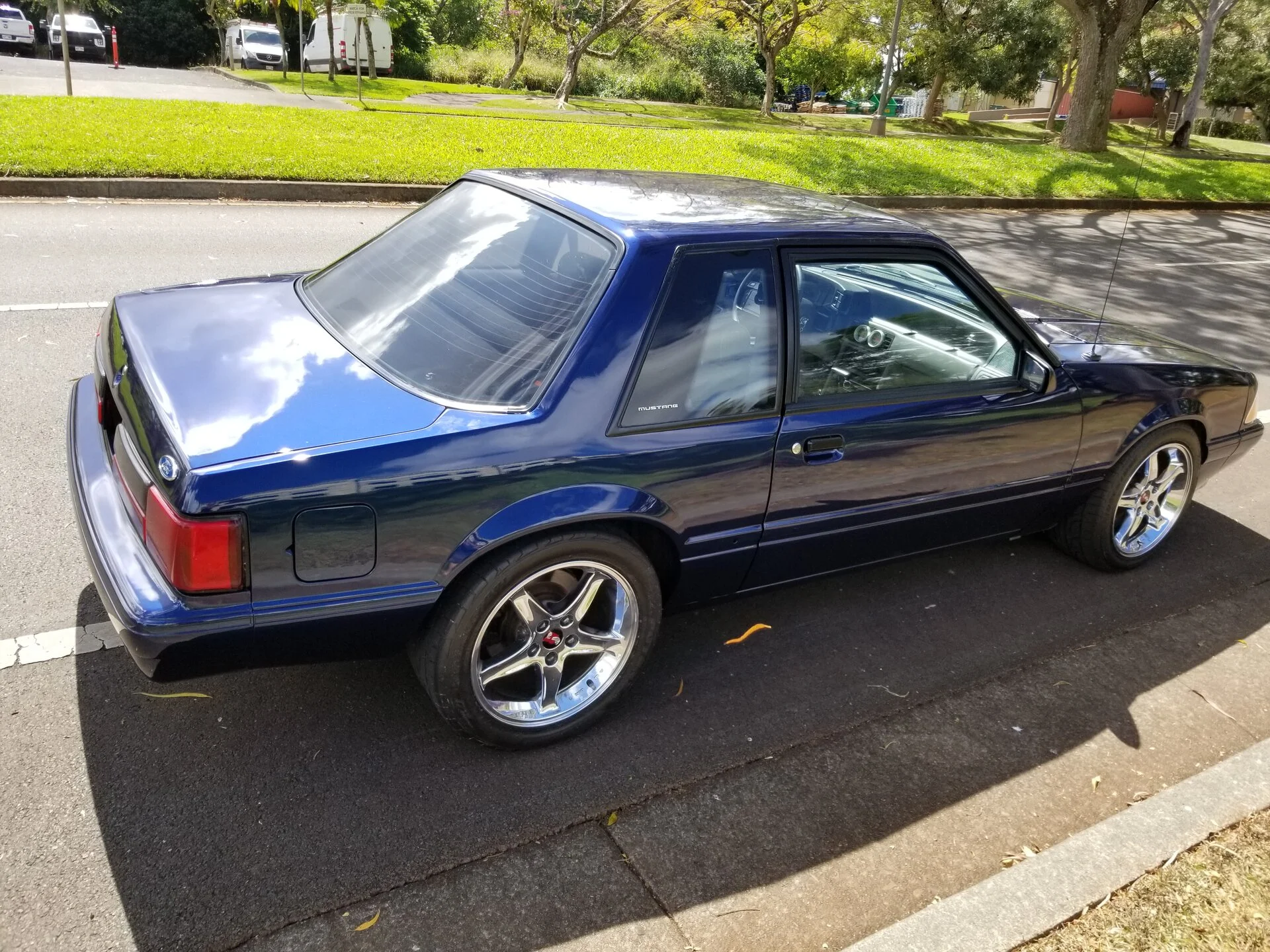

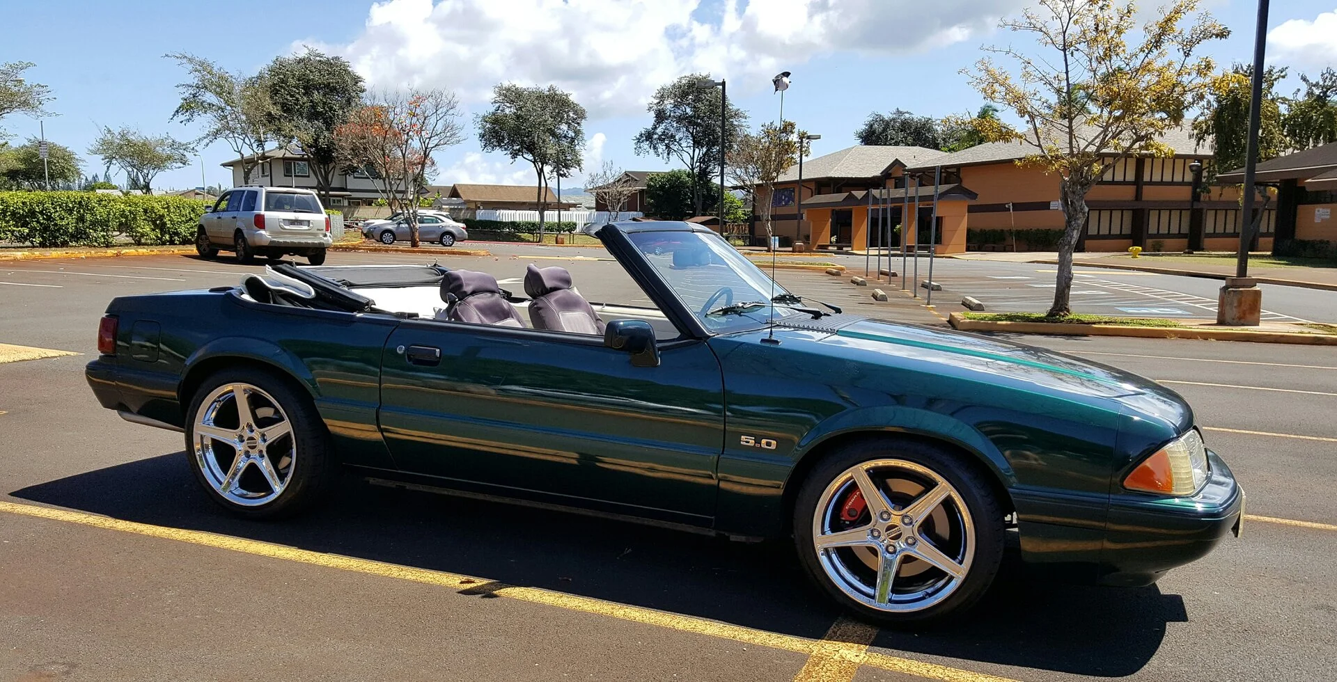

My coupe runs the same size tires you are asking about and it doesn't rub. My two convertibles run the same size tires but in 18" and again, no rub. I do not have rolled fenders on any of them and the two verts have eibach pro kit springs. The coupe is on coilovers.

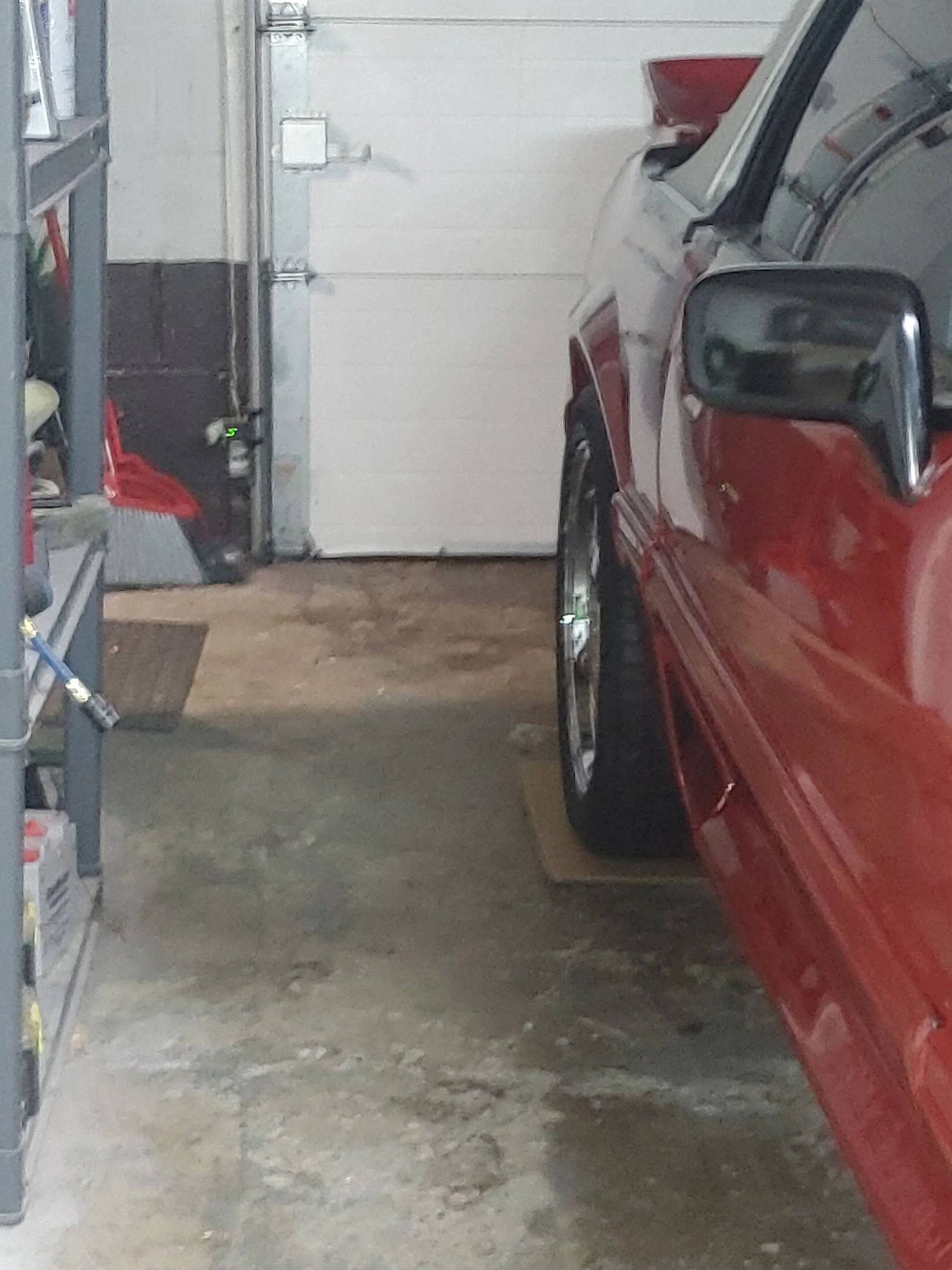

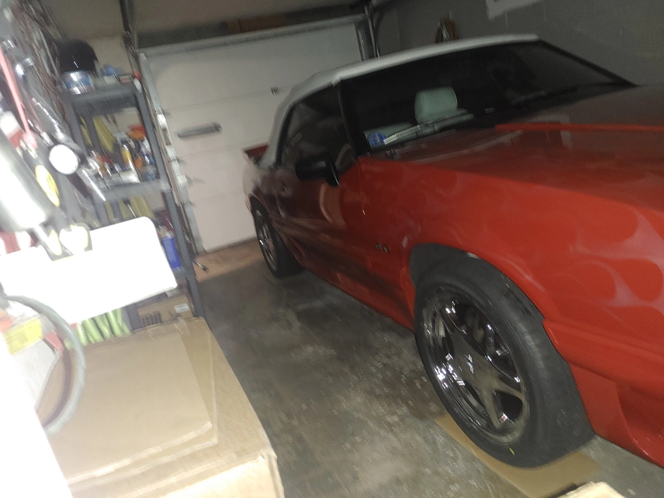

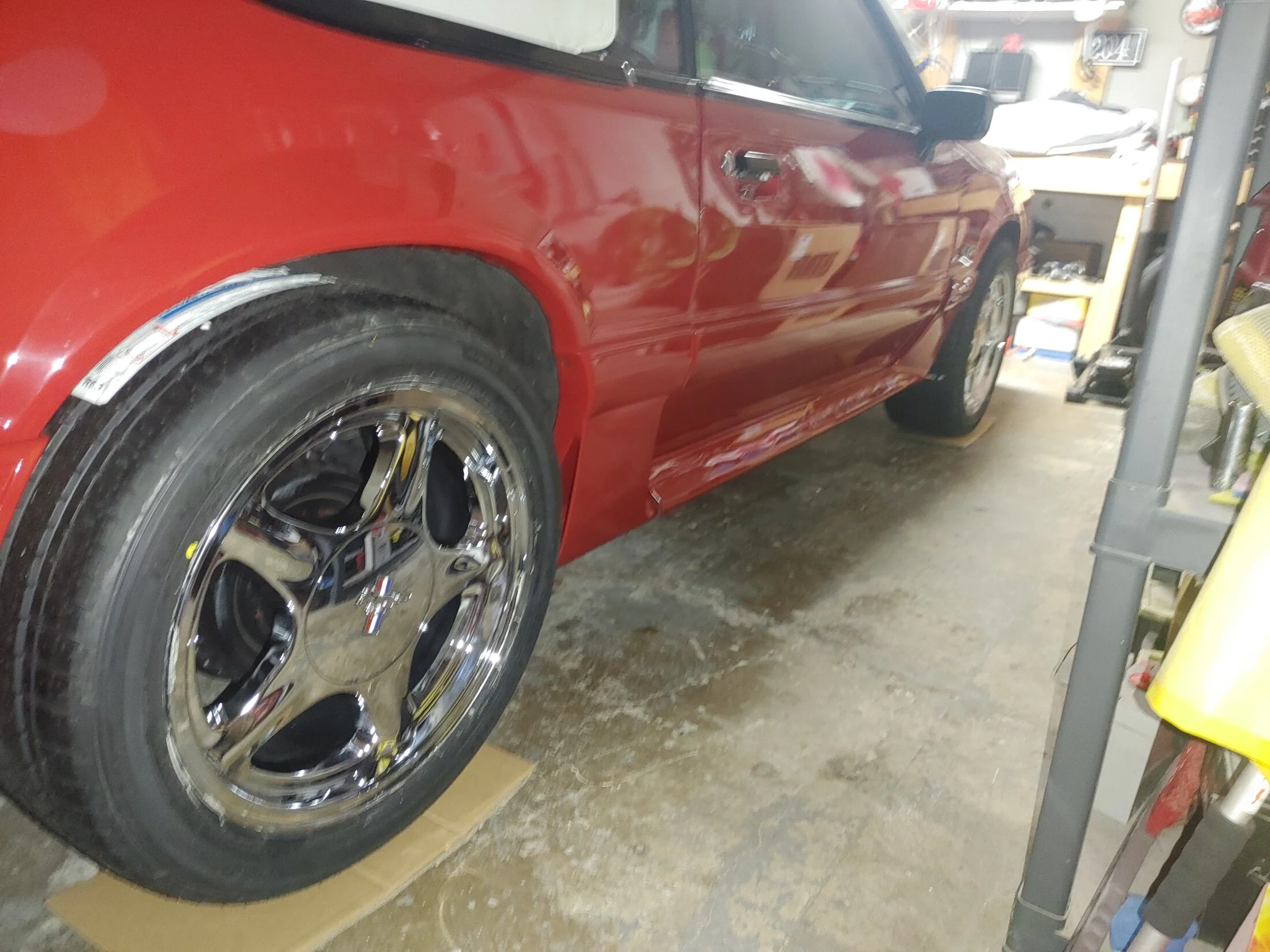

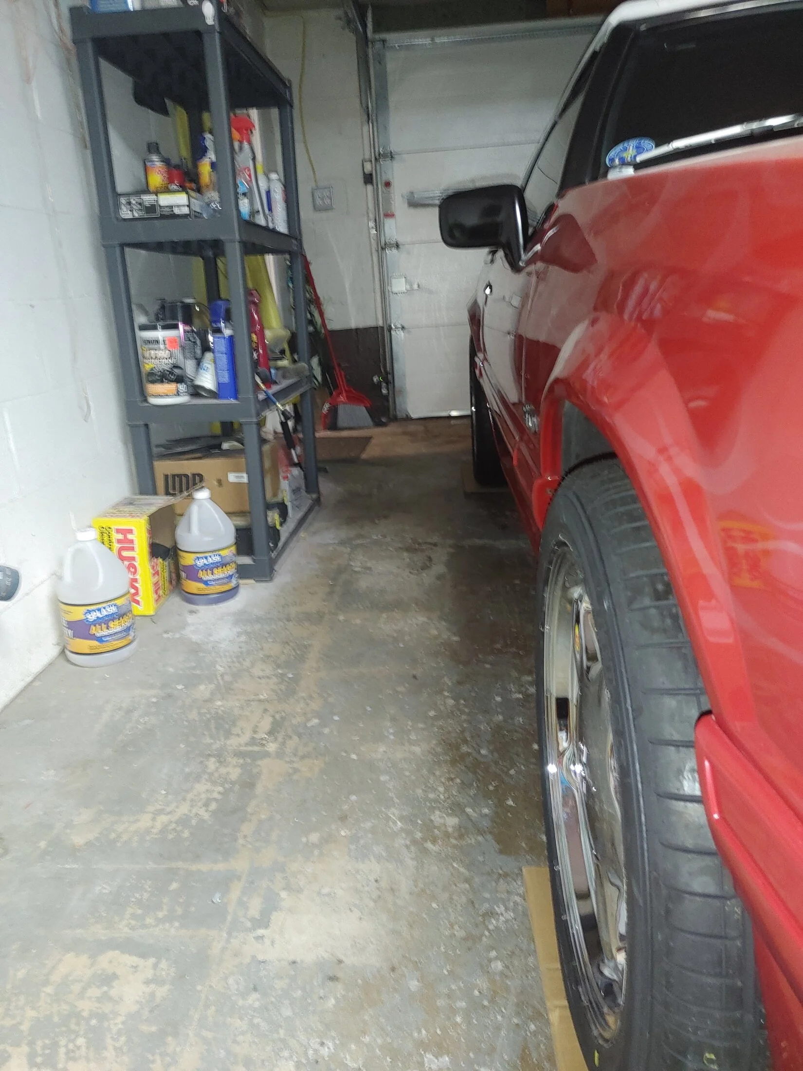

I just ordered theb17/8 and 17x9 chrome ponybwith same tire size u have and just installed. Flipped quad shock rear fit fine front really rubbing inner fender liners trying to find a solution so if u know of any any info much appreciated. All stock suspension and everything. Needs lowered for stance im looking for bit will that help or maybe different front tire like I thinkbi read somewhere 225/44/17 I think not sure if that was exact size u read about. Any info would be helpful
