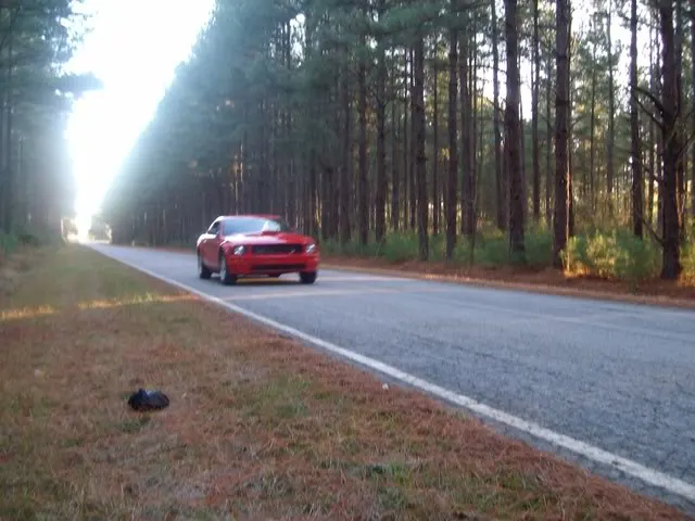

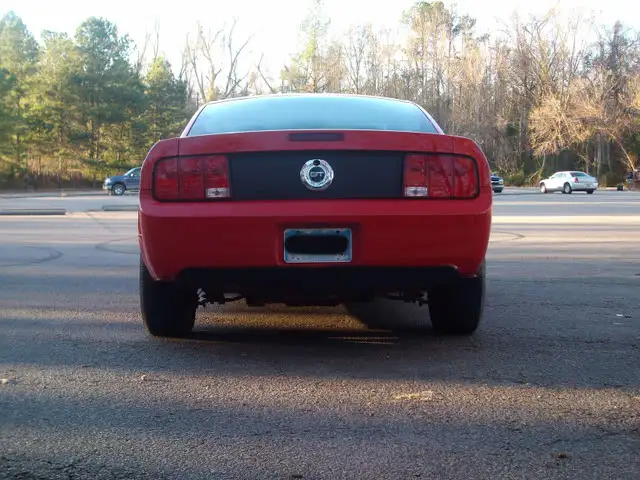

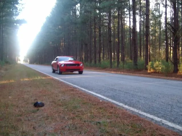

Rough little photochop of what I was wanting to do. Anyone had any success cutting this plastic. Don't really know what I should use to attempt this. :shrug:Sawzall, cutting wheel, metal sheers
Couple more pics of the car

I've never cut painted pieces, but when I did my custom chin spoiler i had to cut some pieces (ABS plastic I believe) and used a sawzall for it. It took a steady hand and it still didn't come out as nice as I wanted but it would be hidden. I think you'd be hard pressed to find something that made a clean cut and was easy to use.

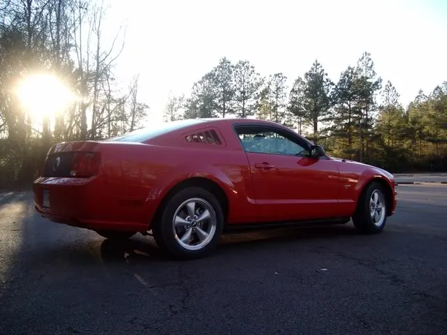

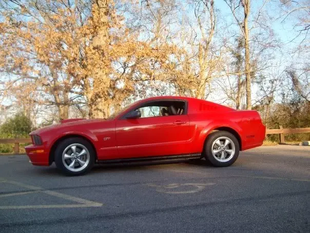

PS its no sideskirts/rocker not the black ones and IDK why my louvers didn't show up in this pic

It's pretty thick and you'll probably end up melting areas of it more than cutting. I even used a dremel and it melted some of the plastic with the cutting wheels. A very fine tooth handsaw might take forever but it may make the cleanest cut. Just tape the lines where you want to cut.

My experience: when I replaced my front bumper cover, I cut up the old one with a jigsaw in order to toss it (actually, I made handgun targets, but I digress). I couldn't believe how easily/ smoothly it cut. Biggest challenge would be to secure it to reduce vibration- a helper would be handy.
A Sawzall would be overkill. I think a jigsaw and maybe a die grinder & tin snips for touch-up would be all you need.
If I were doing it, I would use masking tape over & and about 3" on each side of my cut line. I would leave about 1/8" extra outside my cut line so I could finish it with a sanding block (this stuff is very easy to sand).

a small air saw or jig saw would be best. use the smallest blades you can, and be sure to tape the bumper, so the paint does not chip near the cut. as mentioned, you will need to find a new method to attach the bottom of the bumper to the car.
with that said, i offer an alternative. why not just paint the section instead of cut it? same look, cheaper and less hassle.
