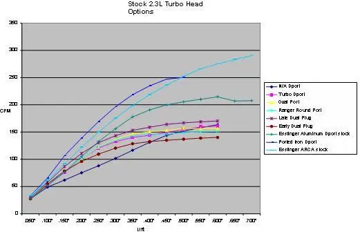

D port head VS Round port head
If you're looking at the light blue line that goes way up the scale, that's not the line for the Ranger round port head, that's the line for the Esslnger ARCA head (which is a $1000+ aluminum race head). The ranger round port is fairly lackluster and is outflowed by the stock Turbo D port. I'd say stick with a D port and get it ported.
Actually I am trying to compare the round port from a turbo tbird with a Dport head (not sure where the Dport came from).
The graph does show that the round port tbird head to flow better than the Dport in stock form.
Do both of these heads accept porting the same way?
Thanks for the help
jason
How do you get from that graph that the round port is shown as flowing better? In every part of that graph it flows the same, or worse as valve lift increases.
Morever, the only vehicle round port heads came on stock was the Ranger with the 2.0L (which was a debored 2.3). There is no round port thunderbird head.
I knew I should have cleaned that graph up before posting it.
I attached a better one, showing just the stock heads and a ported Dport.

I had a funny feeling you might be looking at the exhaust ports...
When people refer to a head as a round port, D-port, oval port, whatever, they are referring to the intake ports. To my knowledge ALL 2.3 heads had round exhaust ports, so they are distinguished by the intake ports.
So, odds are your Thunderbird has a turbo D-port on it.

What shape are the combustion chambers on that D-port you have? If they're heart shaped, you won't want to use it for a turbo build as it will bring up the compression too much (plus as you can see on the graph, those d-ports flowed like crap). You may want to go back and get the head off that Thunderbird after all. Never hurts to have a couple extras.
